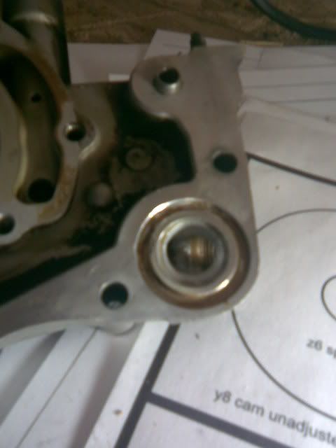

Shimming the oil pump
First off, i allways inspect the oil pump before i do any modifications If the oil pump is bad, its not worth doing all that work to find that out in the end. Sorry for the crappy pics guys.
So first you take off the Philips headed bolts that hold down the rotor cover.Im using my impact driver to remove them, its the BEST! 35 dollars ive ever spent.
After that you measure the rotors per honda spec. this one was on the tighter side of spec and everything looked good.
Next you remove the hex head bolt on top of the oil pump next to the pickup tube inlet. this is where the pressure bleed off valve is when the pressure gets to a certain point, this piston lifts and limits the ammount of pressure that is produced. Be carefull when removing this, the spring is quite strong.

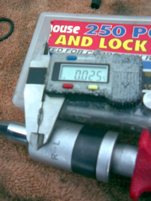

Next you want to get your shim, with an ID of .30 and OD that matches the diameter of the piston (i didnt measure sorry). I found a washer that the OD was correct, but the ID was too small, and the thickness was .048. The thickness of the shim you are looking for is to be between .025 - .035 thousanths, that will give you an oil pressure of about 80-100 psi at 7000 rpm's (this is even more important on turbo and high rpm engines).
I got the washer out of a harbor freight multi pack thats under 5 dollars its under the caliper in the picture.
Next i bored out the ID of the washer with my die grinder. Then since its so small i couldnt use a grinder and hold it, because then it wouldnt be flat. So i took the end of one of my screwdrivers that im going to return to sears and ground the washer down on my concrete floor. Slowly it took metal off until i got down to my desired thickness. (As seen in the second picture, the differences between the way they come and the finished product).
Before you reinstall make sure the shim sits flat and level on the bolt, then clean the piston and the passage out, then coat everything in engine oil. (If your going to be porting as well, leave this out for now, it will need to be cleaned).
And thats it!

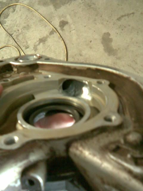

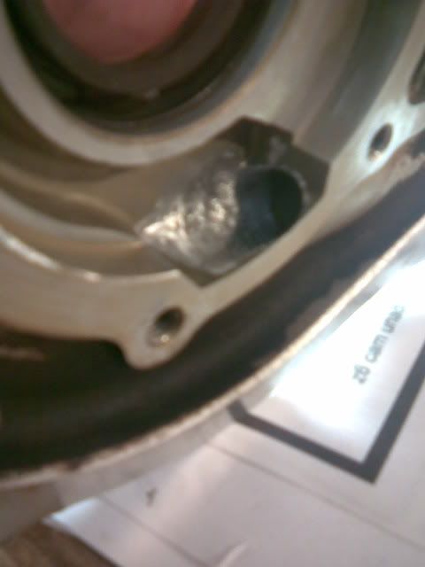

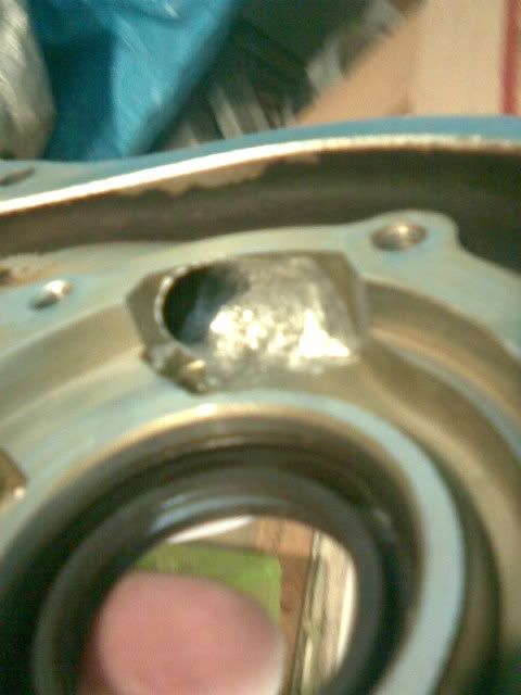

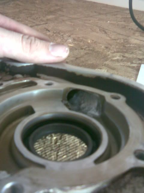

Oilpump porting
If you allready shimmed the oil pump, then your ready to port it, take the rotors out and set them aside. Next take the hex plug out on the bottom of the pump.
Now to port i used a carbide bit that was 25$ at tacoma screw, i also bought some cheap ass HF ones but this takes the cake on durability. Be carefull though, if you have never ported before with a carbide bit, it can easily take huge chunks out of alluminum. here is the bit i used.
Next you will want to enlarge the opening on the output passage, you can go larger but i found this to be perfect for what im looking for.
Then i enlarged the pickup passage a little bit, since the pickup tube itself isnt nearly as large as the gasket, i didnt see any reason to enlarge it that far.
And finally the inside port, this one is tricky and you have to be carefull you dont want to knick any of the surfaces that the rotors ride on. I took a fair amount out of here I found that if you lubricate where your grinding it doesnt jump as much and helps the bit last longer.
Thats it on the porting, be sure to clean everything very very well! I used a degreaser cleaned the inside and passages out, then washed it with water twice, and then blew it out with compressed air to make sure that no shavings were left behind. After that, reinstall the rotors with oil on the top and bottoms of them to lubricate them. put the cover back on, and install the pressure valve and the hex bolt on the bottom. And your done! congrats you just ported and shimmed your oil pump.

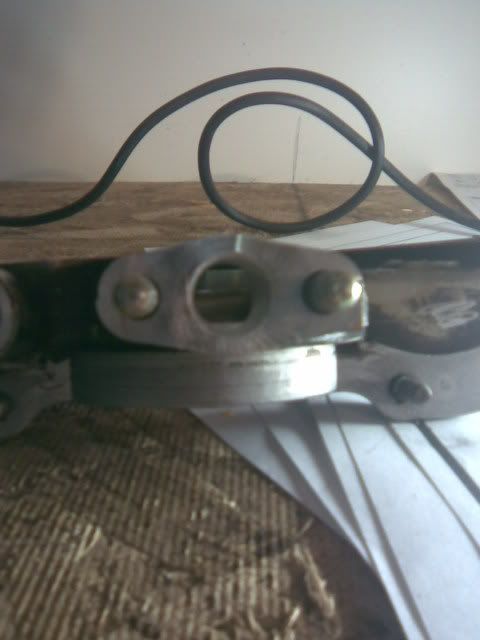

Front seal replacement
I replaced the front seal while i was doing this so i thought i minds well show you how to do that too, I drove the old seal out with a screwdriver and a hammer. To install it i put the new seal in level as far as i can into the hole, and then put your 32mm axel nut socket over the seal, (It fits perfectly) then i drove it down evenly with a rubber mallet. Easy as that.

Hmm, how could I say this as politely as possible, and with all respect to the OP.
Sorry, but I almost neg-repped you.. There's many reasons for this;
-This topic has already covered multiple times, and not at all worst at Endyn's site.
-Oil pressure is high enough at stock. Additional pressure only increases parasitic losses and strain to components. Increase the flow volume for better lubrication!
-You keep talking about enlarging. That's completely wrong point. You don't want big ports, you want ports flowing smoothly with big radiuses. Yes, additional volume on some places is helpful, but we'd like to have such of passages at close to constant diameter/area, and changes should happen with smooth, shallow tapers
-Shapes of ported ports are wrong.. I see lots of abrupt changes in shapes.

Well since i know this oil pump is going to be going on a turbocharged engine, i shimmed the oil pump. (Because you loose oil pressure with the turbo) So where as it may usually be 80 or 90 at 7000 rpm's it will now be 70 or 80 at 7000 rpm's (assuming that 10psi is the ammount of drop).
Taking rushi's words into consideration i went back over the oil pump, i borrowed my step fathers dremel wich is far superior over the die grinder. I used a very very small high speed steel bit it worked very well especially in the tight corners and spaces.
I also bought a roll of emery cloth from Harbor Freight.
I proceeded to go over all of the ports again, smoothed them out and made them the same diameter through and through. The pickup line passage wasnt that bad, but i did alot of smoothing on it and cleaned up the begging of it a little bit so there were no sharp edges.
I then cleaned up the output passage as well, this one had a huge chunk on the side that i took out and smoothed everything up with.
And then i smoothed out the final output passageway, it didnt look all that bad other than the diameter being a little off and wasnt smooth enough.
I went over every port with that 120 grit emery cloth. it really cleaned everything up tell me what you guys think, ill keep it open in case you guys have any more suggestions.
#18 ·

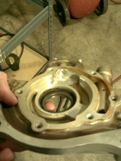

Looks better :TU: I'd only add some more radius into the output passages' lower side at the pump/gear chamber. Then get some Devcon (it's so easy and cheap for you guys in the states..) and fix the outlet turn radius.
Or if you want to be extreme, block the outlet passage, install big AN fitting into the place of hex plug, use big external oil filter and route the oil remotely with big enough hoses and very gentle bends. That way you could eliminate a few sharp 90-degree turns 8)
#25 ·
Well i went ahead and used that epoxy, before i used it though i washed the area down with a degreaser first, and then a mix of acetone and the epoxy mix with a hard bristled brush. I then mixed up a batch thuroughly and put into the hole. Here is the outcome of the entire pump.
That epoxy is great stuff and i would recommend it again :TU: and for under three dollars!? its a fucking steal.

#27 ·
The turn radius of the outlet passage was very sudden and sharp. So i bought that 2 part metal epoxy that is made for alluminum and metal. I washed the passage out with acetone very well (and since i had recently ported that area, only bare fresh aluminum was exposed). I then bathed the plug in acetone and wiped it off then installed it, Then i mixed up a batch of epoxy and threw it in there. Its really strong stuff and i couldnt pick it off with a screwdriver so im going to guess that oil pressure alone couldnt do that.
#28 ·
high pressure hot oil. underline it lol. if that bond isn't 100% perfect it WILL get underneath it. that's the bitch about high pressure hot oil haha it will get it's way into the damnest places.
