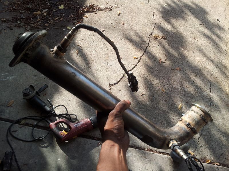

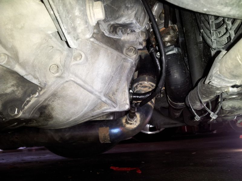

I just install my o2 and aem wideband but i dont know if i put them to close to the turbo, i still getting a code for 02 at idle and the afr is really lean idle like 16 and crousing at 2.5k 18+ i dont know if i intalled too close to the turbo, also i have my pressure gauge and BOV hooked to the fuel pressure regulator( will that be a problem)
Also i am running open dowmpipe all the way to the end of the oil pan, were the stock piping use to join will this cause lean reading..?

Man that pipe is really messed up.
99% of lean readings in such situations are caused by air leaks.
1. Make sure you dont have any air leaks in your system.
2. I see no reason why you cant mount the wb sensor there.
3. Any half decent wide band will monitor sensor temp. And if the controler is not able to drop heat or the sensor is getting too hot or too much pressure then it should throw an error code. On my unit the display starts blinking. On the tech edge unit. The display says wide band PID error.
How good is that gasket between the turbo and the flange ?
as long as the sensor is at least 12 inches away from the end of your exhaust, you will get an accurate reading.
i cant see the pictures due to security settings at work, although why dont you just extend your exhaust a bit and put the sensor right past your oil pan? thats where i have mine, as well as many others.
