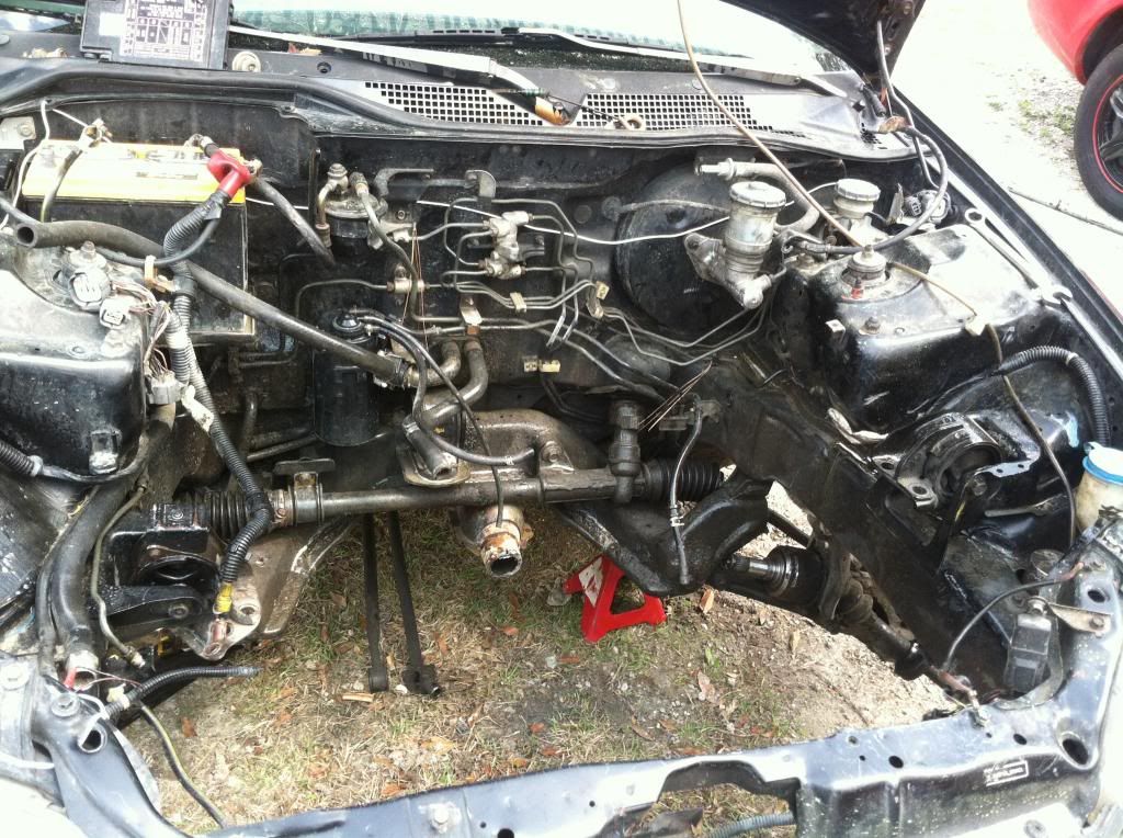

OK.......
SO I got the motor swapped into the car in about 6 hours. Ran into a few headaches but all fixable. HAd to use the driver side motor mount from the B7 and put in on to the Z6 motor to make it work. also I dont have the $$ to buy billet mounts, so I did to the next best thing and got the energy suspension silicone bushings from Autozone that go on the 2 lower mounts and the main mount.
the bad:
Idle is ROUGH I have a strong feeling that its one of the 3 sensors on the top of the intake manifold. I will be checking that out soon via autozone unless anyone has a suggestion?
THe guy who had the car before me Welded the exhaust to the CAT so I took out my grinder and cut the bitch off. (we had to pull the motor from underneath the car since I dont have a hoist. also how we put the new one in)
SO RIght now it is straight headers coming off the motor lol. I have a newer Exhaust manifold but since it was welded/cut Im gonna have to cut the flange off my new one and use a piece of pipe and some clamps to secure it. also need to get the O2 off...
I think thats everything.....pics will be up soon.

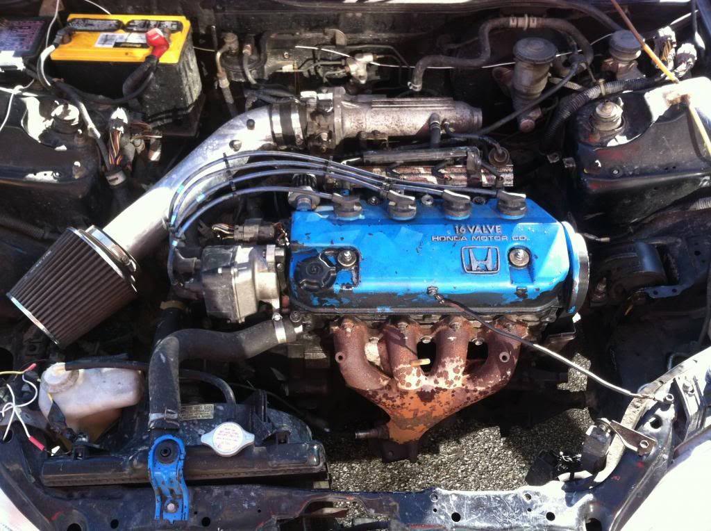

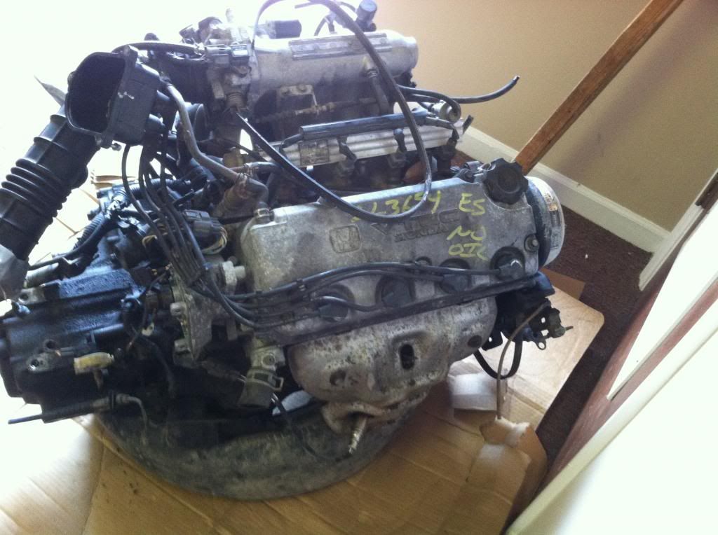

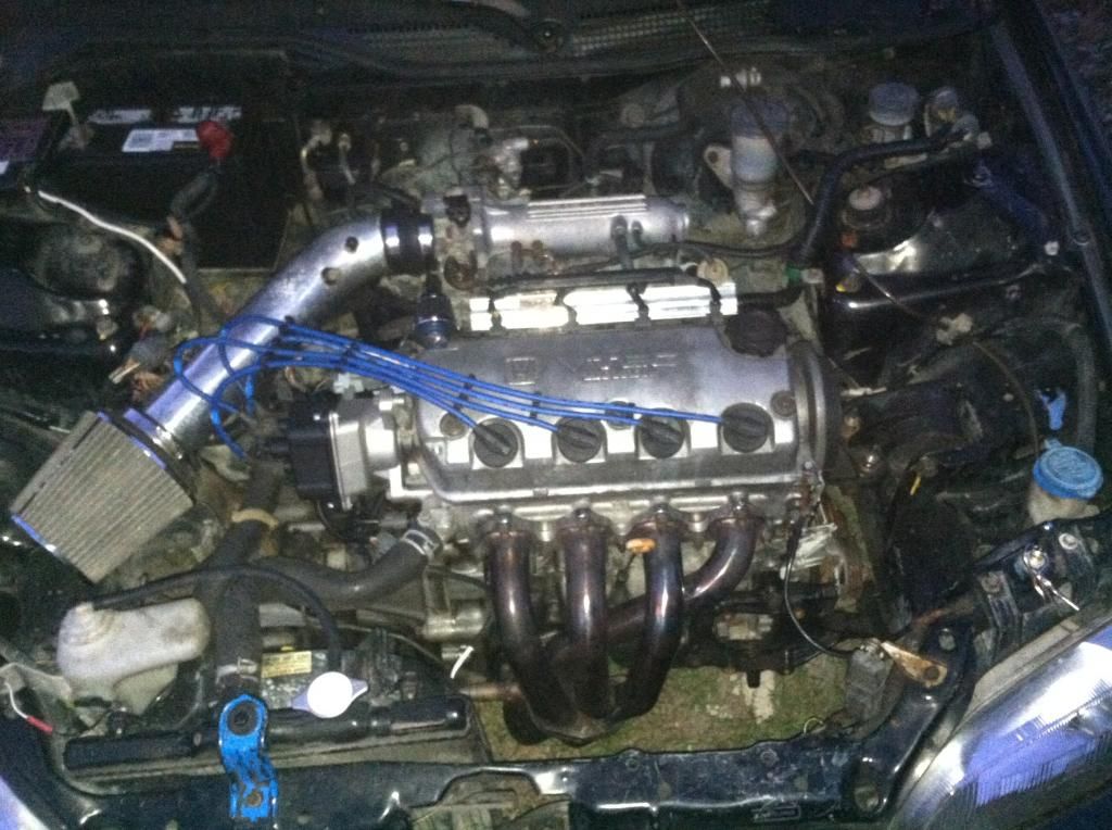

VTEC Just kicked in Yo! I got everything wired up and done....and then the ignition system took a shit and it wouldnt crank. After MANY hours of self diagnosis and 2 NEW distributers I have it running good. Still think my TPS needs replacing but it runs fine. I just get a high then low idle when its in nuetral, but if i rev it the idle evens out. Anyways here are few pics from my swap
Thanks again Xile6! really appreciate all the help!
This is what It came with
This is what I bought for $300+ an 1/8 of chronic
You can see where I had to cut the CAT b/c it was welded on. My buddy has a shot of test pipe and Im gonna cut the cat off and stick the shot of pipe on there.

and THIS is my final product!
Once again thank you everyone for sharing your knowledge with me!
