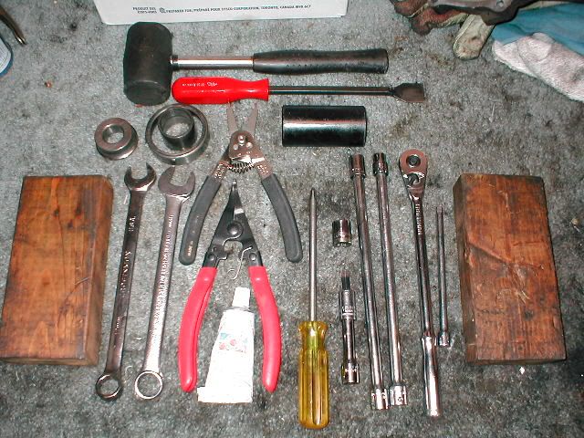

Required:
(Sorry if I haven't mentioned tool/bolt/socket sizes as I don't remember them exactly!)
Tools
- A good set of sockets from 9mm upto 32mm
- 3/8 or 1/2inch (recomended) drive ratchets
- Socket extensions to get into those hard to reach places
- 1/2inch Breaker bar
- Hex key for interlock guide bolt
- Flat and phillips head scredrivers
- Torque wrench
- Trolley jack
- Axel stands
Other
- Around 2.5 to 3L of Manual Tranmission Fluid (MTF)
- High temp CV joint grease
- Hondabond or equivalent sealant to seal up the transmission housing
- Input Shaft Bearing (duh!)
- Rubber oil seal under the ISB
- Any other bearings that might need to be changed (check them now cause you don't wanna do this again!)

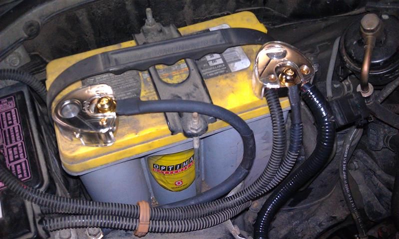

1. First we need to jack up the car and support it with axle stands. Then take both rims off and disconnect the negative terminal from the battery.
