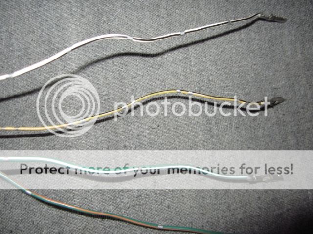

Have a 2000 Honda Civic EX Coupe, 4 of the wires coming from the hazard switch got pulled out of the connector that goes into the fuse box area. Does anyone have a picture or diagram to show which connector they are suppose to be in?
White/Black Stripe, Yellow/Black Stripe, Green/White Stripe, Green/Orange Stripe
These are the 4 wires coming from the Hazard Warning Switch, going to the fuse box.

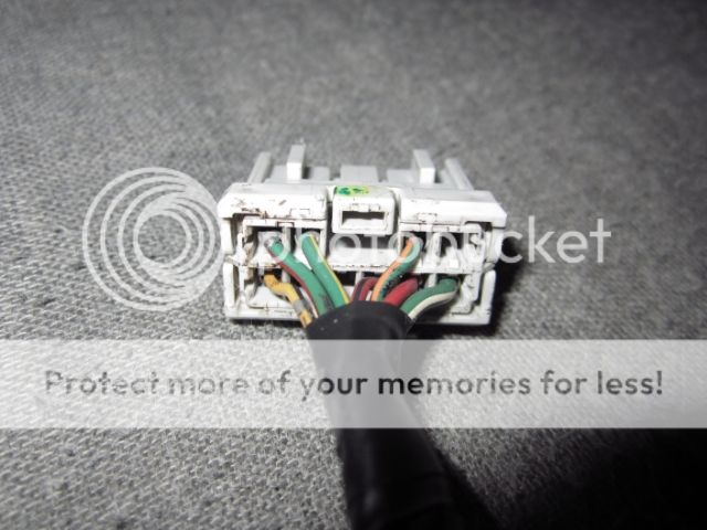

This is the hazard warning switch plug (connector) coming from the center of the dash.

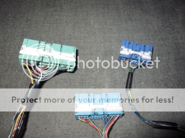

Which of these 3 connectors do the wires from hazard switch plug into and in what order?
#2 ·
Is anyone able to take a picture of the connector that these 4 wires go into for me? It has to be one of those 3 connectors that I took a picture of, they are located @ the fuse box. I'll be able to figure out what order from just looking that the picture, thanks a ton! Can't drive until I've gotten this issue resolved (turn signals won't function). Entire cluster harness is laying on my floor until I've gotten these repined into the correct connector.

From the hazard switch plug to fuse box plugs
Black/white goes to the light blue plug, bottom row 5th from left.
Yellow/black goes to the green plug,bottom row 2nd from left.
Green/white goes to the green plug,top row 5th from left
Green/orange goes to green plug,top row 7th from left.
The last pic is the hazard switch plug. Hope this helps.

All looks good man. Test to make sure it works.
