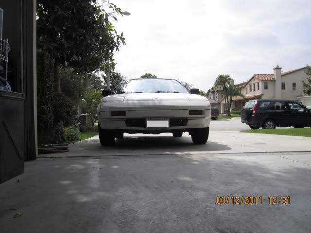

Well lunchbox is gone and traded for this, one pic up for now as a teaser ;)

awesome its the only mr2 i appreciate the aw11 chassis.
