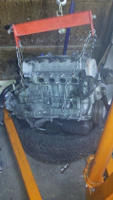

And so it begins...
Title says most of it. I'm fairly new to turning wrenches, and this is my first major project. Goal is 300whp, in what is presently a 1996 Del Sol s.
Got the engine out today, but started later than I wanted, so instead of taking of the tranny and putting it on the stand, I just set it down for the night.
Now that I'm actual making progress, I figured I'd post here instead of continuing the thread in the turbo section
Let me know your thoughts! I'll continue to post updates here as things develop.
