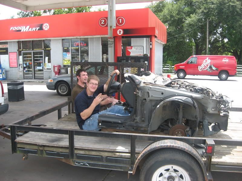

ok this is my del so li converted to RHD yah i now its not too detailed but im just gonna post pics..

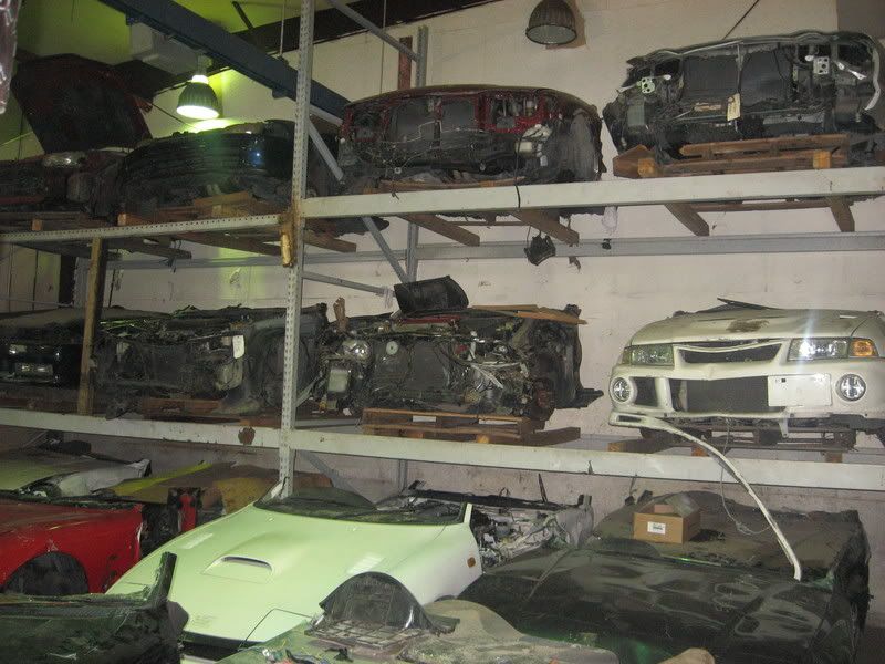

got the car cheap with no motor and got the front clip for cheap as hell 1200 from my supplier in houston
heres my clip
other clips :)
