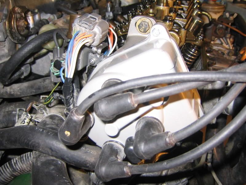

First, we want to remove plug wires out of spark plugs, but not out of the distributor cap!!

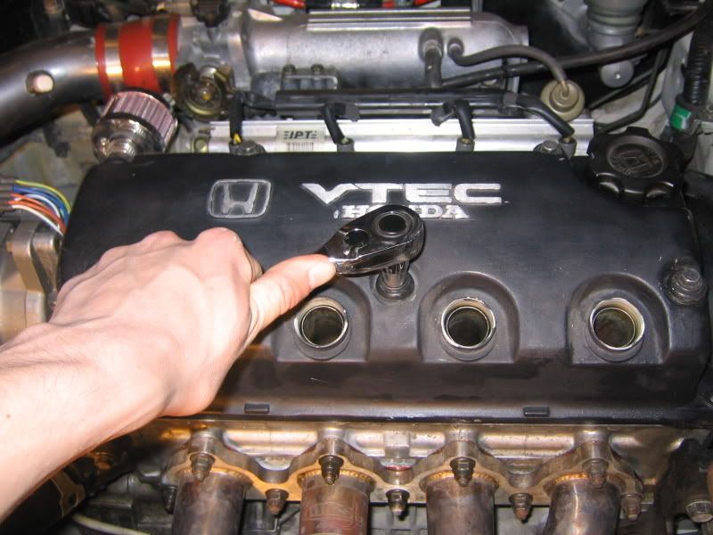

Next, we want to remove the valve cover. It consists of 5 10mm bolts that are easily removed. Remove the bolts and remove the valve cover. I like to take the gasket with it and that will be explained later when you reinstall it.

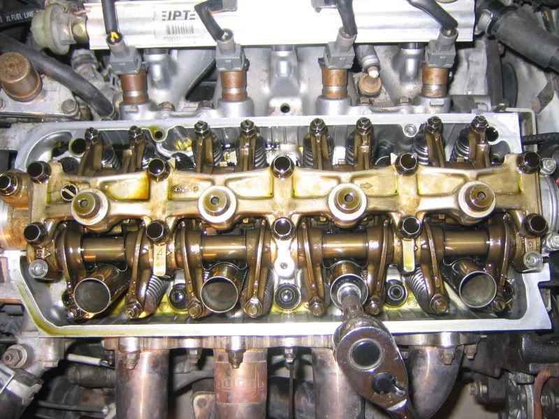

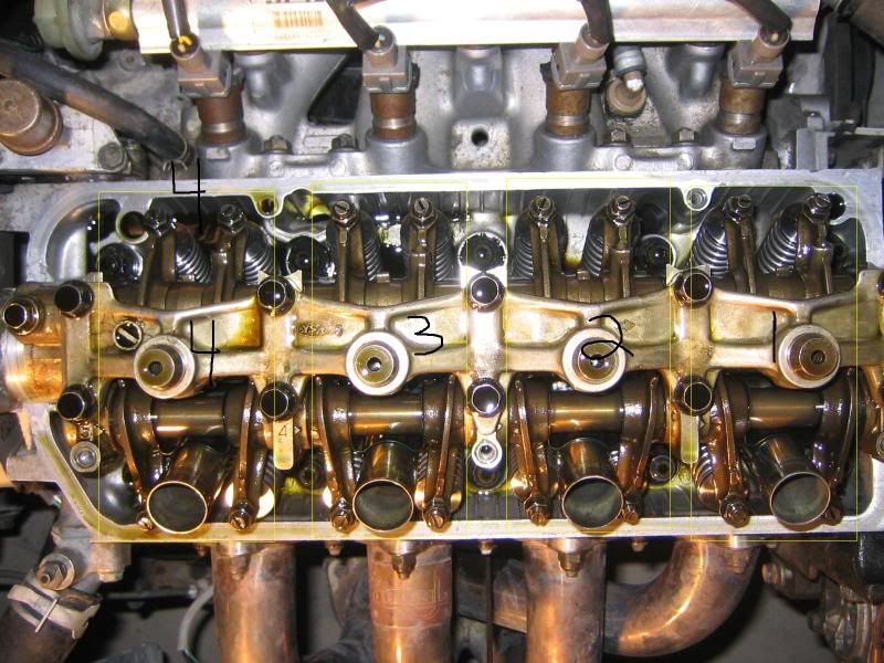

Alright, now that the valve cover is removed, here is your working environment. Don’t get intimidated, it’s not hard at all. The cylinders are labeled and numbered for your reference. On this particular motor (d16z6), there are 16 valves total. Most d series are like this, which means you will adjust 4 valves on each cylinder. 2 intake and 2 exhaust.

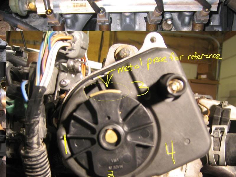

Now remove the distributor cap (do not remove plug wires from the cap). This is done by removing the three phillips screws.
Once removed, you will see the rotor, which is pictured here. The metal piece on the arc of the rotor is going to be our reference. The piece is about ¾” long, so just use the middle of it. What I did was mark each cylinders plug wire so I could easily verify which cylinder I was on.

Once you are 100% sure that the cylinder is at TDC of the compression stroke, it is time to adjust the lash for that cylinder. Here is want you want to look for…this is the correct place to check for clearances. Sorry for the crappy drawing………but you get the picture, hopefully
Where to check spec at with feeler gauge:
For the intake side, you want to use .007”-.009” For the exhaust side, you want to use .009”-.011” Note how there is a range of clearances that can be used. This is a good thing because you can have a little bit of error on your adjustments. I recommend using .007” for the intake valves and .009” for the exhaust.

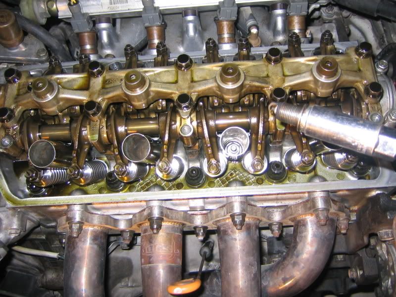

Once complete with cylinder # 2, then you finished. You must reinstall the vlave cover and valve cover gasket. I like to wipe the head and the gasket down so it gets a good seal.
wiping down head where gasket will be placed.
