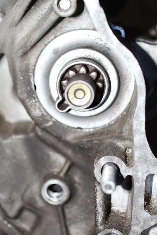

This is the left over bits of my D-series starter on left over bit of an old D-series S40 box. Same box currently in my car.

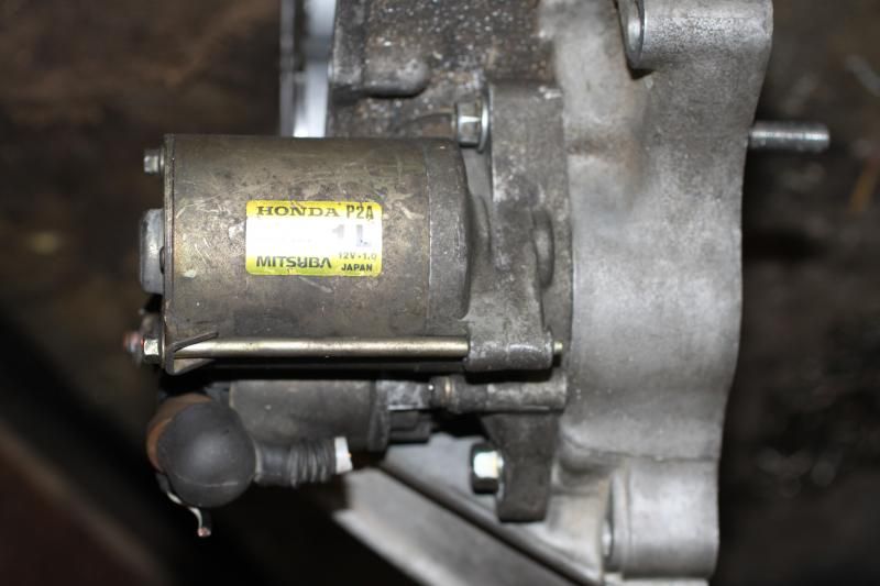

Here is the D-series starter mounted in the box fly wheel side.

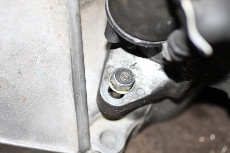

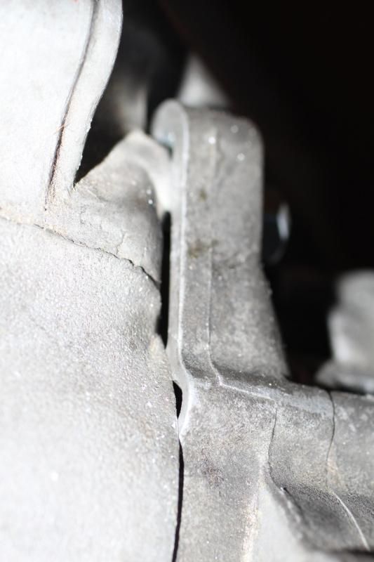

For comparison here is the B-series one in the D-series box (No bolts)
Shave this bolt a touch with a file. Don't go mad.

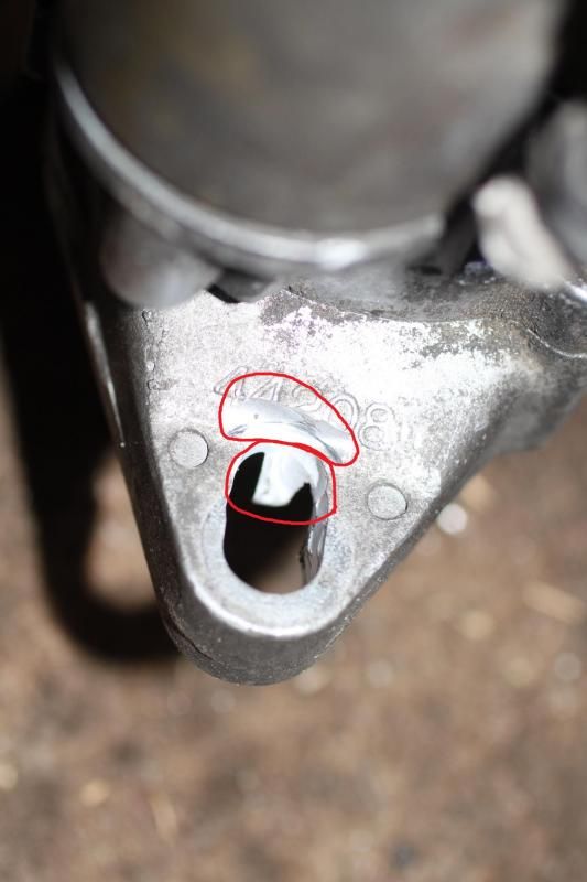

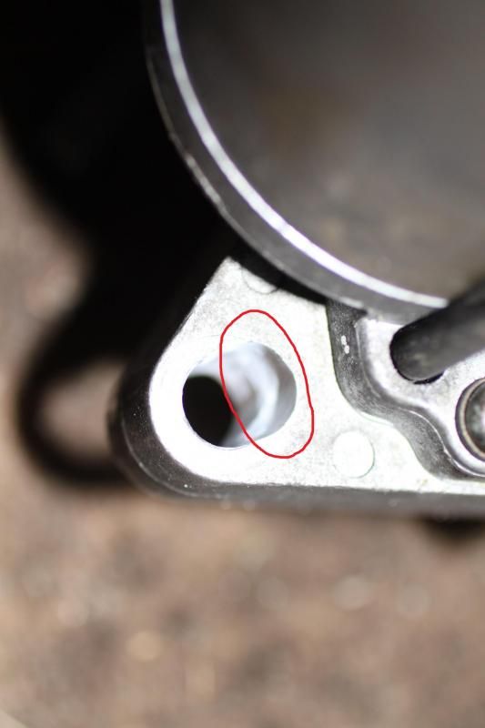

Shave the lower "ear" on the corner on the side facing the gearbox.
