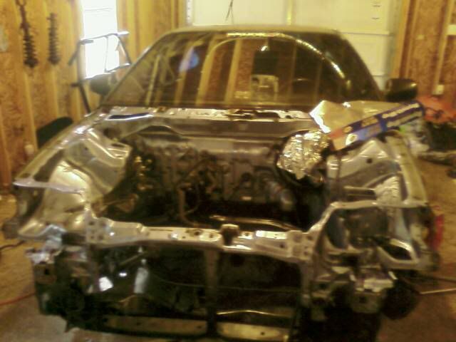

Spray
Stripped (sorry for lack of pics, Topher is unhumanly fast at taking out a motor, and i didnt get there in time)

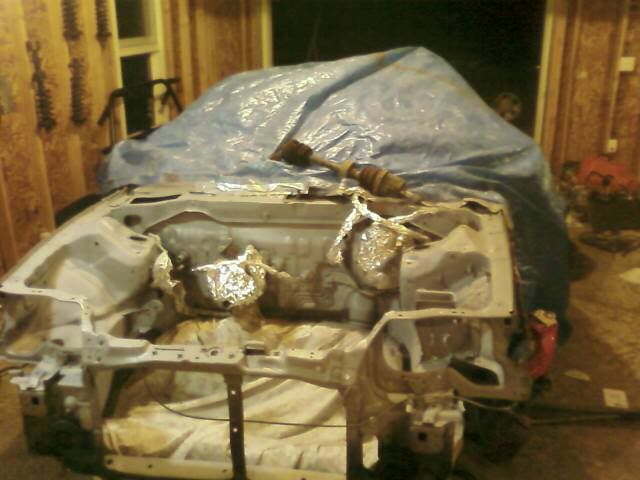

Preppin
Bay Primed

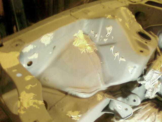

Bondo (I hate this stuff)
Prepped

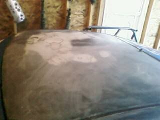

Ya thats about 3 inches of bondo. Previous owner claimed a tree fell on it... It was bad!!!

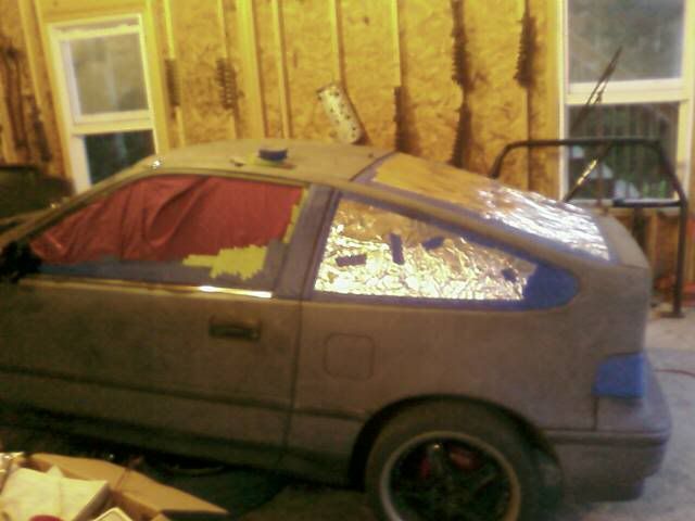

But here's an update on what got done today..
Finished priming, and wet sanding.
Then layed down my base coat, gotta go back in and tape off everything tomorrow to do the reds and greys. Gonna do an urban camo paint pattern on it. Im hoping it will look good, and not too much like a rice cake.

That pic turned out pretty good for a 2 year old cell phone lord. As far as dropping the motor in, not a big deal. The flipping ES inserts were a PITA though. I had to get my impact with a long bolt and washer to zip them into the mount, worked like a charm, but then the fatter mounts needed a wider bracket on the car so I had some small hold backs but nothing major. Everything is off the firewall and mounted on a bracket under the intake manifold. Most of the wiring is done, just need to get on the inside of the car and plug it all in. Axles, exhaust, shift linkage is no biggy either, then the car will be drivable again. BTW, got the wheels in the sedan right now and they are ready for paint :TU:

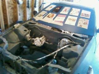

Here's my daily update, i didnt get too much done today, didnt have much time before work. But i got the inside of the hood primed and painted black.
And did some tapeing... =/
and more tapeing
and more... Btw theres one of 4 freshly sandblasted rims, thank you topher yet again!!! gonna paint em red tomorrow morning as soon as i get over there to em.
Hood
Tomorrow i should get alot done, including the grey coat down, and prime and paint rims. Still got more tapeing though...

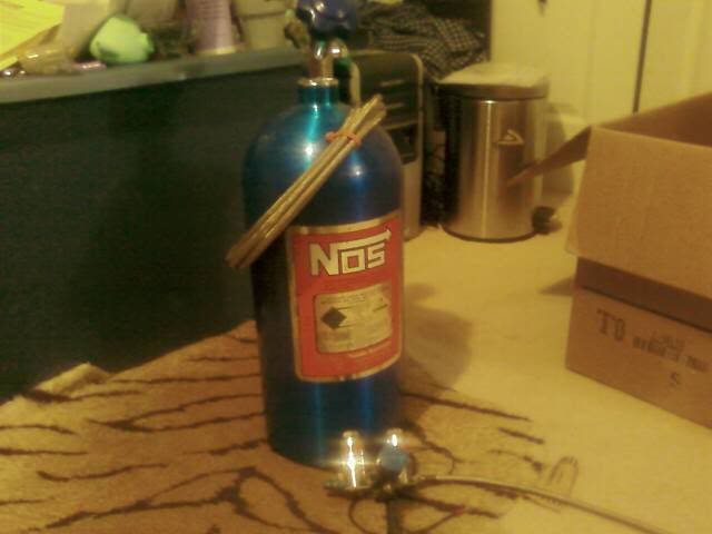

Well.... I dont really know what to do now.... Its DONE!!!!! For now! It drives amazingly!!! Not the same car at all... The zc has great power, i like it lots!! Im gonna finish hooking up the spray tomorrow before work, shouldnt take long at all... The only problem we ran into with the swap that is still a problem, is that the zc header is a 4-2-1, and did not include the 2-1 part, soo i had to put my B2 header on it.... =/ Soo the exhaust ports arent flush, losing power... And its got a leak somewhere. After IA im just gonna pick up an aftermarket d-series header and dremel out the ports. Unless someone can give me a sweet deal on a header and bring it to IA! =)
But anyways, heres a couple pics i took whille fueling up.
