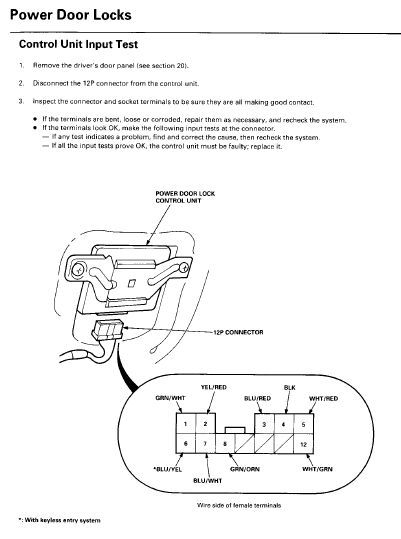

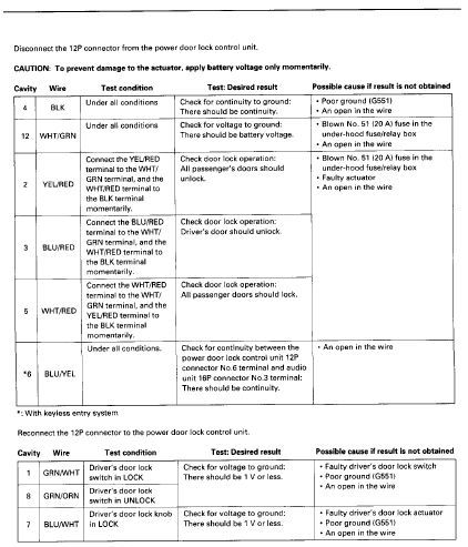

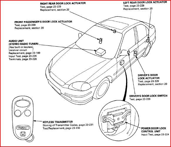

#8 ·
The third picture outlines testing the control modules wiring. The last part of it test the lock/unlock function. If those pass the module is bad.
The keyless entry is built into the factory radio. If your car/radio is keyless equipped you would need to get a factory key fob and program it.
