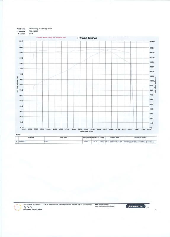

I have a d16z6, 147hp at the crank.
Mods:
- H23 TB, took off coolant lines
- Hondata gasket
- Stock IM lightly polished
- K&N drop-in
- Megan Racing 4-2-1, heatwrapped
- Decat
- 2.25" catback with IMCO rear muffler
- No p/s
- streettuned using Crome
Not a big modlist, but it's much more fun to drive now.
Soon to be mounted:
- LSD Motorsports 6puck, mild PP
- LSD Motorsports Chromoly Flywheel, 8lbs
- AEM camgear
- COMP 59300 cam
I'll post up the dyno results when it's all in place.
I'm hoping to achieve something like 155hp.
Do you people think this is realistic?
And yes, I've searched, but I could'nt find a clear answer.

according to your dyno sheet...do you have 165 lbft of torque?
No, that's in Newton-Metres, around 123lbft. Divide Nm by 1.356 to get lbft.
· Banned
3,953 Posts
That equates to just under 122ft/lb. Not bad
