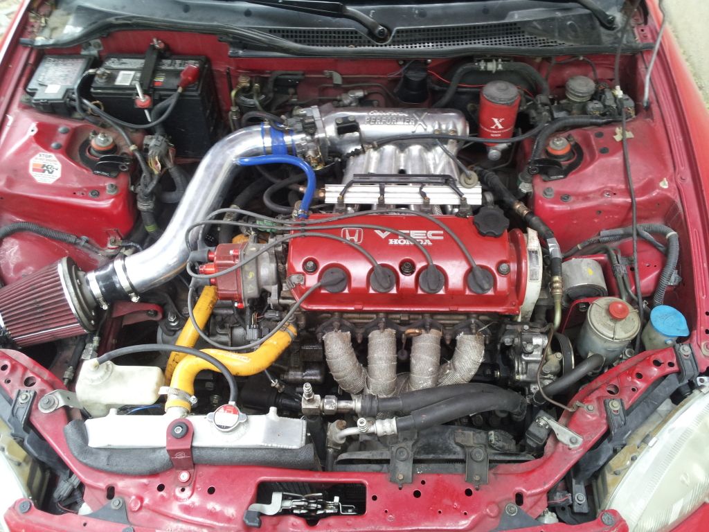

Here's a pic of the engine basically as I found it. The only thing's I had done as of this picture are put a K&N stock replacement airfilter in, taken off the header, high temp painted and heat wrapped it.
Here's after I got it back the second time and started working on it.

del sol as it sits today.
had to ghetto some stuff cuz I didn't have enough time to get rid of the resistor box for the injectors and change the IM. But got rid of the snail.
