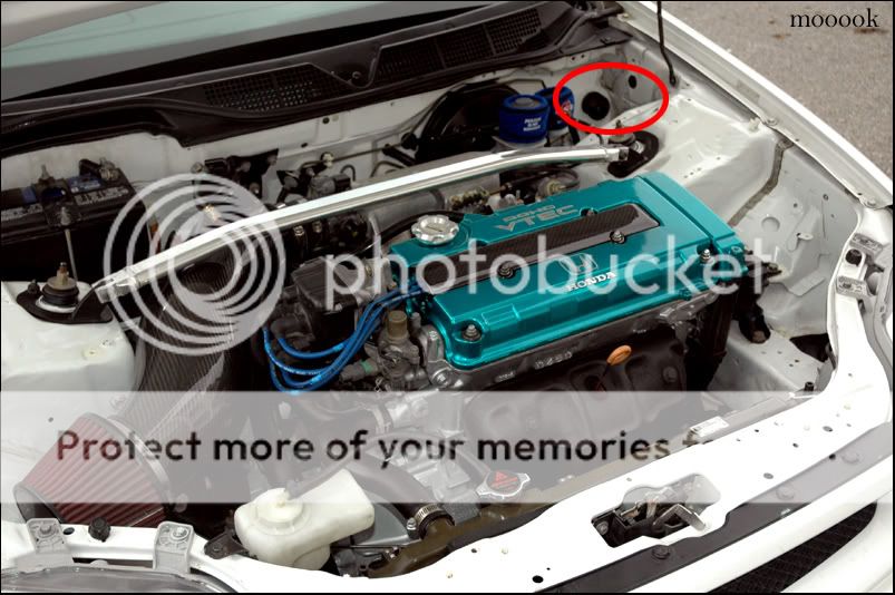

im in the process of doing a wire tuck on my 98 civic lx. i was searching online and everyone says to run the headlight harnesses into the car and then around the fender (see pic)
my question is, where does the main harness connector end up? by this i mean the large grey connector that carries to your interior
also, which holes do you guys use for running these wires? does it affect the structural integrity of the car to enlarge/add holes?
thanks!

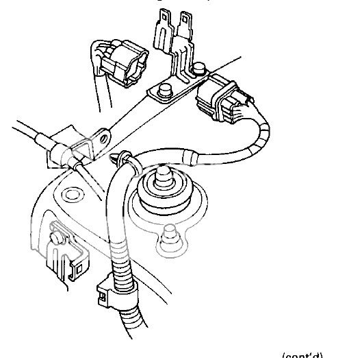

here is a more clear pic, im wondering where the female connector (attached to the vehicle, not the engine) gets routed to

i ran it on the inside of the car. both pass and drivers plugs were in the center behind the motor. the headlight harnesses i cut the the plugs, labeled the wires for plugs, extended them the wires, ran them through the frame rails under the fenders and soldered the plugs back on. i'll try and get a pic of the last bay i did...
its the cleanest way IMO, but you have to take the dash out.

im planning on buying a rywire harness and i was wondering where the best place would be to put that connector, in the fender or inside the car?
right now i have the wires poking through the hole that connects the car body to the door.

thanks for the reply dude. i was curious as to if the main interior harness should be routed into the fender or into the cabin. i called up rywire today and he said to route it into the cabin :bigok:
