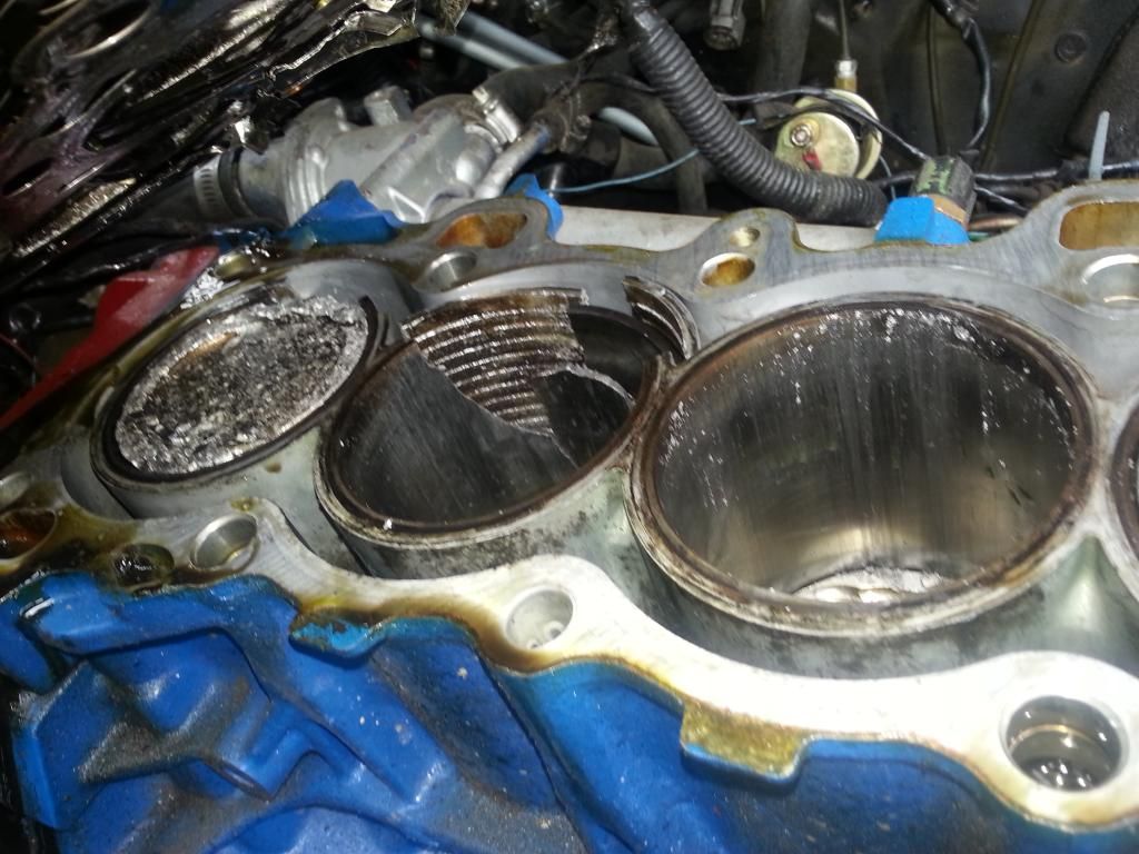

i don't know , i drive about one year with this setup without any problems and last week when i was waiting at a traffic light idle drop and come right back at normal speed ... after the green i started to drive , accelerate normally but when i shift to 3rd it stall and voila.

I'd really pop the valve cover before claiming its the cam.

Yeah, really don't know the culprit for sure until you open her up. I'm curious to see what happened since I have a 59300 sitting on the shelf...

OEM cam/cam gears do this as well. It is a fight between the timing belt, cam gear, and key way as too which fails first when the cam starts to seize. Common on D15 DPFI that never got proper oil changes. If the timing belt doesn't break first, the center of the cam gear will spin. With the newer 96-00 cam gears the spokes can fail, ripping the center out.

I had the same basic thing happen to my 96 y7 before. I sucked some of a Fram filter up into the oil pickup that blocked the oil flow. Cam started to seize in the head and the cast in camgear key got sheared off so the gear would spin but not the cam.

Wiped out the cam, head, cam gear, and intake valves, D15 pistons might be usable but rings are worn.
Hey you could have done this,
Note the same markings near the intake valve pockets....
D15B2/7 with VTEC head swap and large aftermarket cam swap....kiss kiss boom!

Yeah i'm lucky , valve didn't get sealed anymore diesel dripping out the chamber in 6 of the 8 ports...
And yes cylinder wall look like they shine too much yes . But engine only have 100k so i will put the original head back after small rebuild and hope the D15 will still be fun to drive , cause of budget... Engine Output 152hp - 118lb.ft @ flywheel right after the cam install . Hope to see at least 120hp !
Question is , do i need to re-install the Oil control jet if i goes back with PM3 head ? Can i still use a D16Z6 metal Head Gasket to ?

oil jet HAS to go back in but I fear you will still have oiling issues. I'd drop the pan and make sure the pickup is not clogged with sludge.

non-vtech blocks have it,
vtech heads have it.
since you're running vtech head, it's already there, if a block is original d15b2(7) it had one too and you have to remove it.
96 ej8
651 Posts
He is going back to a non VTEC head, so yes you need the oil jet, only when you add a VTEC he'd go a non v block is when you don't need the oil jet because vtech heads have it built in
