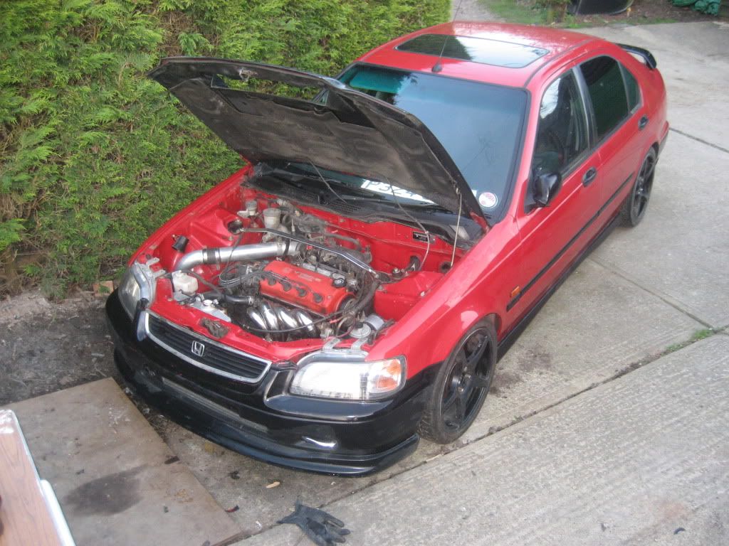

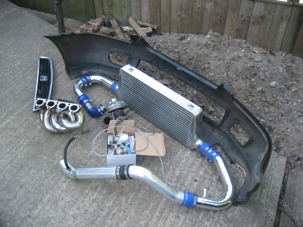

Just got my turbo bolted up and running so thought i would share it with you all the idea behind it has been to try to have high mpgs and plenty of power on demand.
i like pictures so here we go..
this turbo turned out to be shot so replaced it with a garret t3 i got for a good price

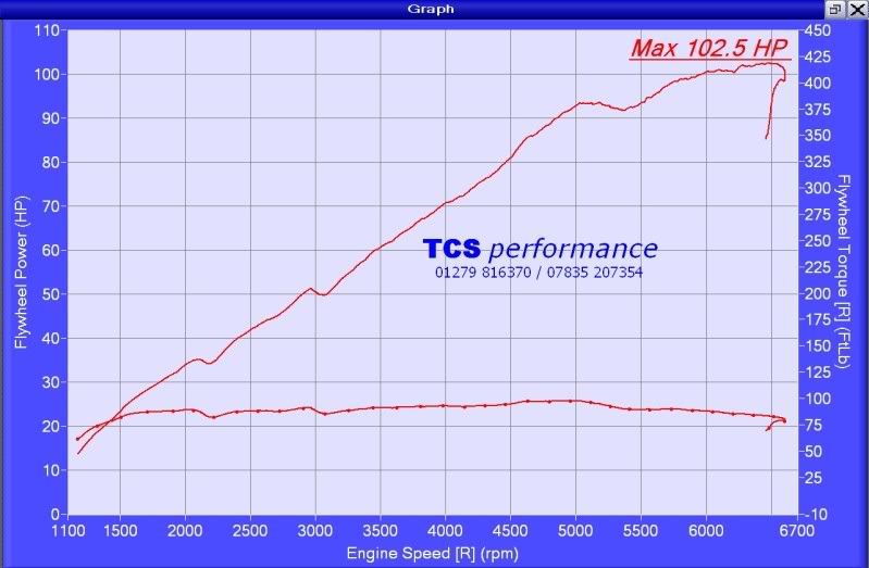

Dyno from before NA an tuned by me could be better
i will be going to get this setup tuned propperly soon need to get some injectors first

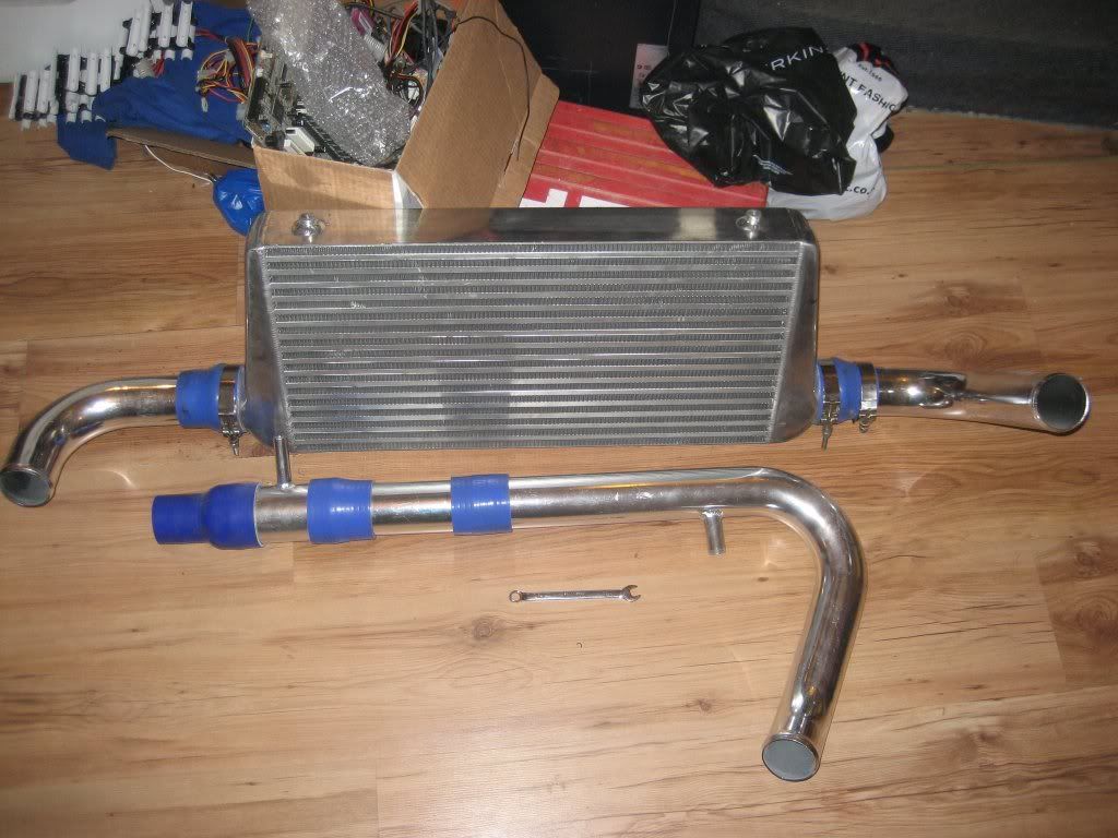

Is it normal to loose 1.7psi through an intercooler of this size my wastgate is at 7.9psi and granted it will start to open before this pressure but on the ecu i only recording a peak of 6.2psi is this normal or does it sound have a boost leak somewhere?

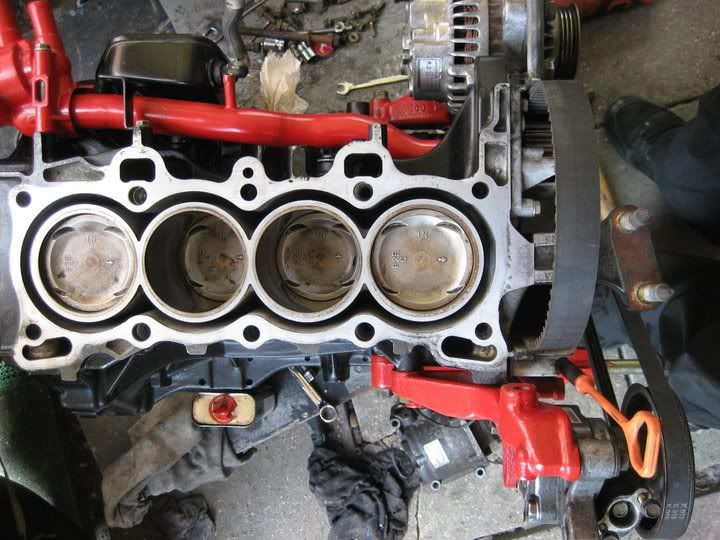

this is my spare d16y7 block thats waiting for the fjt vitara combo

pressure drop seems normal
if you want to accomplish your boost drop - just take the source of your wastegate
pressure from somewhere after the intercooler. just do not take it from
behind the throttle body.
nice pics, nice car. missing dyno [email protected] psi ;)

yeah the manifold is an ebay one blurr twisted ram i won it for £70 taking a punt so if it lasts 6 months i will be happy.
few other parts have be brought from ebay wastegate and bov, the intercooler came from a friend just wouldnt fit on his car allong with a few bits of piping
this has all been done on quite a budget
