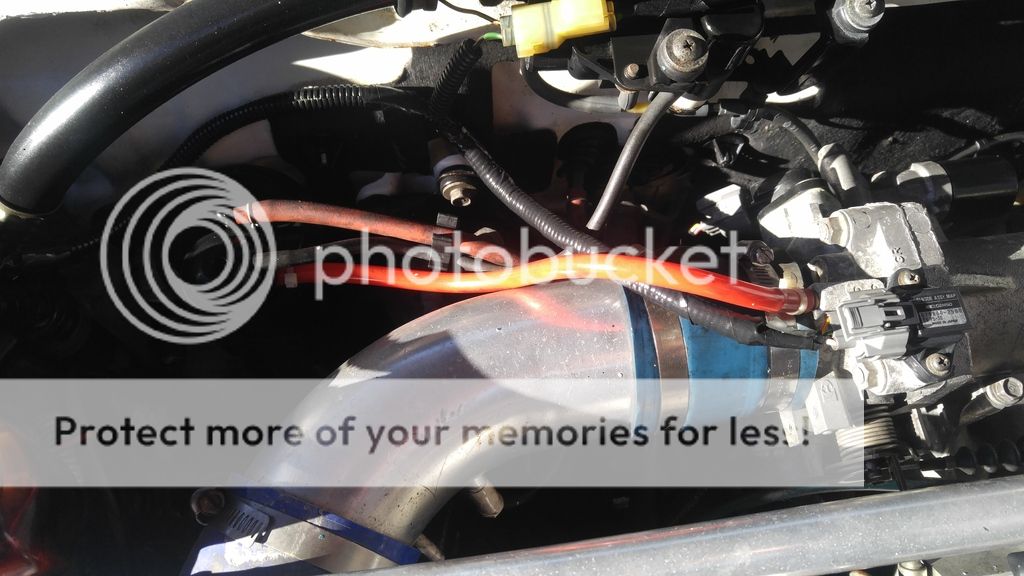

Since I'm using the z6 throttle body and map sensor, can I just get rid of these vaccuum lines?
Also what goes on the bottom nipple on the pcv? And the nipple on the throttle body?

I got it all figured out except the one on the purge valve.

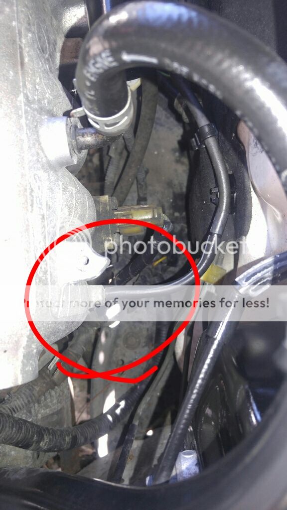

Purge
88' honda civic
467 Posts
It goes to a nipple on the back driver side of the intake manifold.

Just tee off one of the intake vacuum ports if you don't have that nipple.

Maybe this line will work. Seems to fit?
That's the way mine sits. I did think I switched it out but it's been 7 or 8 years since I did mine.
Turns out the stock ef fuel line does work. I got one off a y8 at the junk yard, tried both and no difference.
Not sure why all the write ups say you need a different one.
