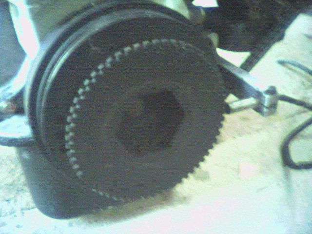

Heres my pulley setup, I guess I should go get a shiny pulley.
