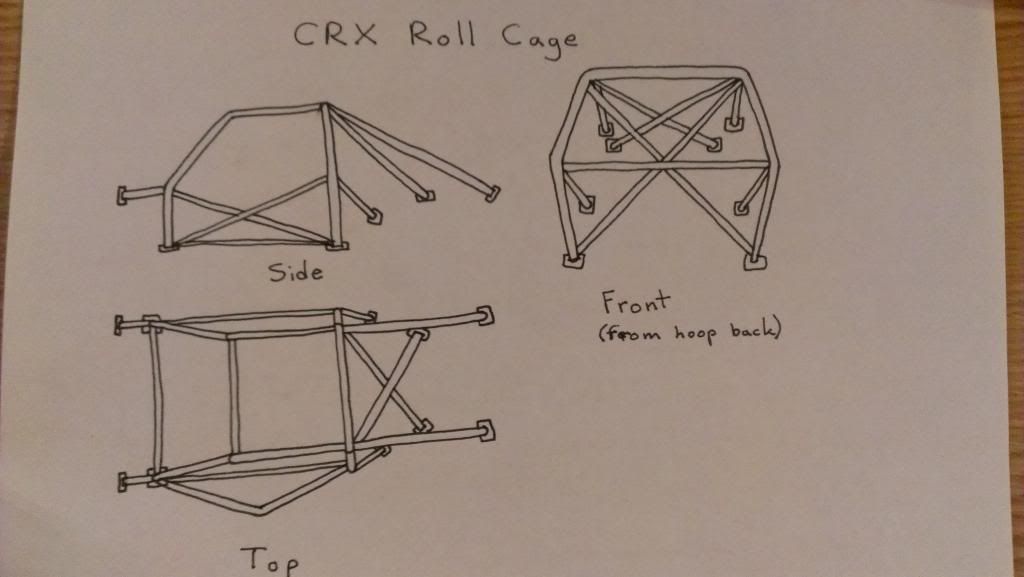

It doesn't specify if the tubing is DOM or EWS so I'm guessing (based on the price) that it's EWS since NHRA allows it. I don't know if I am willing to put a roll cage made from EWS tubing in a car I eventually want to run low 8's.
However I'm looking to put in at least a 12 point cage. Something more like this
Jegster 948805K Jegster ''Honda'' Roll Cage Kits
and even then I will probably attach the cage to the body at multiple other spots just to get a really solid/stiff chassis. Since the cage would be a bit overbuilt I might be willing to use EWS but I want to get some different opinions on that since it's a safety issue.
Kinda what I'm thinking for the roll cage. Lower hoop braces to connect to the front end of the rear engine bay, an X-brace to the rear strut towers and supports that go to near the rear bumper mounts. This should attach the rear drivetrain/suspension pretty solidly to the rest of the vehicle.
I prefer, abs many more cage builders are also starting to prefer the double parallel door bar style, at least on the driver's side, as it moves the cage farther from the driver, thus providing a better zine for protection for the driver in the event of a side impact. I would also highly recommend looking at modern cages that incorporate footwell intrusion protection, as that is important for the run cans we drive.
