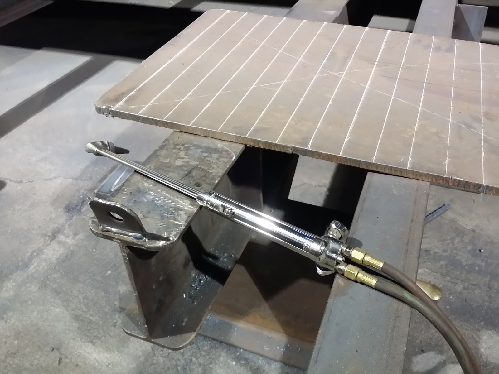

Beaver Built: Tool Review Tuesday, 04: Smith SC179 17", 90* Straight Cutting Torch
I use this thing every day at work. I despise it, despite being one of the best made tools that I have ever come across. It is nearly entirely quality stainless steel, fits superbly together, can get run over, dropped a hundred feet, stepped on, etc. and will fire back up and get the job done.
I HATE the lever. I don't like the knob placement. It is pretty ridiculously expensive, even if it can outlive you. Cutting with it feels very awkward. I much prefer the classic Victor-style torch as you can easily flop the body around so that the lever is under your palm, making for a more natural grip on the torch for a much improved feel and ease in handling while cutting.
This is totally NOT Beaver Built Approved, but you might find it suitable, especially if you want a very reliable tool to cut crap or heat stuff up.
