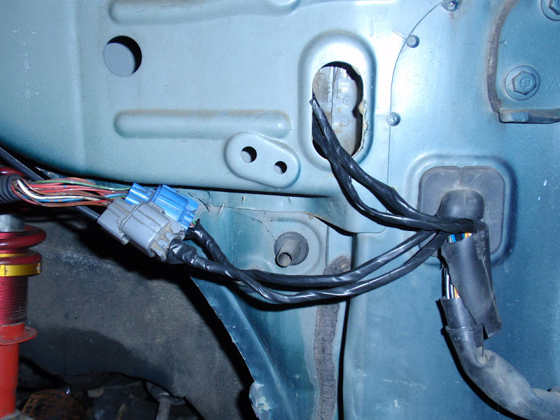

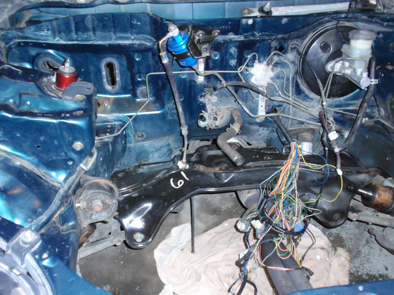

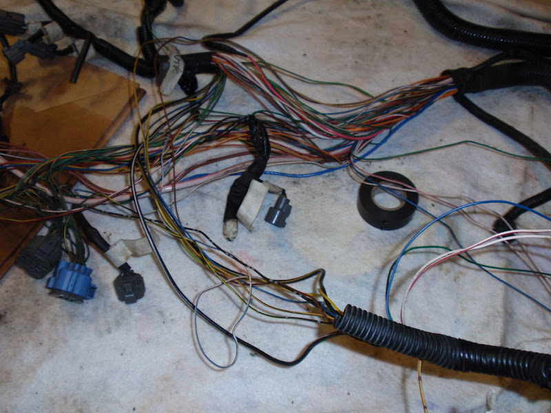

while waiting for the block and other parts I've been working on my wire tuck and other miscellaneous stuff.

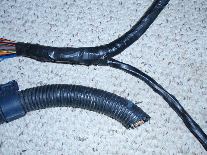

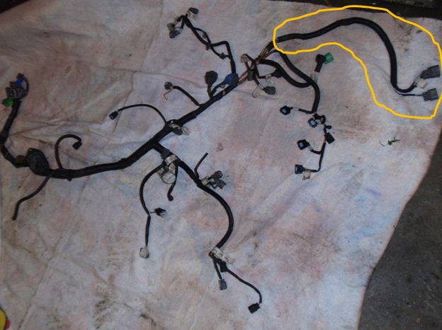

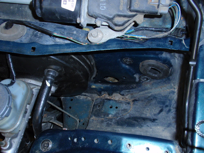

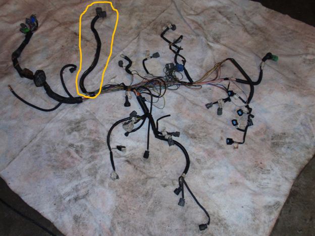

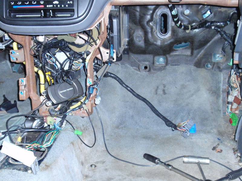

In order to conceal the harness I decided to run most of it under the dash and drill a hole in the firewall. This is how I dealt with honda's circular harness design that used to run and connect in the engine bay..
stock harness:
a little rearranging:
new general shape (the left half, including those moved connectors, will now be under the dash):
the right half will stick through the new hole in the firewall and 'sneak' up from under the engine
here is a close up of the part of the harness that runs through the firewall now. as you can see it got considerably skinnier once I removed the automatic plugs and wires. under it is a stock automatic harness that i pulled off another car.
rerouted the driver's side harness and extra wiring:
where they now run through the fender:
8

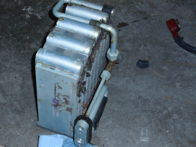

everything became a little easier with the air boxes out of the way:
found a nice, heavy, air-blocking ac contraption in front of the blower, which will no longer be needed.
I can't even imagine how much better my heater will blow with that out of the way.

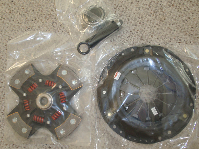

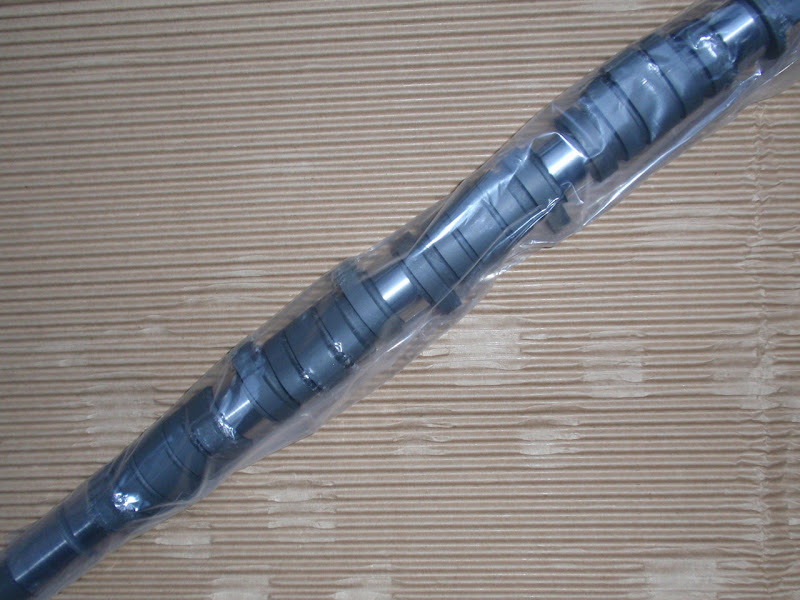

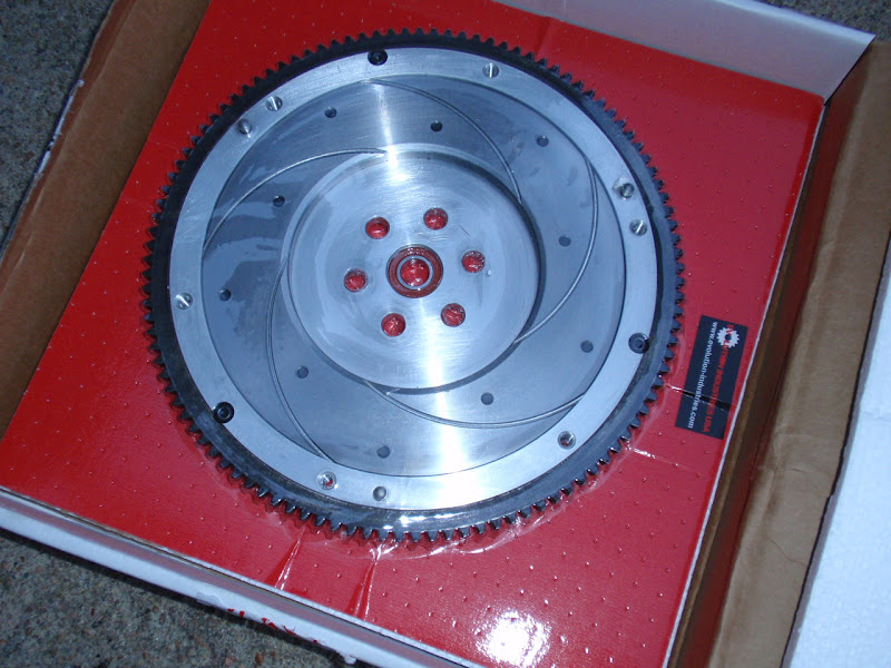

also got a couple goodies:
8

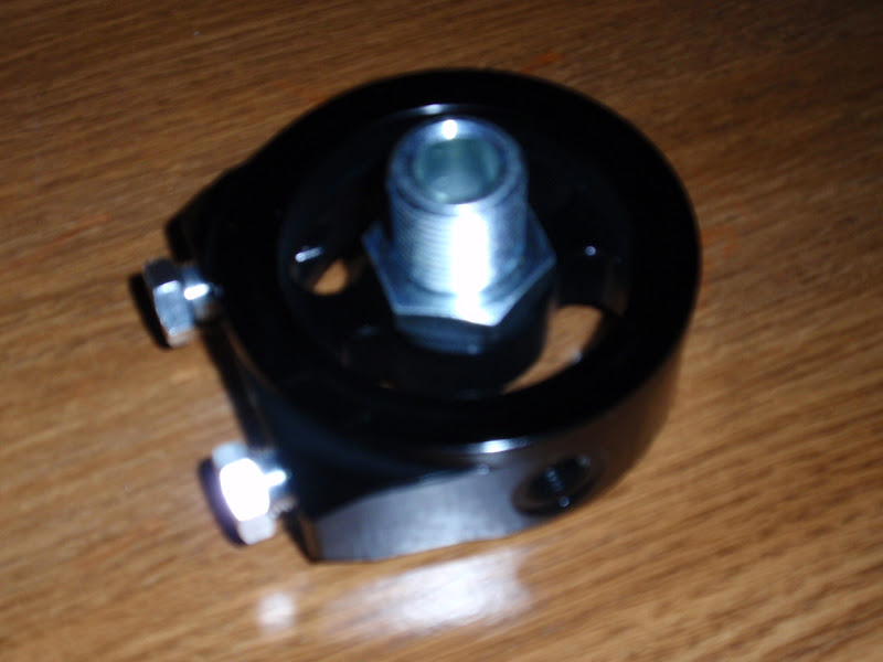

I never put too much thought into getting an oil cooler, but i suppose it wouldnt be hard to do now that i got that new sandwich plate.
