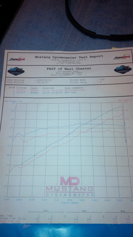

Hi Guys , I thought I would share my setup and dyno results.
89 CRX SI
Zc dohc Obd0 converted to Obd1 Hondata s300
Tuned on E85 and 93 octane
Jrsc with Lht intercooler, blower ported polished by Mr. Grimm

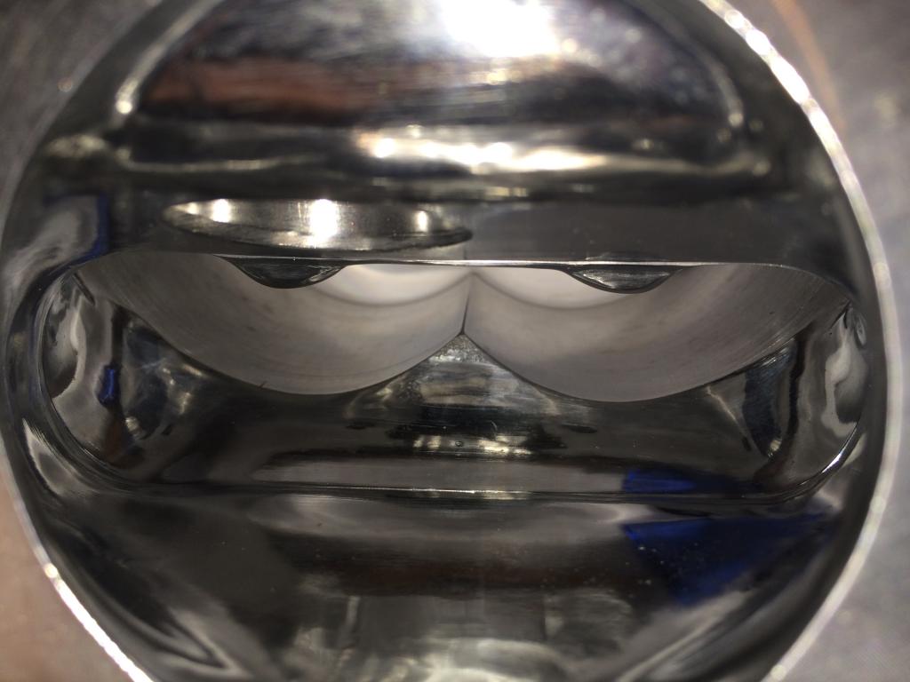

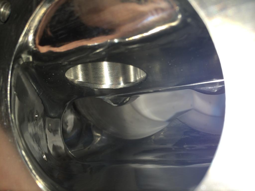

Work Done to blower
Retiming Inlet and Outlet Ports for flow and Increased CFM & Lower IAT's
Correcting the 3mm Outlet port misalignment from casting / machining
Porting out Rotor housing Inlet
Porting out Rotor housing Outlet
Total reshaping of Inlet and Outlet ports
Port matching to S-Tube
Porting out the S-Tube Inlet to allow larger custom intake
Porting out the S-tube Outlet to match the Charger Rotor case
Media blast S-Tube to remove old sealer and Oxidation / Stains from outer casting
Polishing of all Port work
Refacing all gasket surfaces
Press in new Rotor Bearings
Reinstall all 8 studs with locktight after chasing all threads
weld weep holes closed
Had supercharge sent to High speed labs for rebuild and rotors recoated. The owner was impressed with Mr. Grimms port and polish work.
Ford lighting heat exchanger
3.4 jackson pulley with Y8 crank pulley. Dyno showed 8.7psi boost
Colt Tri flow cams , stock spring and retainers.
Adjustable Eagle cam gears, not touched for tune
Kamakazie header, high flow cat and Thermal 2.25 exhaust
68mm throttle body with aem cold air intake
Sard fpr with aem fuel rail, 900 injectors from Injector nation
Walbro 255 pump
New vavle guide seals had machine shop check guides said they were within specs
Oem head gasket copper sprayed Arp head studs
Stock pistions and rods
Si transmission
In the process of pulling the transmission and installing Zc 3rd and 4th gears and Mfactory LSD,
Would like to see how much more power this thing is capable of with a smaller blower pulley, a new intake tube fabricated and maybe play with the cam gears but I'm afraid I am at my limit with this bottom end.

93 Oct: 214HP 169 FT-LB
E85: 237HP 188 FT-LB
Love the back to back testing of the fuel types. That polishing looks fantastic. Looks like you would've made a few more hp if you took it to the factory cutout.

That’s certainly sexy. I wonder how much the polishing actually helps.
I wanted to weld the holes on my supercharger but never got around to it. Supposedly the whine is much louder with them closed.
Not sure how much the polishing helped since I had it done before installing it, I will try to keep a closer eye on my IAT this summer to see how hot they get.
Same as above, it was done before I installed so I cannot tell you how much louder it is.
