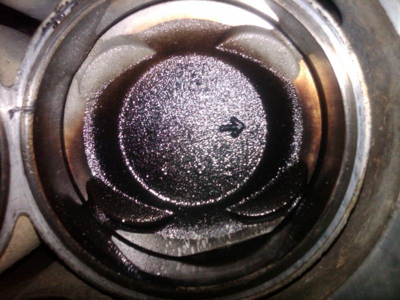

Did I read that this blew up? Stupid vitaras! Did it melt or was it a ringland? This build was awesome. 20g's are hard to find, like you said, and fun ass hell.
I still want that evo9 16g if the price is right. lol
Yea it blew up, haven't pulled down the engine as yet, right now I'm back to the original stock single cam :(, i fell its ringland due to pushing oil and smoking like crazy. My plan is to rebuild and go forged with a slightly high compression and maybe the evo 9 on a true twin scroll manifold. But school, time and money gonna hold me back right now.

clean as hell dude, i love 99-00 4 doors and its boosted which is even better.i like the sleeper look, wish i could handle having a stock looking car. sad that the motor blew, where you still at the 240hp range or did you make more hp when it blew up?
The headgasket blew at the 240hp range and then i cracked a piston.
