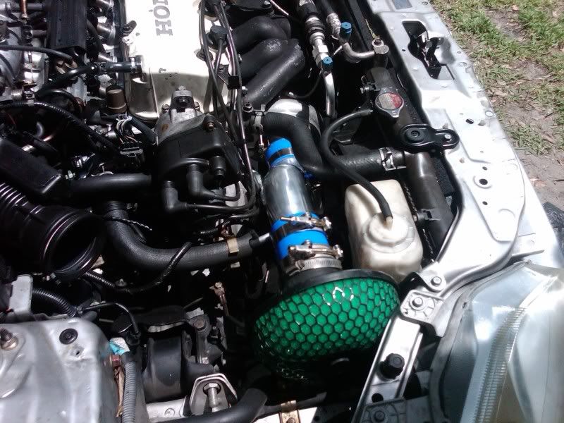

So last year February i got my a 2000 EX coupe, silver and it was auto, but my idea was to turbo the auto and make around 300hp out of it. While attending school UTI that is, I was doing research and started to get bored driving the stock car, so I looked into doing a few upgrades, I wanted to get a chipped p28, bigger throttle body, intake and exhaust. The p28 idea on a auto ek was too expensive and my idea of upgrading a auto car got bash on here lol. So I swapped it to 5sp. Got exhaust and intake. Chipped a ecu and ended up selling that combo so someone who really need it as I had to change my intake manifold to get my car to idle.

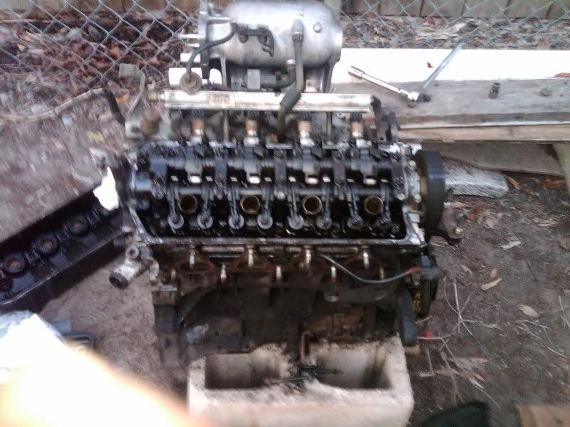

I had acquire a spare block and then a spare head so everything changed, and I as go around I got greedy and changed a few stuff also.

y8 head port and polished
supertech valve springs and retainers
Crower Stage 2 cam may change to a delta 272-2 or a custom grind of my specs :rockon:

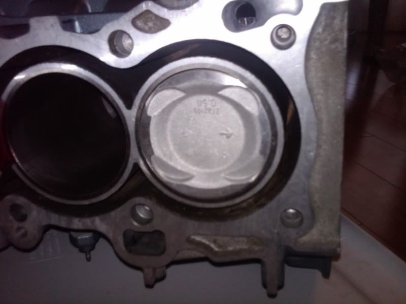

Bottom half D16Y5 block (local , got complete long block for $50) spun bearing
Decked 0.005" for proper headgasket seal
ARP head studs( Murrays Speed shop in orlando)
75.5mm Vitara Pistons(thanks to go-autoworks, need a sticker from you guys though)

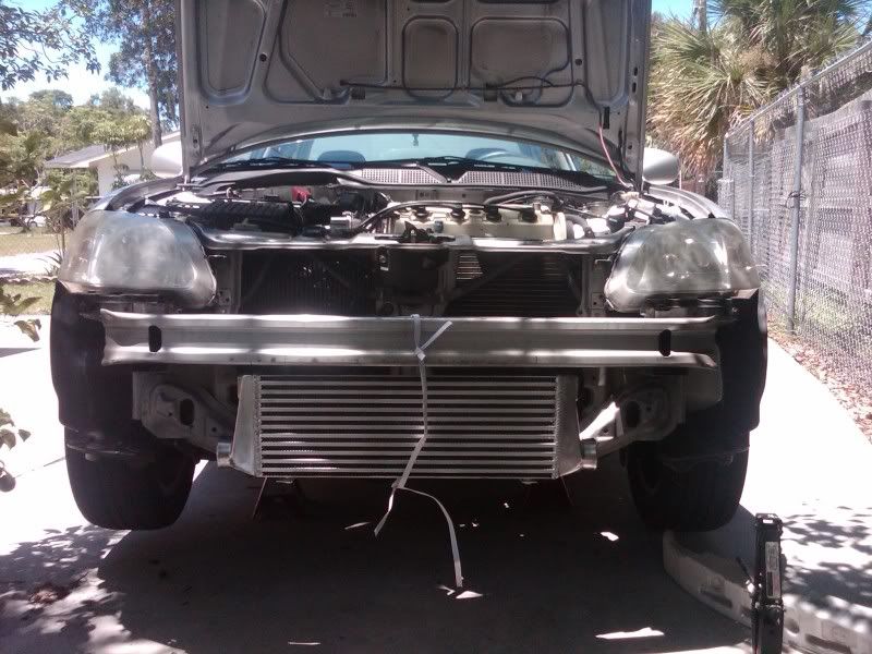

Yet to order intercooler, cast iron manifold and intercooler piping. All will be ebay
