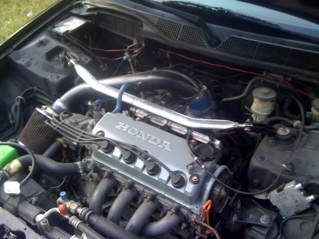

nothing fancy under the hood...

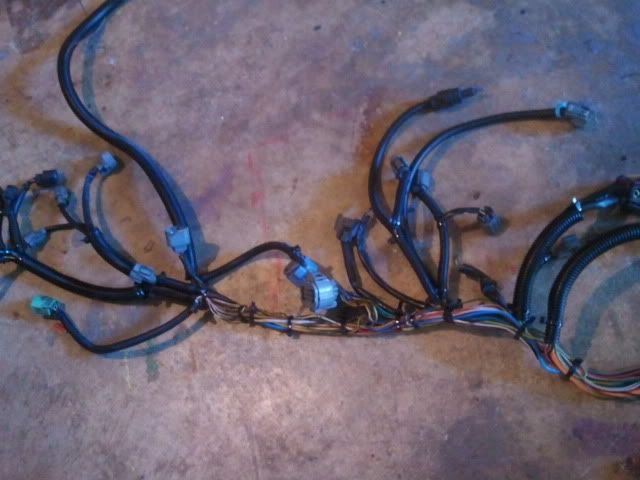

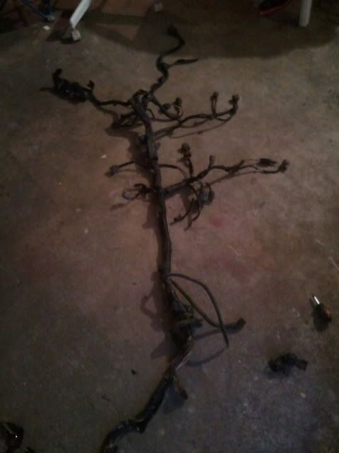

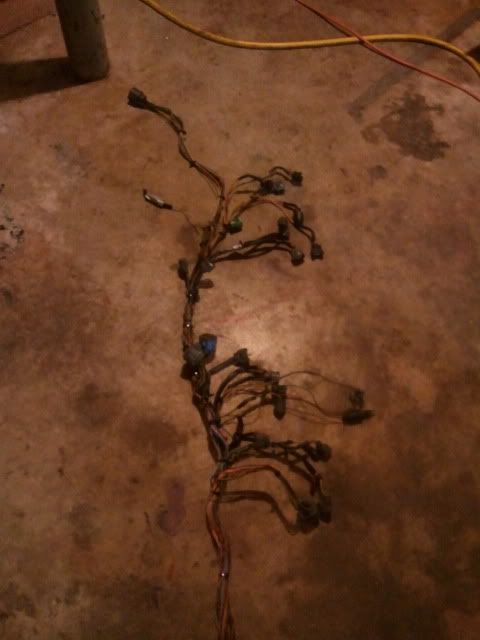

started working on a harness a couple of day's ago for this turbo motor....
before...

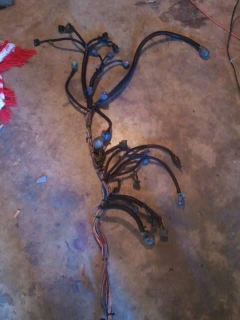

where im at now....
already mocked up, zip tied and ready for sleeving, im using techflex PET uptown purple (black w/thin puprle stripe) and purple for the 1".....$44 worth....should get it hopefully at the beginning of the week....then the "fun" begin's....
its gonna look sexy when its done ;)

tbh im not looking forward to it at all....im having to leave the big junction's in the harness on because honda-tech is a bunch of weiner's and wont help me look just give me a "search noob" a noob doesnt get this far lol...
its going to be interesting...and i have 2 more harnesses just incase anything goes deathly wrong....

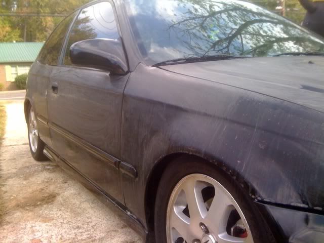

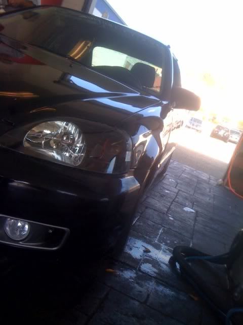

i wet sanded the shit out of the car too... 3 day's and a week's worth of tennis elbow worth of sanding with 1000,2000, 3000...its smoother then butter, it still needs a FINAL HEAVY cut with a high speed buffer and it would gleam like new....
after about an hour of cutting and polishing...

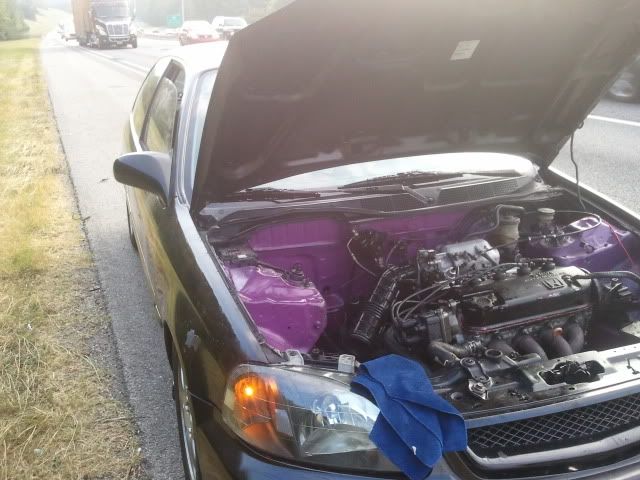

so after around 2 month's of loving the hell out of this car, short shifting like a mother (under 5k) turning into the mall, 2nd gear 20mph, sob start's knocking....throw some 20w50 in it and i beat the piss out of it and got it home (15 miles away)
2 day's later i had a d16y8 in my driveway....2 week's later it was in....

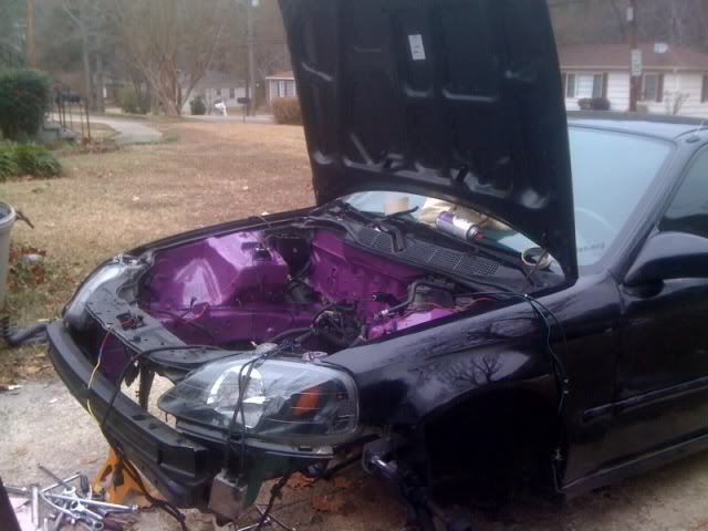

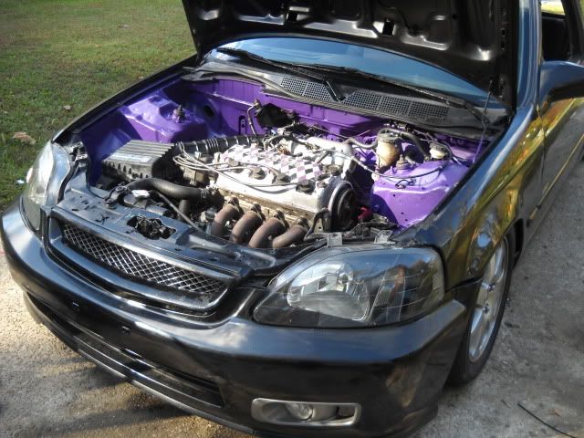

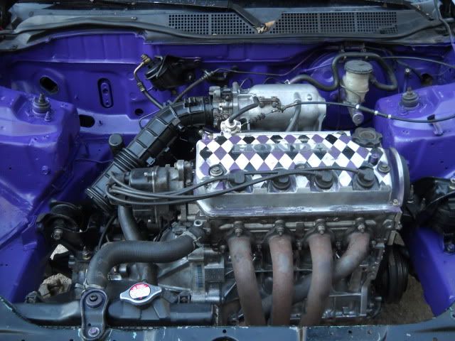

decided i was gonna paint the bay while i was at it, i asked my little 4 yo daughter what color we should paint it and she said purple so.....
nothing like painting an engine bay in your front yard on a busy street....

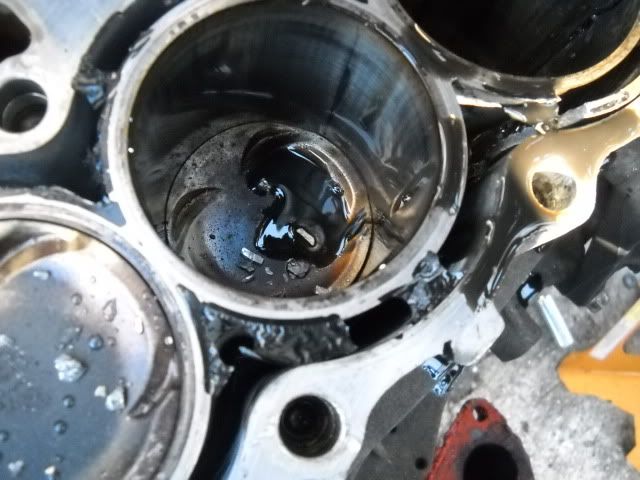

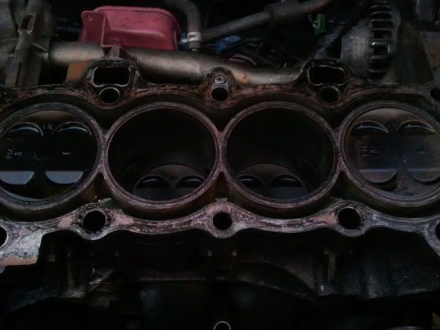

well...60 miles on the motor...disaster...
the largest piece of piston i found was about the size of a pecan....it just poof...disappeared...to this day i still dont know what happened, i had oil pressure, fuel, spark, never ran hot, never threw a code, 40mph it sputters a little bit and POOF! white smoke....timing is the only real guess i have....

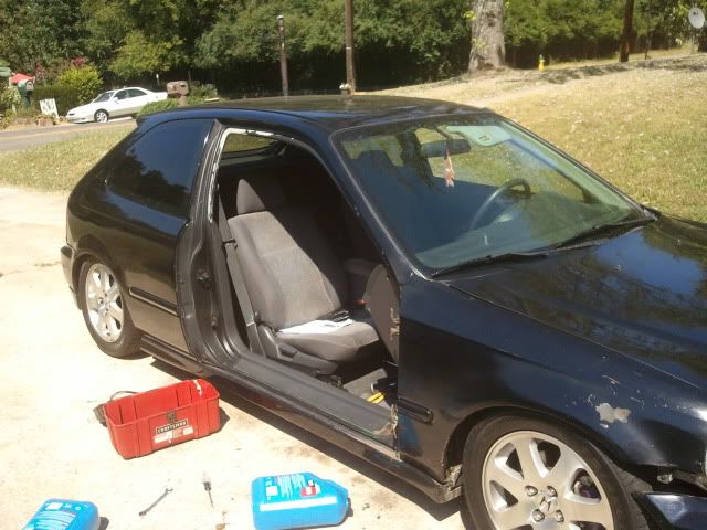

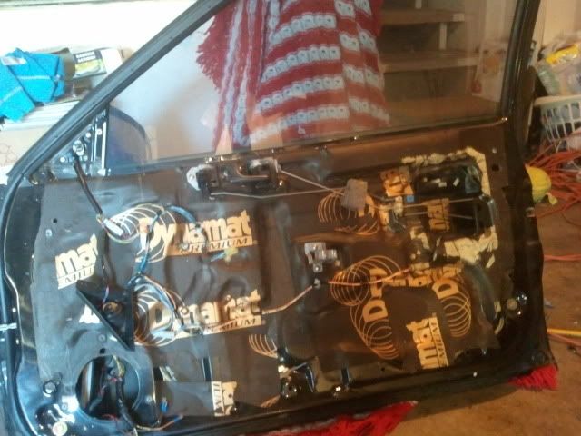

swapping door's and making your own floor harness suck's ass....had the door apart to get the lock's out and i had the frame off....wife hit the window down button....now i cant get the damn window back on track....im going to pull the window out and start over.....so far ive only got one door swapped and its not a big of weight difference as i thought it would be....

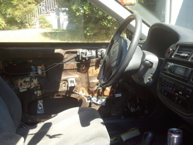

got the other door on....now the fun part, what feel's like 6 miles of wiring....such a cluster, and im going off a diagram i found on the interweb that seem's to work, its gotten the window's rolled down with my drill battery...
tip for those that have never hung door's....floor jack and a 2x4...pick it up in the middle and you dont have to fight it...i was able to get the door swapped in under 15 minutes using that method...

harness..i still have to get some 1" but so far ive got $6 in it for 1/8" and 1/2" loom...
and later on down the road i can always sleeve this harness....but after looming it, it shouldnt be that bad, you gotta do it in order or else it look's like a cluster fuck....looking at the pictures though if i had some wire tape (the non sticky kind) it would almost look oem....too bad youll never see it lol...

thats what the 2x4 is for, something soft to support it....
i had my wife helping me, and she just wasnt cutting it, its the same principle as hanging a commercial door (2x4 wedge's and you hammer them in to level the door up and make it easier to hang....and i figured out on the 2nd door its SOO much easier to leave the hinge attached to the car rather then swap it to the door....
ive kinda ran into a brick wall though, ive got the lock's working, but only the driver side window rolls up and down, now i can run over to the passenger door and use a drill battery and it roll's up and down fine, somewhere in my wiring something isnt right, its only 3 wire's, a positive and an up and a down, my only guess is my wiring isnt strong enough to carry the 12v from the passenger side and counter clockwise around the car into the right rear where the battery is.....idk, its late, it all kinda work's, ill work on it tomorrow...
and i LOVE the dynomat in the door's, makes the stereo sound soo much crisper and cleaner..
