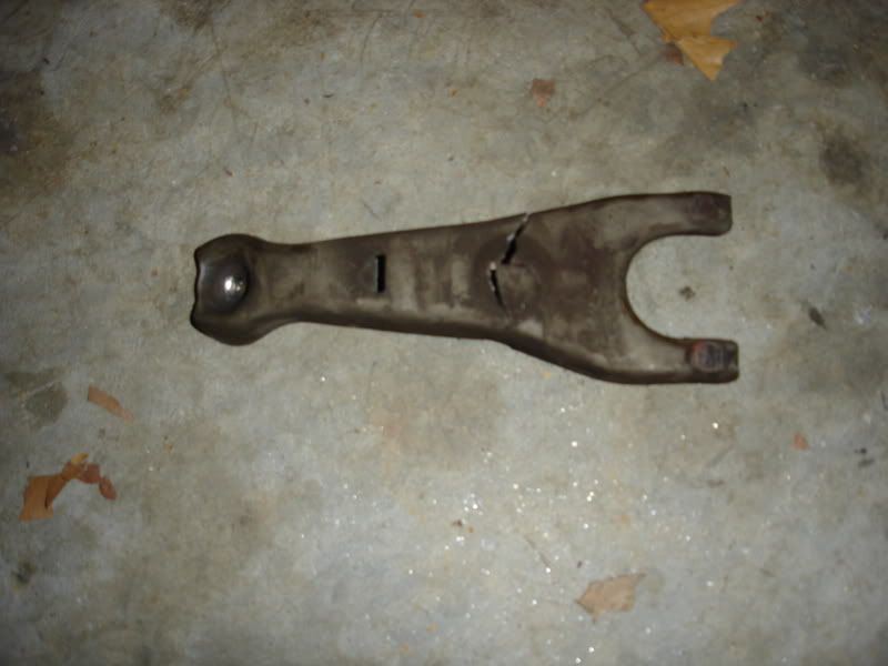

I have never seen a shifter fork break like this, nor has anyone else I've shown this to. I don't know how I managed this :lol:. Here's the whole prob with it not shifting. I had the parts overnighted so they'll be here tom and I can get it back on the road :TU:. You can see where it split

holy crap. i wonder what would cause it to break? how was everything else? where you racing around?

everything else looks good. surprisingly I wasn't racing when it happened. I was just driving home from work :lol:.

A really heavy pressure plate would do it.
too much vtak will do that!

where's the grease?
No grease = wear point at the pivot point.........

do shift forks tend to break easier with a stiffer pressure plate and a higher hp engine setup, or is it mainly the pressure plate?

What tells you that? I would just guess a heavy pressure plate would do it over time.

Sorry Jay ....I'm going with Bone on this one pivot point looks alittle dry , I have a fork... if you cant find or dont have good one

that's kind of what I was thinking. I didn't put the trans in, so I don't know, I do know that the person I use to have help me work on the car isn't going to touch it again. The bad thing is, he's a Honda technician :sadface:. I'm definitely going to lube the shit out of it before the new one goes on. I got a new fork, new pivot ball, and spring to go in.

it doesn't take much grease, hi-temp wheel bearing.......
too much and it will end up on the clutch disc......
grease/oil and clutches don't get along very well.

that's what I used, I didn't put too much on. I covered the pivot point in the tranny, the seat on the fork, the fork prongs where the throw out bearing sits, the indention where the slave cylinder meets up, and a little on the bearing itself .
