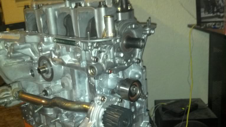

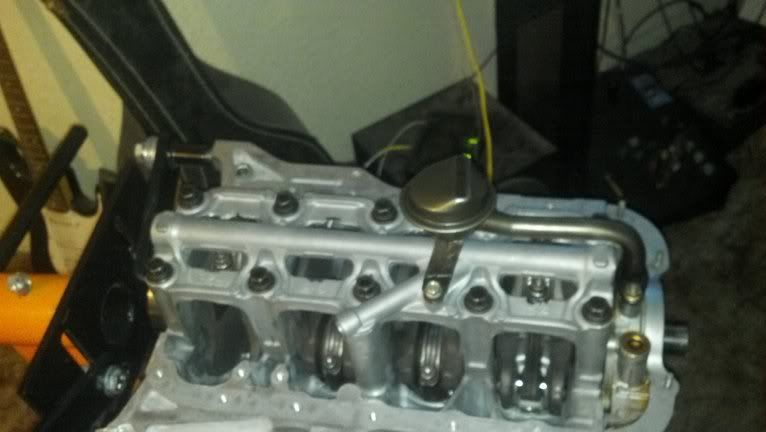

ported oil pump not the greatest job (still considering the shim)
im stuck between painting the block this blue color or keeping it stock

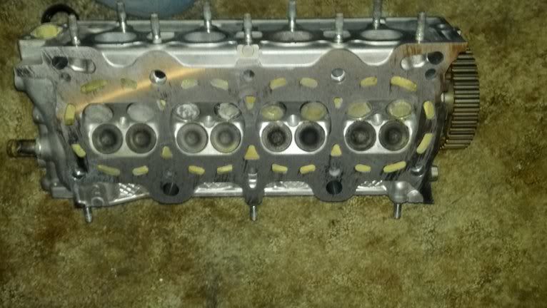

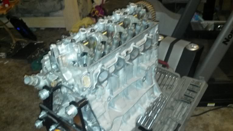

heres where i ended up stoping thanks to my new harley xr1200 and my jeep i just picked up but i plan on doing more soon!

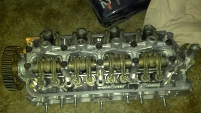

Trying to get to bishop today to get the head to the shop to test for flatness and to hot tank it
Head is at the shop now but who knows when ill get it back

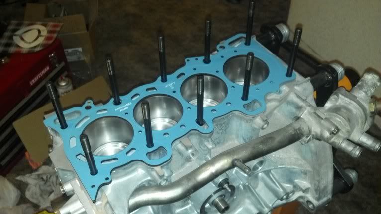

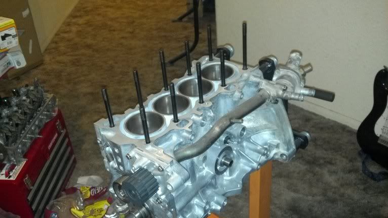

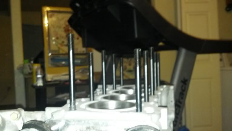

dont mind the grease i already figured out i messed up on that haha i pulled the studs back out and cleaned them then cleaned the holes of all grease

wont be long now
got the head torqued down to 60ft
got my ported oil pump on
