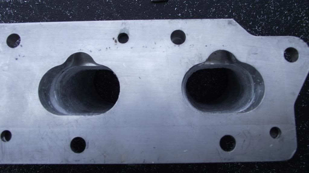

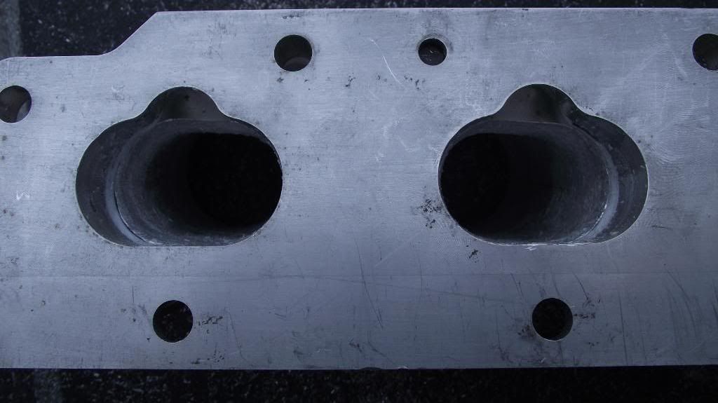

update, update, update. so i've been busy and i found sometime to do more progress.

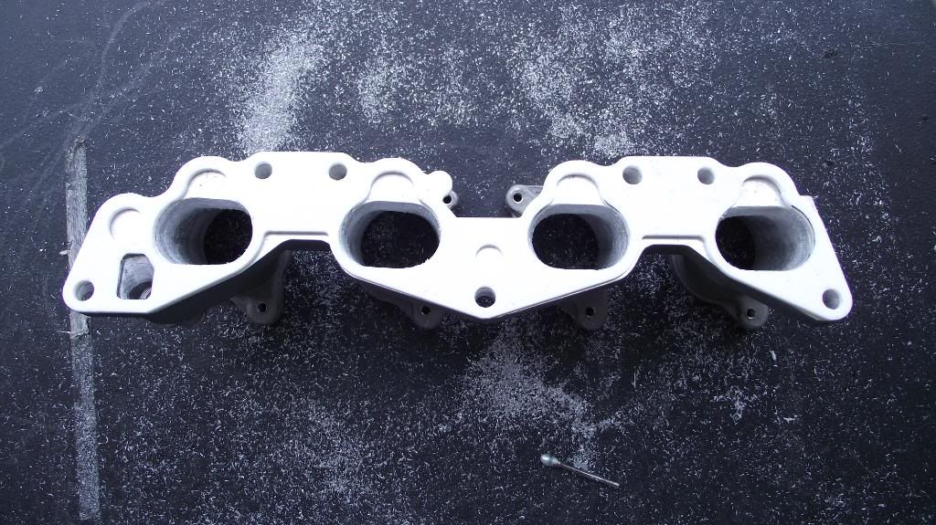

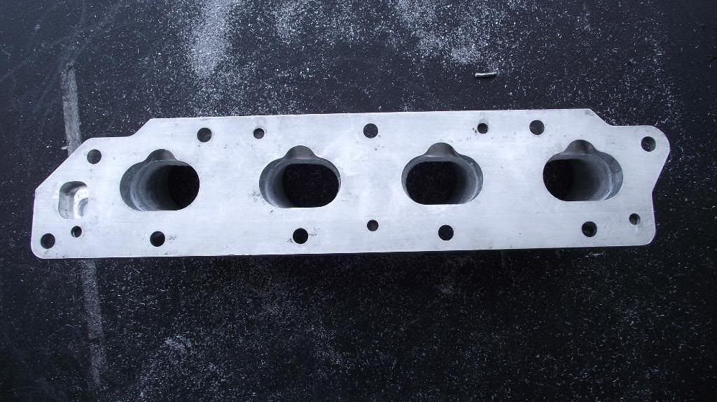

here's the top version of the flange, thermal gasket and ZCSpeed adapter. it just alittle off but othing to worry about.
so know you can see the uneven steps from OBX itb flange, thremal gasket and the ZCSpeed adapter.
I laid the thermal gasket on the flange traced where i need to remove material.
here's the flange with the trace marks.

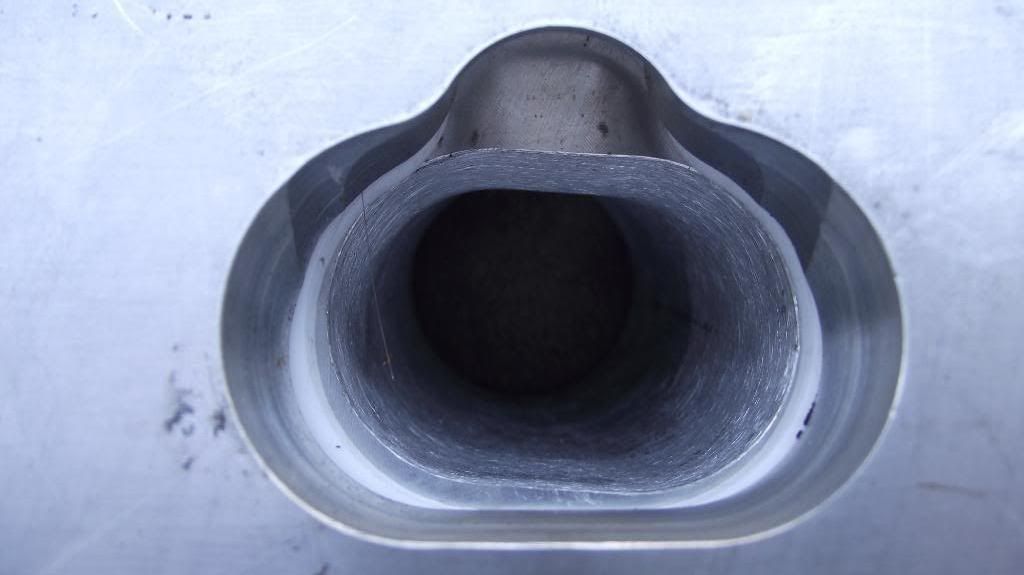

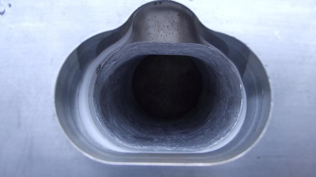

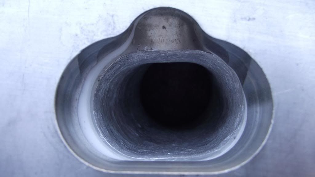

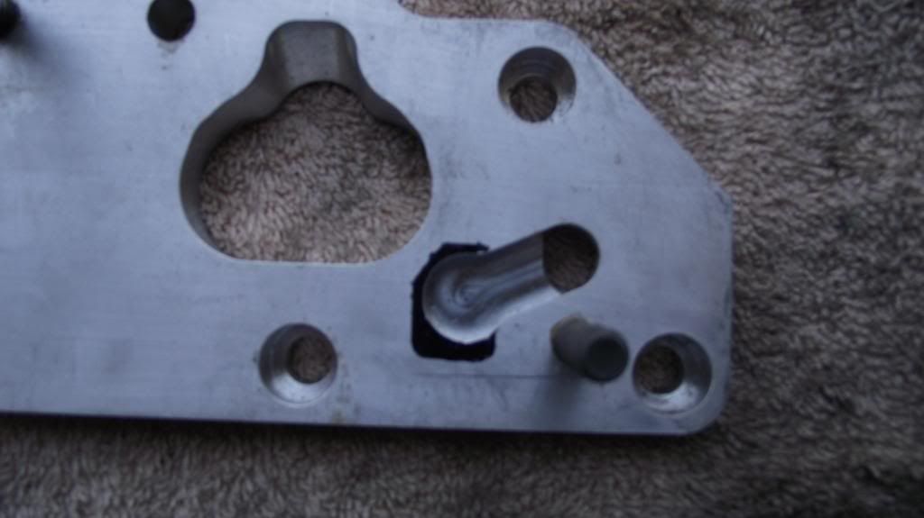

here's the ZCSpeed plate i'm doing to work on. you don't have to but i'm trying to make sure the coolant flows goodand most of all if you see the ZCSpeed adapter is flawless very, very little work needs to be done.

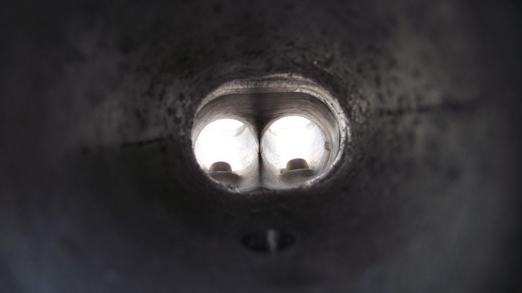

well here's the semi finish port work. i'm just seeing where else in need to grind.
and what the runner look like with work done to them.
here's what it looked like on the head. i started porting my DOHC ZC head but there's still alot of work to be done to make sure everything align up.

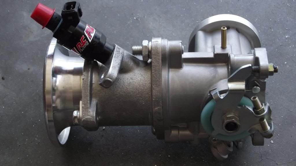

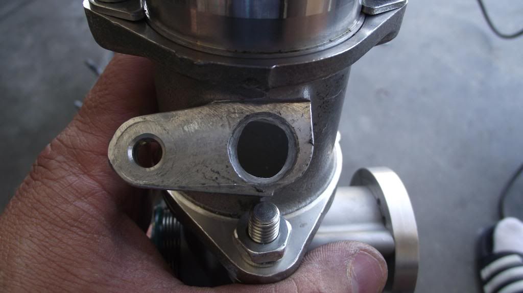

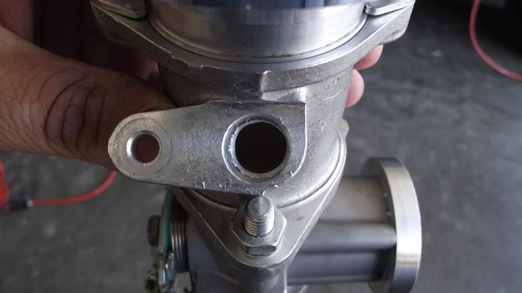

so i just recieved my RC 370cc injectors from but now the problem. they will not fit into the injector jacket of my OBX ITBs.
this is what it looked like prior opening them up.
Sensitive content, not recommended for those under 18 Show Content

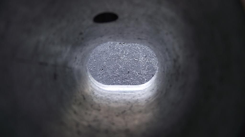

well i'm done, right? nope. if you see it's was bored uneven. again probably the jig slip ot the machine needs to be recaliberated.
so i had to open it, really do more work to the right side to open it up. now here's the seat worked. i have to clean it with a 60 grit but it's done.

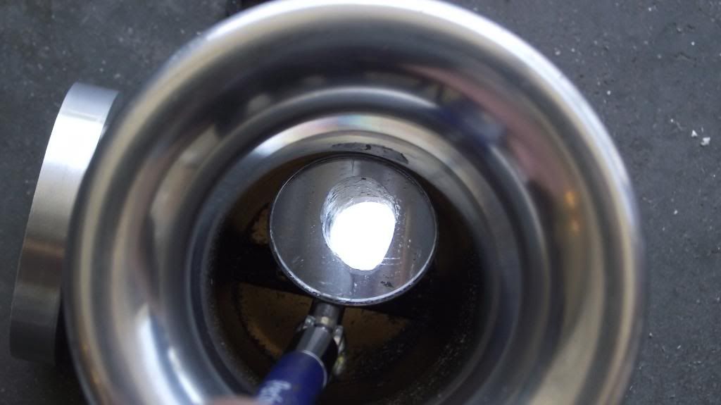

so since im a pipe welder i need to have mirrors to see my root here's me using one of my mirrors to inspect he inside of my work.

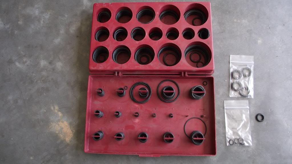

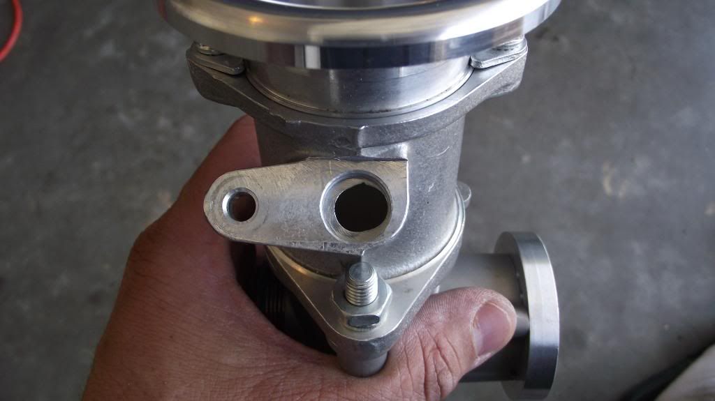

so here's another problem i encounter. if look over to the right you see a single rubber gasket. which came with the obx.. it won't fit, neither the ones RC sent with my injectors. no problem, Harbor freight to the rescue...
and now the injector sit proper and center.
one last thing i need to do is to hit it hard with the air hose make sure all shavings are gone.
