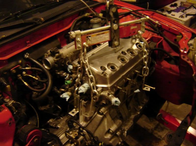

Engine all hooked up to the hoist. Only two mounts remain.

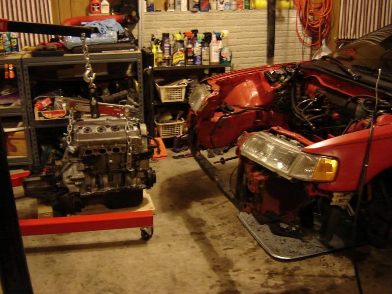

Engine and tranny are out. Time to clean!!!

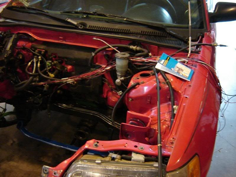

At this point I got sidetracked and decided it was time for a partial wire tuck.
Wires have been extended.
And labeled.
My wiring chart. Gotta stay organized!!!
Then I took off the passenger fender and got sidetracked again!!!

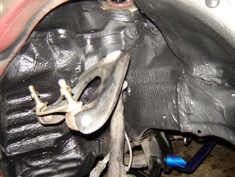

The factory undercoating was old and worn. After scrubbing it down I resprayed it with some Rustoleum Proffesional Grade Undercoating.
http://i36.photobucket.com/albums/e34/SilentWrath/wireslabeled.jpg
'91 CRX Si
2,158 Posts

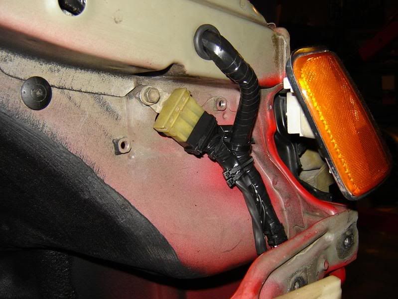

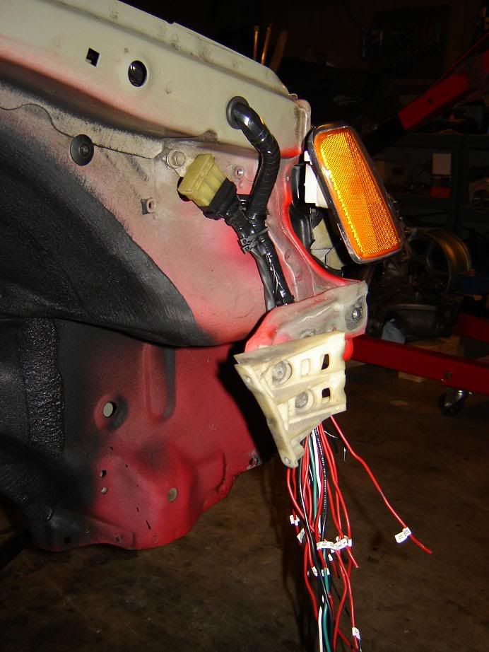

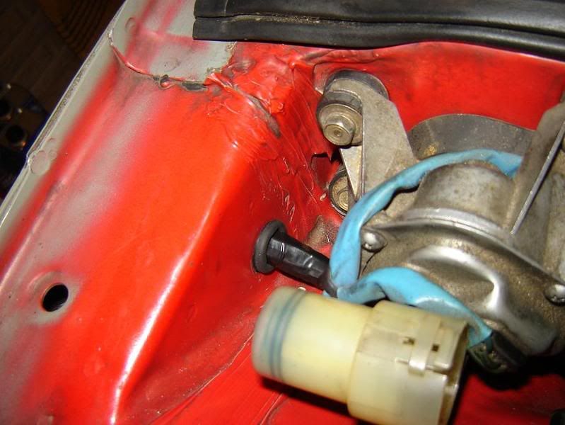

After drilling out a factory hole I was able to fit this grommet in and route the wiring into the fender here under the wiper motor.
I ran the wiring through the channel behind the fender and drilled out another factory hole to fit a grommet where the wires pop out.
Here's a close up to show how it's all mounted. I used an adhesive zip tie base to hold the wiring close to the car.
Headlights connected.
This is where I decided to stop for the night. Hopefully I can get a little work in tomorrow cause I probably won't get much work in this weekend. Monday-Wednesday next week is when I can really dive into it again.
Until Next Time...:bigok:
'91 CRX Si
2,158 Posts
Discussion Starter · #5 ·
not bad on the tuck... but why not use some heatshrink and then teckflex to cover the wires as opposed to electrical tape?
This is the first time I've "tucked" anything, and the partial tuck was decided on a whim. If it had been planned and I could have researched it more I may have ordered some supplies for it.
Right now I'm just working with what I've got and figuring it out as I go along!!! :bigok:

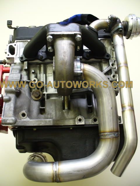

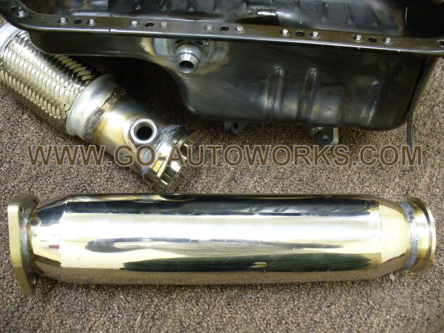

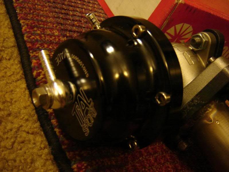

Garrett T3 .42/.48 turbo - Cast mani - 2.5" SS Go-Autoworks DP, WG elbow, and dumptube - Tial 38mm WG
2.5" Go-Autoworks Aluminum upper coldside piping - Synapse BOV - eBay IC - 2.5" SS resonator (cat replacement)

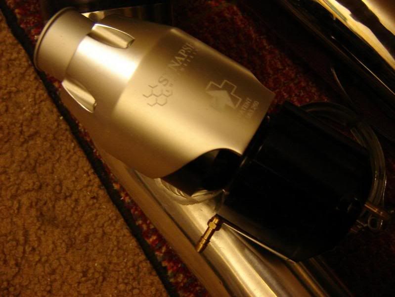

Synapse Engineering Synchronic BOV closeup
TiAL Sport 38mm WG closeup

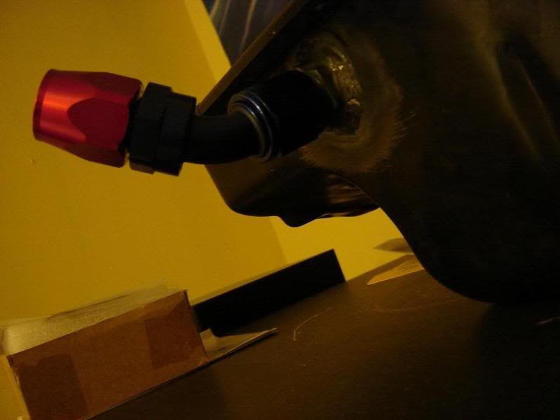

Oilpan closeup

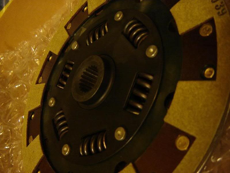

Action Clutch 1KS

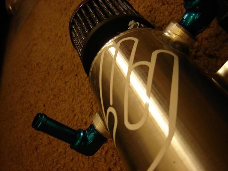

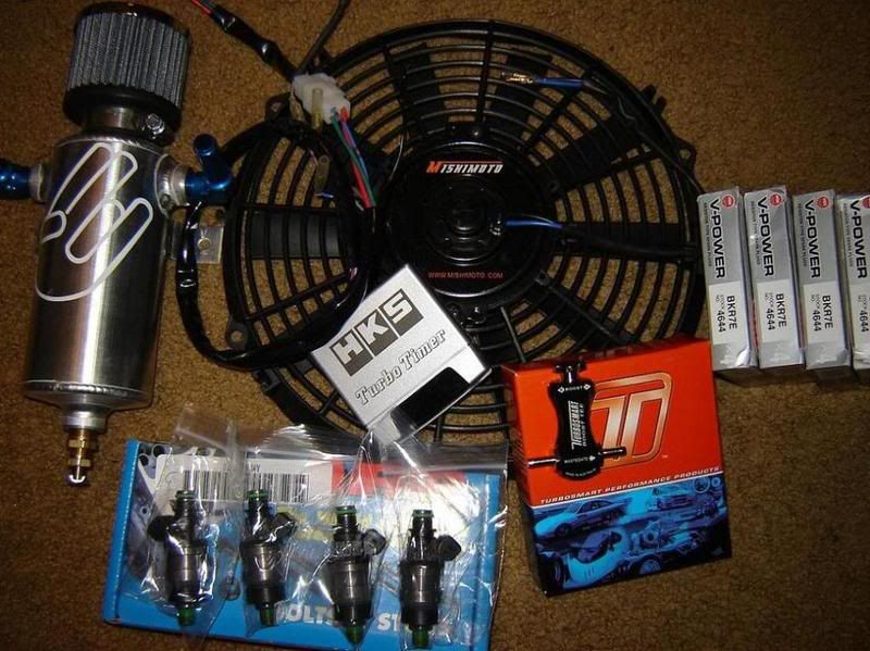

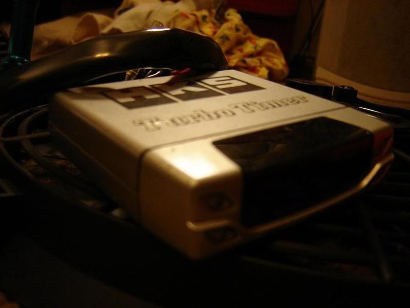

Mishimoto slimfan - shocker catchcan - NGK BKR7Es - HKS turbo timer - Turbosmart boost controller - ARP headstuds - DSM Injectors
Shocker catchcan closeup
TurboSmart boost controller and NGK closeup
HKS turbo timer closeup

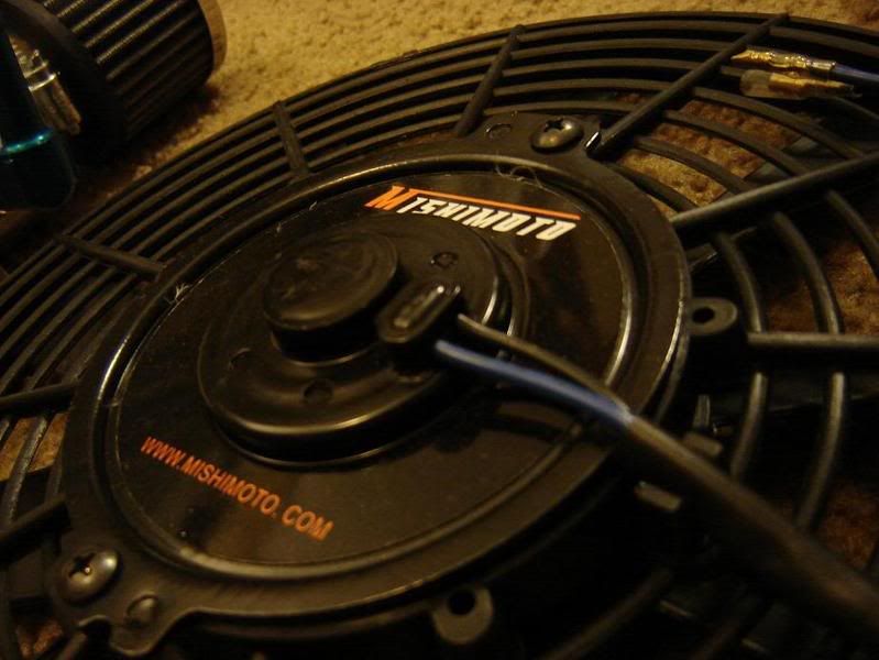

Mishimoto slimfan closeup

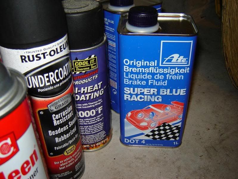

ATE Super Blue Racing brake fluid - Thermo Tec Hi-Heat Coating - Rustoleum Undercoating - CRC Brakleen

With that said, I had a little extra time to finish masking off the drivers side wheelwell and undercoat it.
While I was at it I cleaned the corrosion off the upper and lower battery brackets and sprayed them with undercoating as well.
The wrinkle black finish should look nice under the hood.

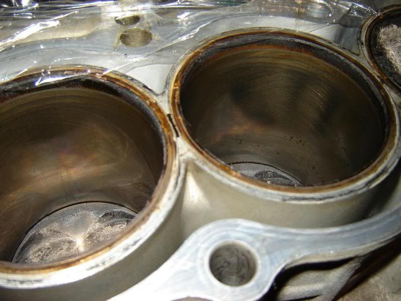

I also split the engine and transmission, and removed the old clutch/pp/flywheel.
