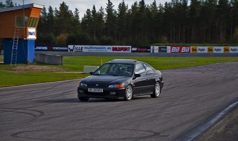

Ok, maybe it's time for me to show my car aswell. I'm updating this front page as I go along.
Specifications are as follows:
1994 LSi Coupe (basically same as your DX, with D15B7 engine), swapped to:
Engine:
- D16Z6 SOHC VTEC swap (150 whp / 112 ft.lbs.tq)
- 0.5mm overbore, total displacement 1612cc.
- Endyn "Roller Wave" NA (Mid) 75.5mm pistons. Theoretical compression: 12,2:1
- Crower Stage 3 cam, valve springs and titanium retainers
- Head prepped by Endyn ("stage 2" porting, bronze valve guides and 3-angle valvejob)
- Endyn race valves (Intake: stock size Exhaust: 0.5mm oversize)
- Magnecor 8,5mm spark plug wires
- ARP head studs and rod bolts
- Fidanza 7lbs flywheel
- Exedy Stage 1 clutch (upgrade)
- Edelbrock Performer X intake manifold

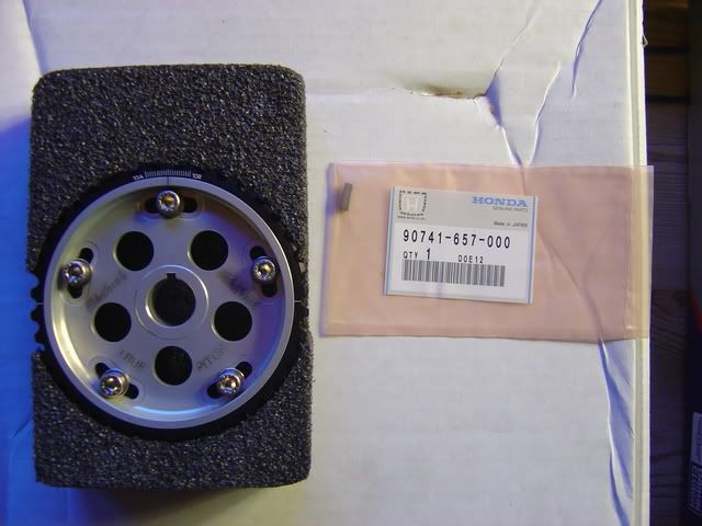

- Edelbrock cam gear
- 60mm throttle body
- AEM V2 Cold Air Intake
- AEM Tru-Power underdrive alternator pulley
- B&M fuel pressure regulator
- No name fuel pressure gauge
- Bisimoto Engineering 4-1 header
- SMSP 2.5" universal catalytic converter
- GReddy EVO2 60mm B-pipe
- Spoon Street gen.1 muffler
Engine management/monitoring:

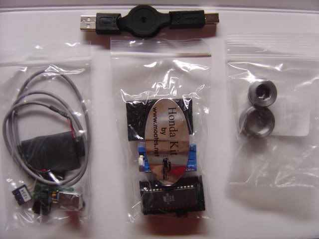

- P28, socketed and added datalogging (USB)
- Crome Pro used for tuning

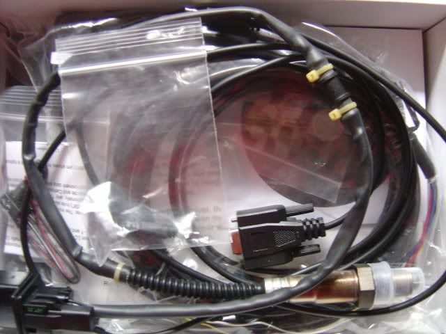

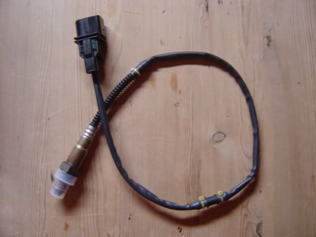

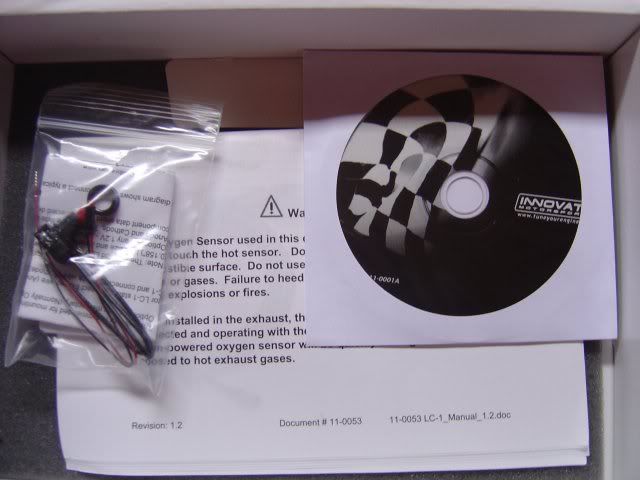

- Innovative Motorsports LC-1 wideband o2 w/ built in controller
- Moates Ostrich ROM emulator
- Oil pressure, oil temperature and coolant temperature gauges (Auto Meter Cobalt, mounted in radio slot)
Drivetrain
- 3rd and 4th gear from D16A9 (1.346 and 1.033 ratios)
- mFactory 4.9 Final Drive
- OBX Limited Slip Differential
Suspension/Bracing:
- Shocks and springs: Koni Sport kit
- Anti-sway bars: Whiteline 24mm / 22mm
- SPC upper control arms w/camber adjustment (front and rear)
- Whiteline caster kit (+1.90 degrees)
- mFactory Roll center adjusters (Long ball joints)
- Energy Suspensions and SuperPro polyurethane bushings
- Tower bars: PasswordJDM 2 point (front and rear)
- Front Subframe rod from Integra Type R
Brakes
- 262mm front and 239mm rear discs
- Russel stainless braided hoses
Steering:
- Steering rack from Integra Type R
- Power steering removed
Exterior:
- Repainted Granada Black Metallic Clearcoat NH-503P (original color) in 2004
- OEM Civic lip and splash guards
- Amber corners and oem lights
- Spoon style mirrors
Wheels and tires:
- 15x6.5" SSR RF-Pro
- 195/50-15 Toyo Proxes R888
Interior:
- Stripped interior
- JDM VTi instrument cluster
- Cobeau Sprint bucket seat (driver)
- EDM Civic VTi seat (passenger)
- HOP Honda center console and armrest
- Momo Corse steering wheel
- Skunk2 Billet Shift Knob, 10th Anniversary Edition
- Fast Line Performance Racing Shifter
- Replica Mugen pedal covers
And a video from a track meet I went to on September 26th, 2009:

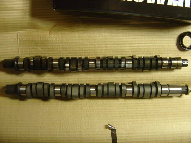

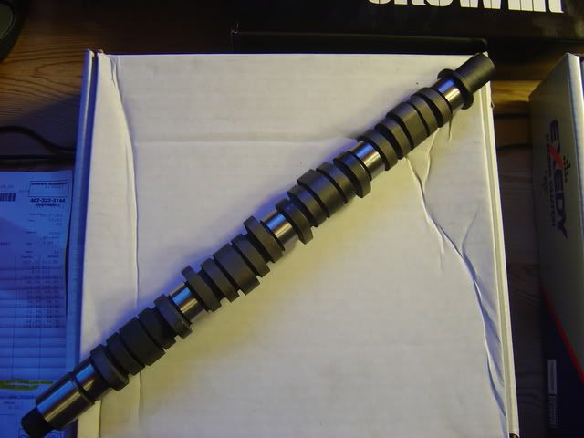

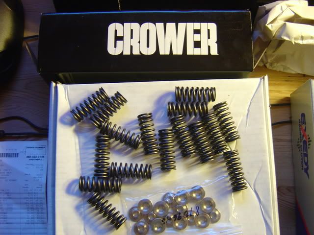

- Crower stage 2 cam, valve springs and titanium retainers.

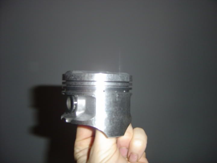

- P29 pistons, for a comp ratio of about 12:1.

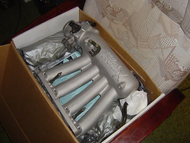

- Edelbrock Performer X IM with 60mm TB

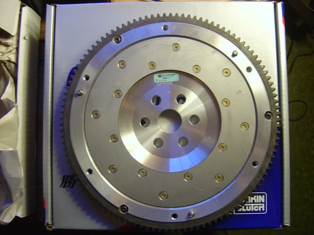

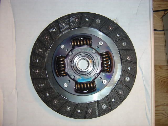

- Exedy stage 1 organic clutch and Fidanza 7lbs flywheel.

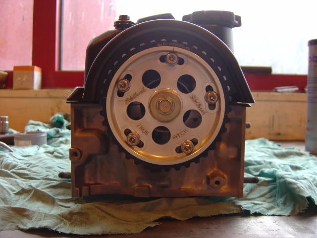

- Edelbrock adjustable cam gear

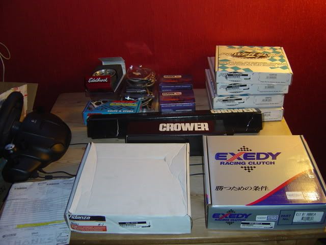

I have now paid for a shipment coming to me all the way from TunersChoice.
It contains:
- Crower stage 2 cam, valve springs and retainers.

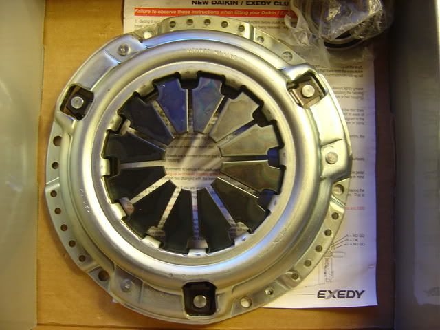

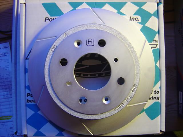

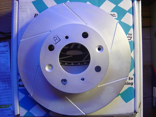

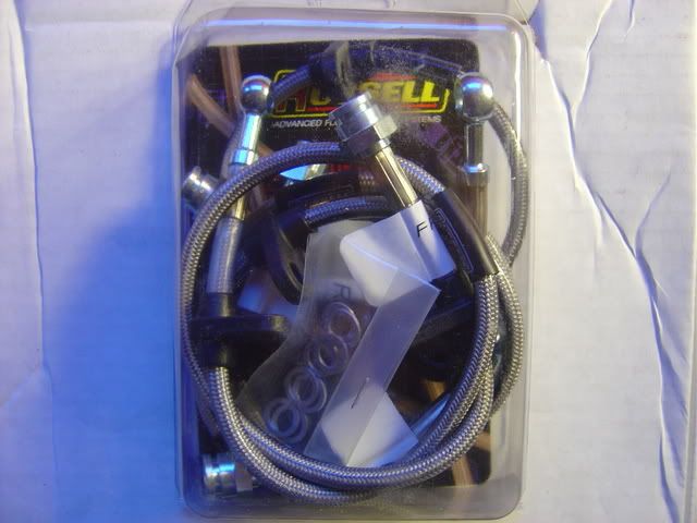

- Powerslot brake rotors all around

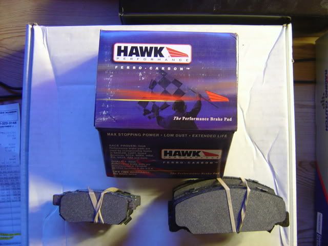

- Hawk Performance brake bads (also all around)
- Stainless steel brake line kit.
I'm hoping to get the motor done by this summer ends, so I will need to pull the rest together soon.

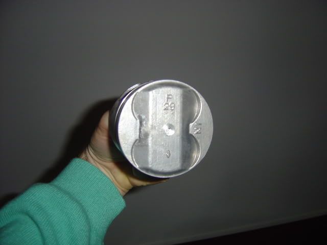

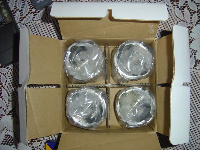

- Replacing the pistons, for some fine P29s.

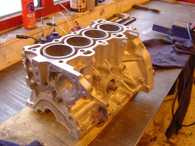

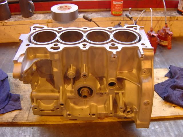

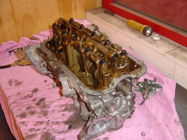

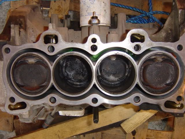

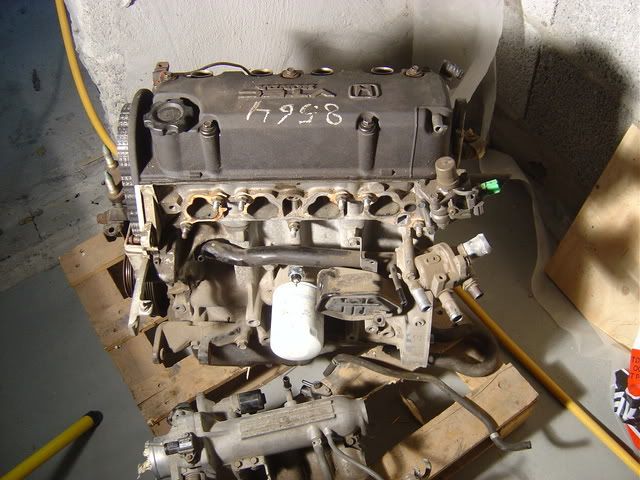

Some progress has been made, but no cool pictures.

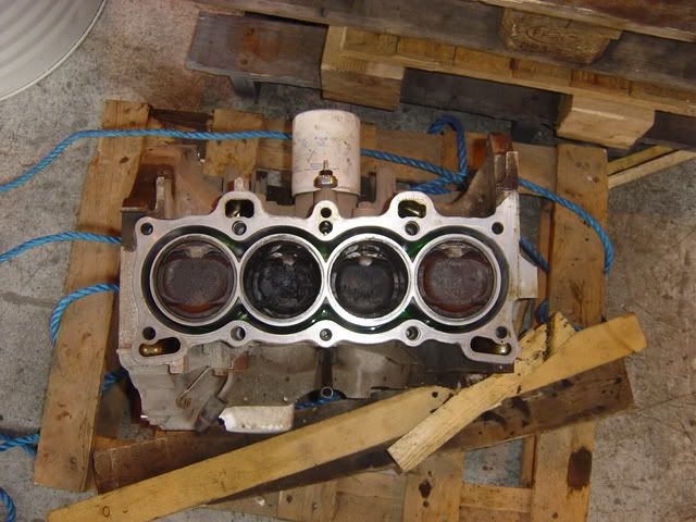

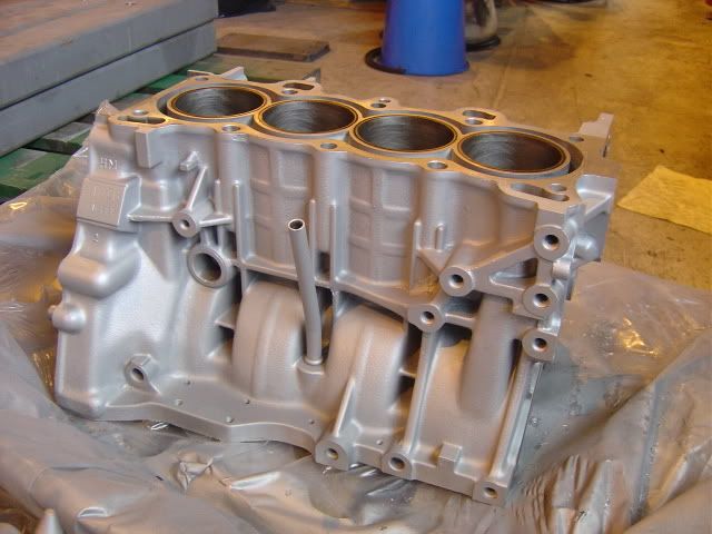

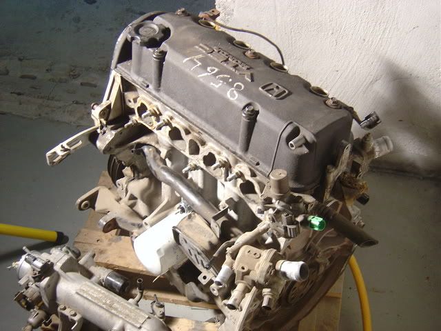

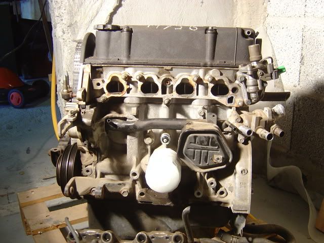

The entire engine has been dismounted, and I've started to clean the parts.
Getting the block nice and shiney isn't too easy.
Used hot, high-pressure water today, but didn't get any more off.
Any tips, good people?

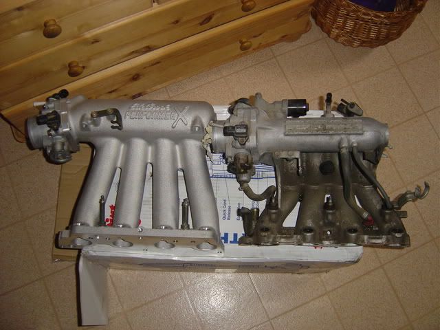

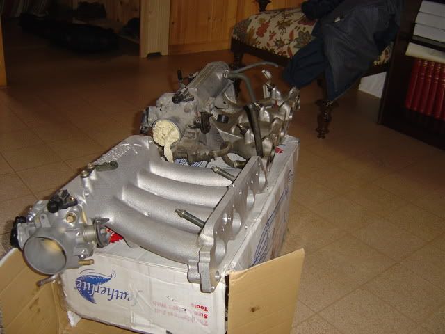

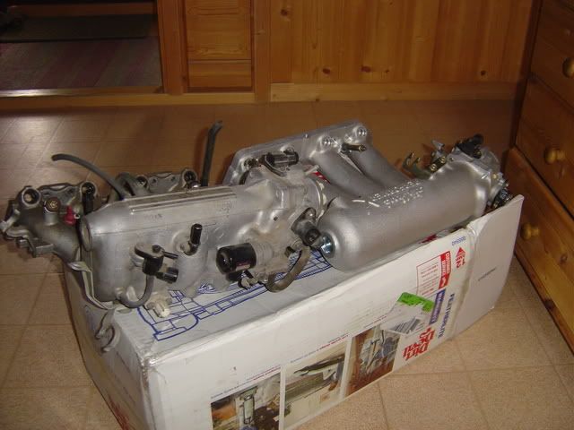

Also, I have just bought an AEM V2 CAI. Just to make sure everything is good on the way in.
Going through a 60mm TB into an Y8 Performer X, I think it will be good.
(The reason it's for Y8, is that it was available here on the forum. Hope it doesn't make me any problems)

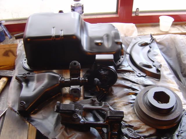

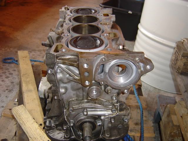

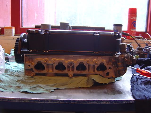

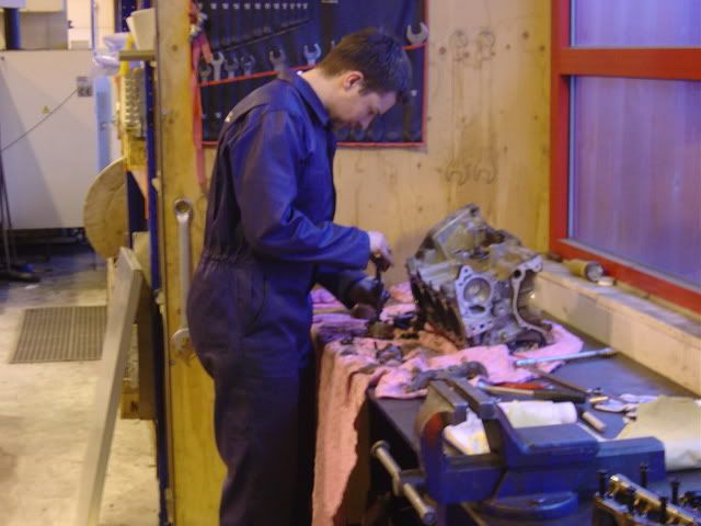

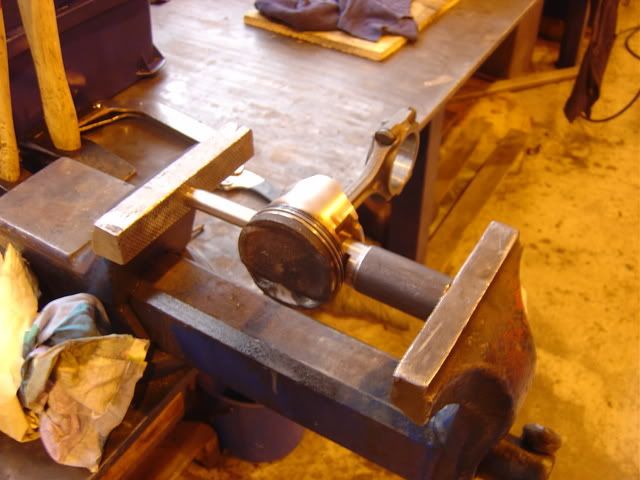

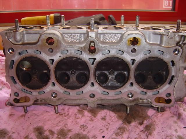

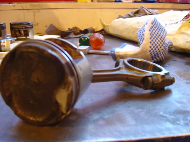

Ok, so here's what I did today:

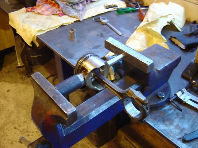

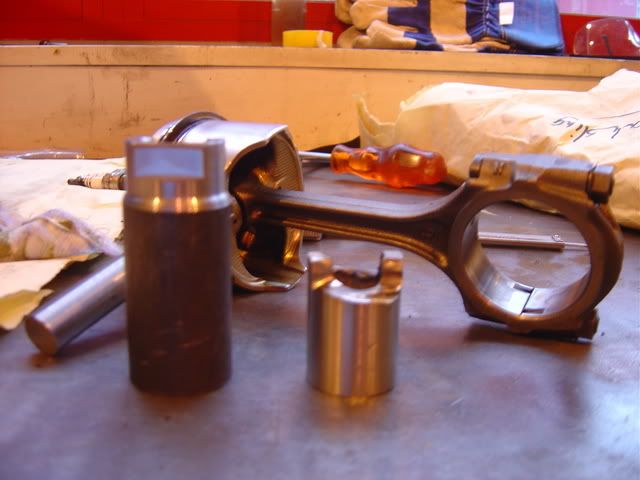

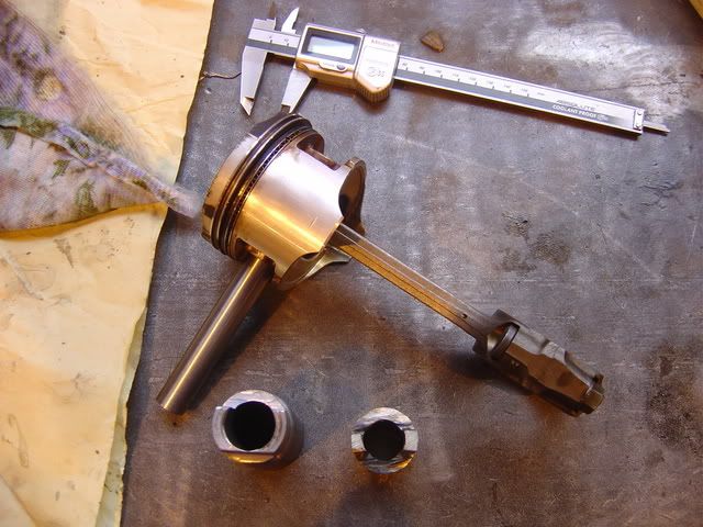

- Pressed out the piston pins (Check out my special tool, made by a guy at work He's good at his stuff!)

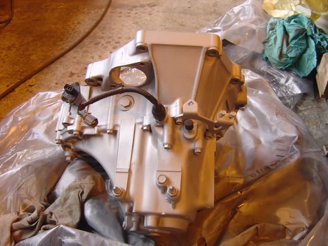

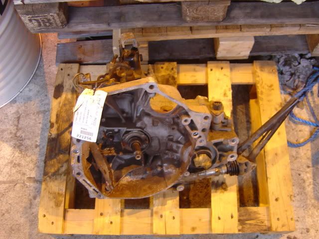

- Started preparing the tranny for bead blasting.

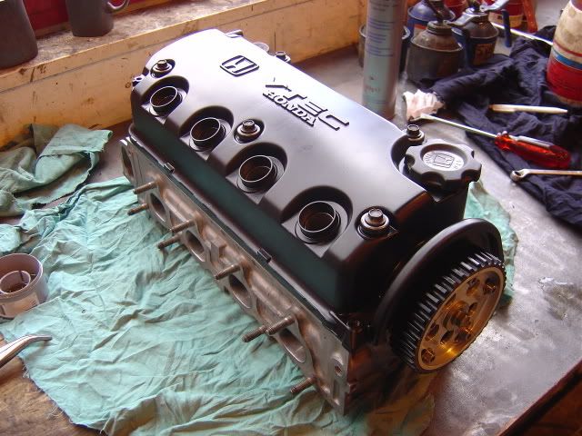

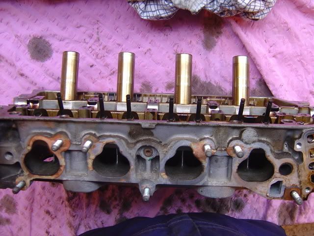

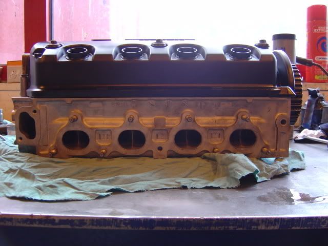

- Started cleaning the head. Thinking of bead blasting that too. Any objections?

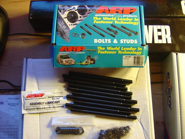

ARP Head Studs

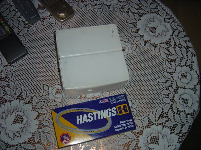

Nippon Racing P29 pistons with Hastings rings

Powerslot discs front and rear

UberrData Modification Kit (for chipping the ecu) and an extra chip (eeprom)
LC-1 Lambda Cable (wideband o2 sensor with controller built into cable)
HondaLog (usb cable to use for datalogging)
Willem 3.1 chip burner
