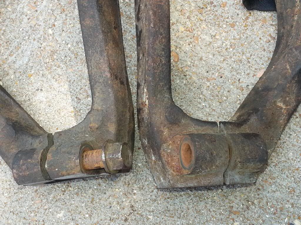

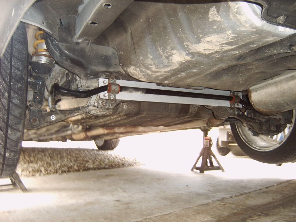

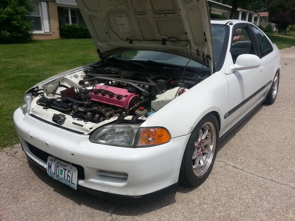

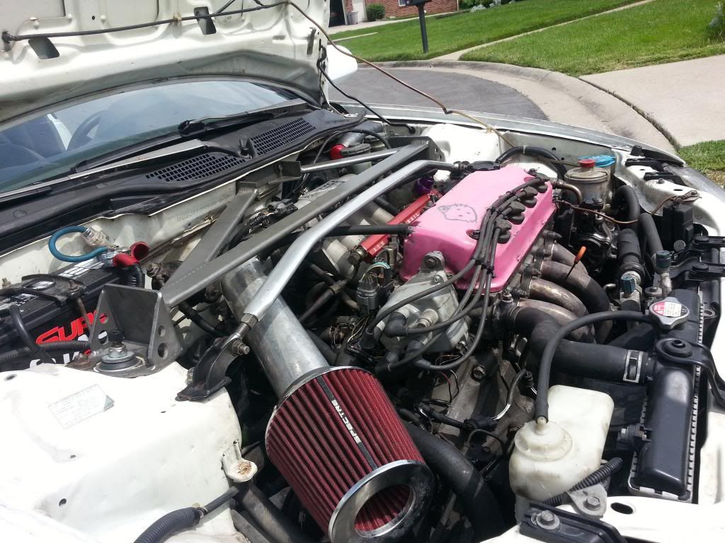

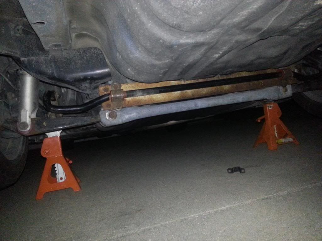

pic selects 10/8
chopped front strut forks lowered 1/4 in so I could preload springs more
ceramic front brakes
all es bushings even front lcas
itr rear sway with custom mounting bracket and adjustable endlinks
custom rear tie bar
2 custom rear strut bars
3 point strut bar
custom uca brace made a world of difference took an ebay strut bar and cut the ends off other than the one hole and fit perfectly
lower h brace
arp extended studs
those evo onstar antenna things
nitto neogens 205 50 15
15x7.5 +30 wheels
before it got rusty
