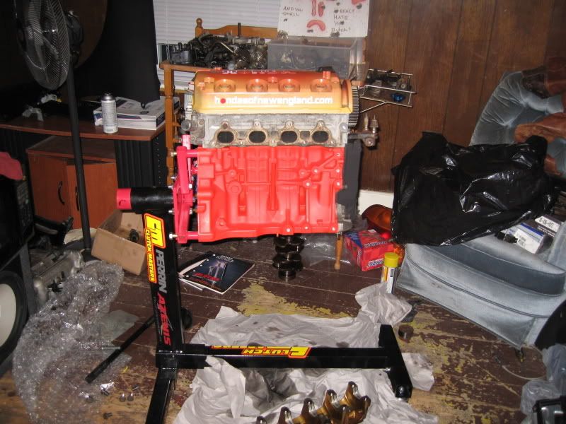

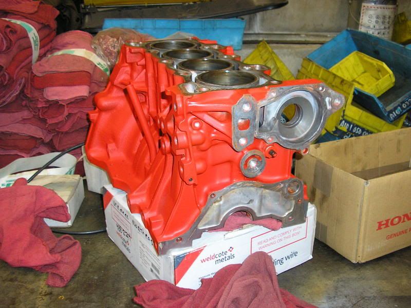

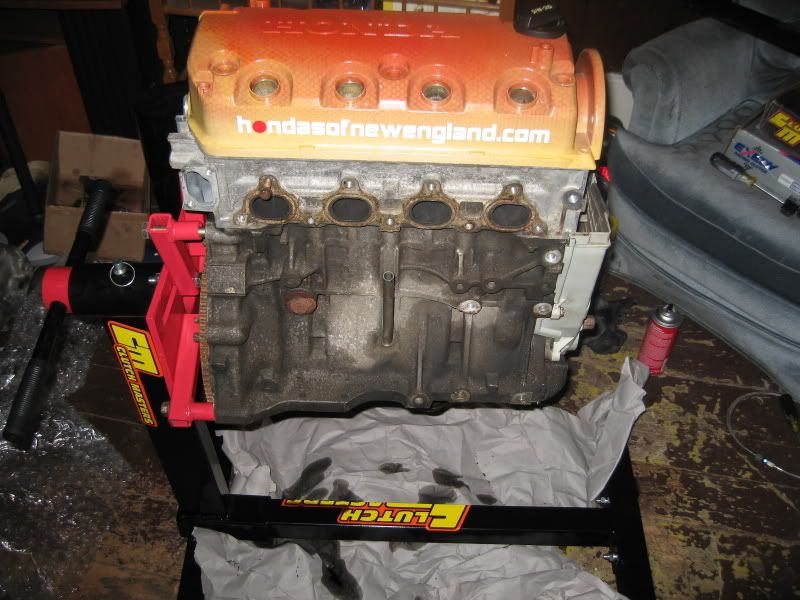

So my girlfriends D16z6 is on its last leg, her del sol has had soo many problems, and there all fixed aside from her dumpy ass motor with 250k + miles on it. I did a headgasket timing belt, clutch, flywheel, headswap, new valve guides. . . to no avail, its a bag of ass, so I have decided to be a great boy friend and build her a mild N/A engine until I can k-swap it for her like she wants. F-the stock boar im going oversized to make sure everything is sealing properly and no more MADD VTECH YOoo blue cloud of doom.
Parts list: HAS CHANGED SINCE THREAD WAS CREATED!!!!
D15b7 Short Block (under construction)(getting board over 1mm)
D16z6 Head (will rebuild before installing)
Bisi level 2 camshaft
Bisi springs / retainers
Bisi cam gear
D15b7 pistons (new)
D15b7 rod's
ARP rod bolts
ARP head studs (use z6 studs?)
cometic head gasket (might go a bit thicker than stock)
What I need:
1. Reliability
2. Little bit of power gain (id like to see 100-110 right now it feels like 25whp)
3. Has to run on cheep ass pump gas since the prices are astronomical at the moment. (so no super high compression)
dose this sound like its do-able, and what should I take note of? yes ive built engines before, and yes I know this is kind of a scab for the moment, and yes I "could" spend more money and trick it out, but the bottom line is it just has to run reliable, and still be fun to drive :TU:
all insight and views is appreciated and welcome, post away will any thoughts or ideas.
