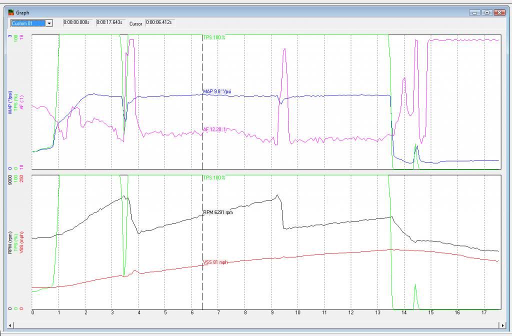

You dont need a clutch switch to flat-shift. You just need to do it close to the rev limiter and do it fast.
Ive never actually driven a car with no-lift-shift enabled with the clutch switch.
Here is a reeeally old datalog of Tw34k driving his Turbo, Vitara, I beam, D16Z6 '97 HX. This car has a disabled cluth switch, so definitely no flat-shifting enabled in the tune:
As you can see, the first shift he doesnt even let all the way out, the TPS is still reading quarter throttle, and the second shift he kept his foot flat on the floor. Even when partial throttle shifting the MAP sensor never read any vacuum, and when flat shifting the car stayed basically at full boost. That dip is tiny, and only lasted for a fraction of a second.
This log would look the same with a lightweight flywheel, only the shifts could have been even faster because of the rpms dropping faster, and the car would just be overall faster due to less rotating inertia.
