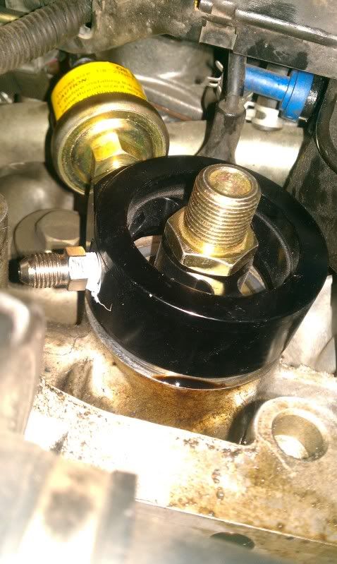

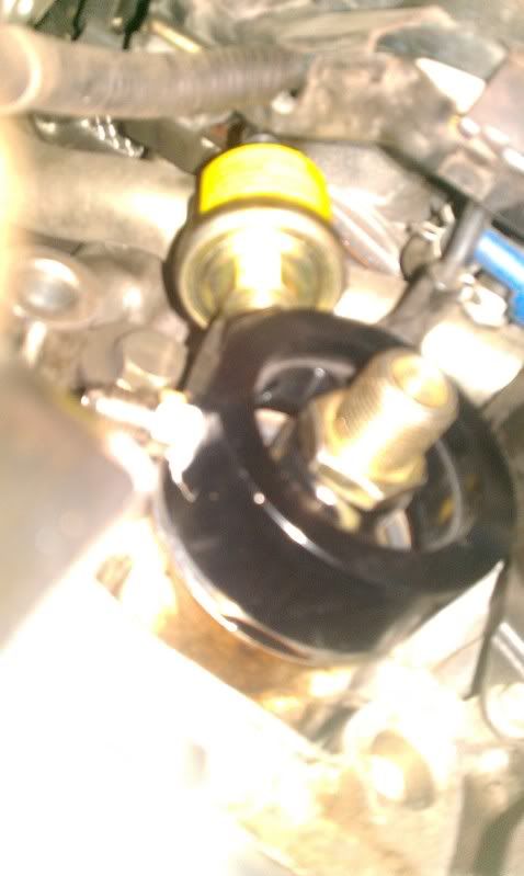

Hey guys I was changing my oil the other day and decided to test fit my sandwhich adapter,there's no way it fits with my oil pressure fitting attached.the oil pressure fitting hits the water pipe on the block, then if I move my plugs around on the sandwich I won't have room to put my oil feed line on so what should I do? Is there a fitting I can buy that will move the oil pressure sensor?

I has a similar issue with mine. I just had to go another route.

why cant you just rotate the oil sandwich? it doesnt thread, the center bolt is what threads

Ya I was thinking about a 90 degree fitting, I need a not fitting right? My gauges and oil sandwich are all from glowshift.I tried rotating it, its the big as oil pressure sender unit that doesn't have room to move.I would like to stay away from extra lines as that's more chance of oil leaks

I guess I will have to try the feed and oil pressure sender on the top and plug the side .I'm well aware of the chances I'm taking. I take care of my oil so I'm not worried about it
