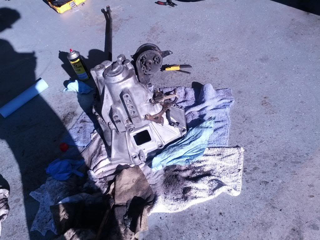

If you've read the entire thread you'll know that I've been suffering from a 3rd gear grind ever since I rebuilt the tranny. In addition to this, it seems to have begun to leak oil. I wasn't sure if it was from my piss poor RTV sealant job (or choice of sealant used) or if my axle seals just decided to die. Either way, I had an OEM replacement synchro supplied by transzex, aka Mista Bone himself and new OEM axle seals to throw in there.
Here it is, I decided not to worry about the shift linkage (aka bitch pin) and just removed everything as a whole. Take a look, FILTHY with grime due to the oil leak!

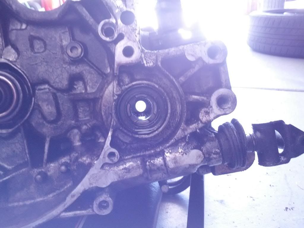

A pic of the MFactory LSD from the outside...
Then here she is, all cleaned up and ready for tear down.

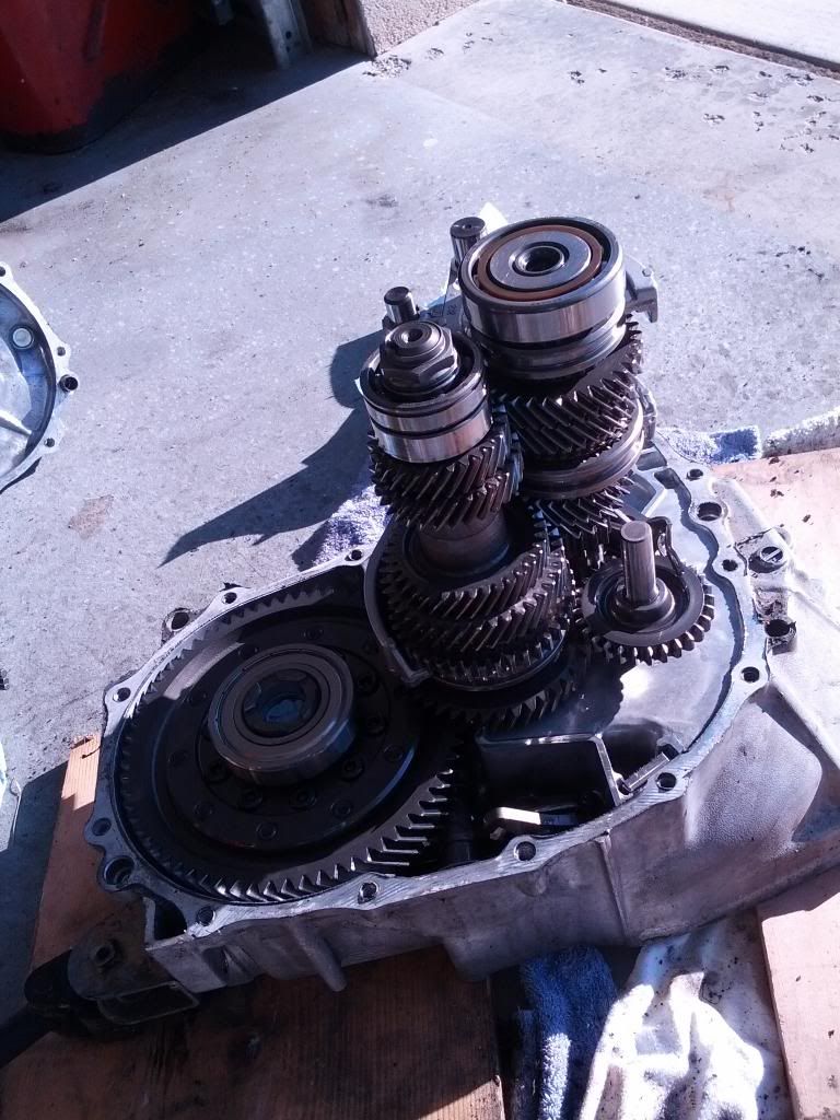

Opened.
Luckily for me, the 3rd gear synchro is located on the mainshaft. This means I could remove the gears with a simple propane torch and a ghetto press (ie a steel pipe and mini sledge hammer from home depot :p ). Upon lifting the main and counter shafts, I got a good look at the counter shaft needle bearing. Apparently my stakes held up, and the bearing hasn't walked out at all. No scoring. Nice. Anyway, after removing the old synchro, and installing the OEM replacement, I decided to take a closer look.

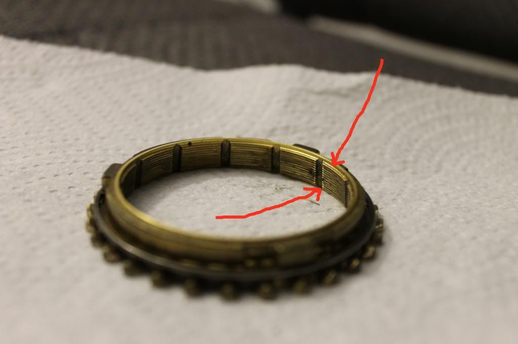

Here we go... You'll want to click to view full size on this one...
...if you look very closely, you can see that the inner ridges are somewhat flattened. The OEM brass Bone sent to me did not look like this. Obviously this thing wore down FAST.
Anyway, I replaced the axle seals, cleaned the mating surfaces of the case, and applied some Ultra Grey RTV sealant, designed for high torque applications, in hopes that it will hold up better than the black stuff I used before.
I finished installing everything last night and took it for a spin. Guess what? 3rd gear grind is gone. In fact, it now feels like 3rd gear is my best gear, in terms of shifter feel.
So.... Guess what the moral of the story is? Yup, you got it -- DON'T WASTE YOUR MONEY ON CHEAP AFTERMARKET SYNCHROS!!!
