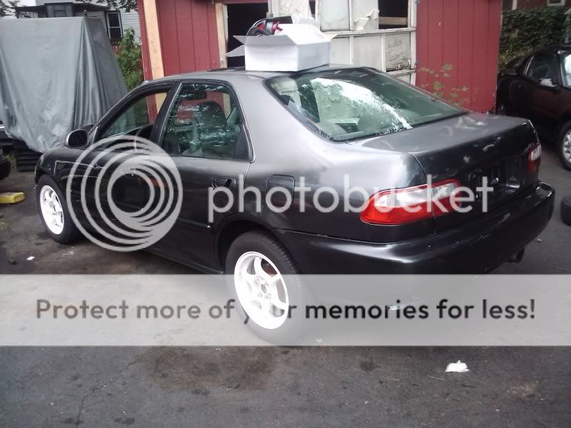

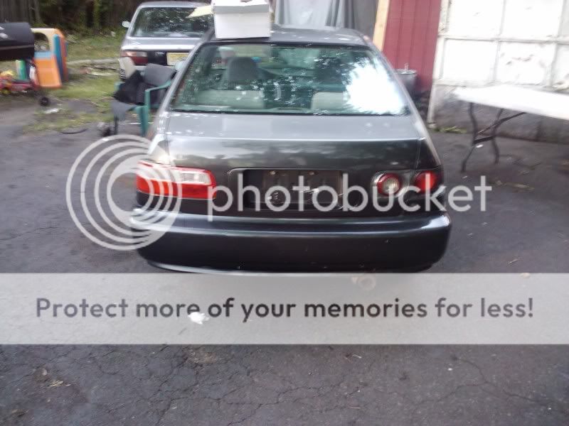

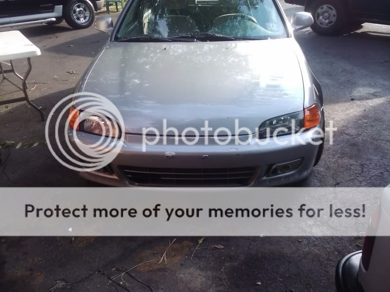

So a little while back I pick up this 94 4dr ex, pick it up for $500 with the intent to use it as my DD. I pick it up with a good running high mileage z6. The only bad stuff with the car was a blown auto, and the interior smelled super rank :-X.
Over the next few days I rip out the hole interior and super clean it. At the same time I started looking around for a cheap auto trans. I couldn't find anything cheap/clean. Also the thought of driving a auto D didnt sit right.
I started to think why not convert the civic and throw my built motor into it since the crx was a long way from getting onto the road. The best part of this was I had just about everything to convert it. So the start of a sleeper started, well onto the pic's.
Day I got it.
Had some 3d euros :-X, I replace with some 50/50 I had around.
Forgot about the 2tone........

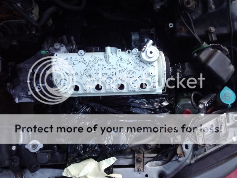

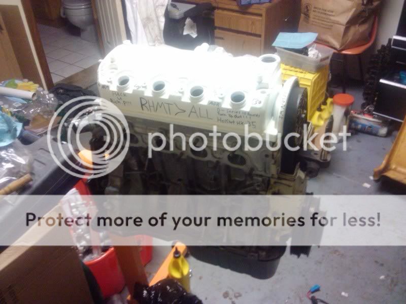

New motor before going in.
You can never have enough blood during a build. While wheel owns :evil:
Motor is in and running, just need newer pic's.

An the motor that I am building. Its a 9v9LD hahahhahaha no its a D16A6
