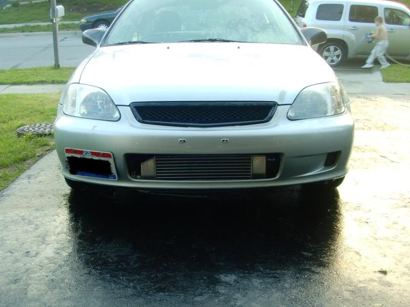

old hotness
new hotness

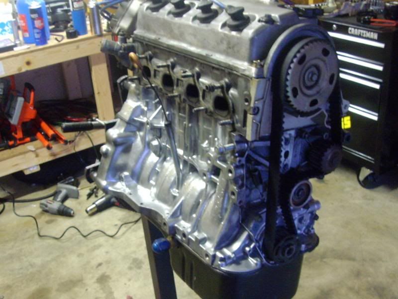

motor setup waitng to go in the car (go autoworks mini-ram kit, garrett t3/t4 57 trim,built motor,zex 53900, blah blah blah)
pulled from the coupe
stripped the block of the red paint.This is a mixture of silver high temp paint in spots I couldn't get and a few hours with the wire wheel.

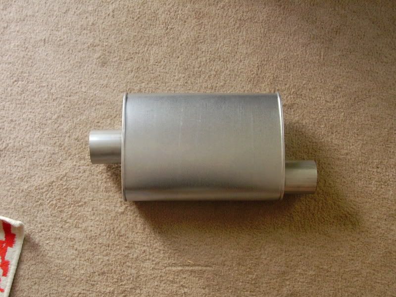

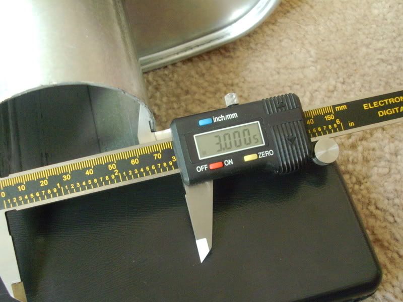

muffler setup (sleeper summit 3 inch turbo muffler)

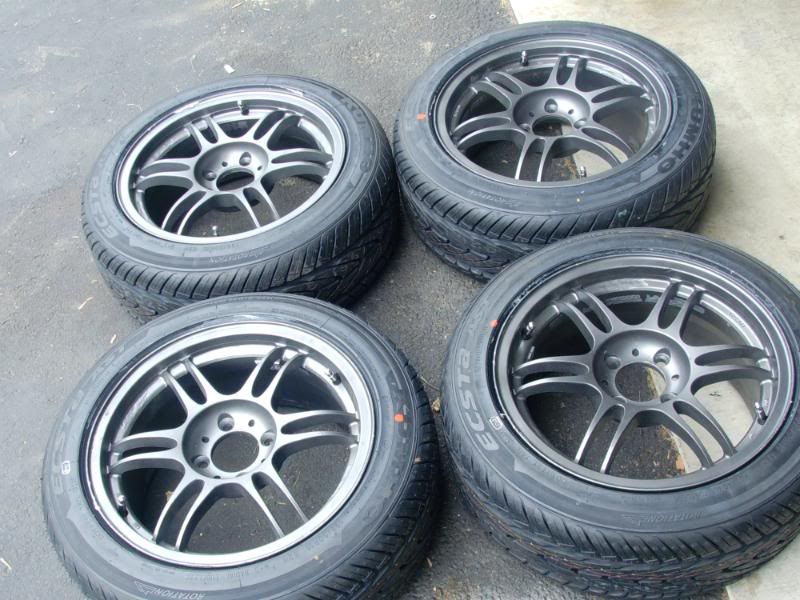

wheel setup kosei k1 ts (not super rare but you don't see them anymore and they are made in japan)

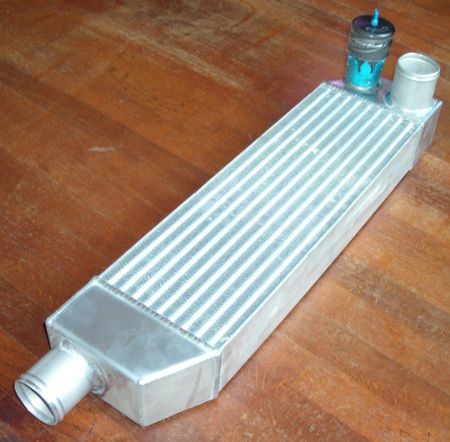

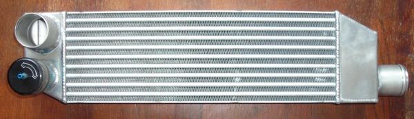

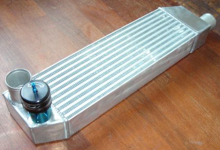

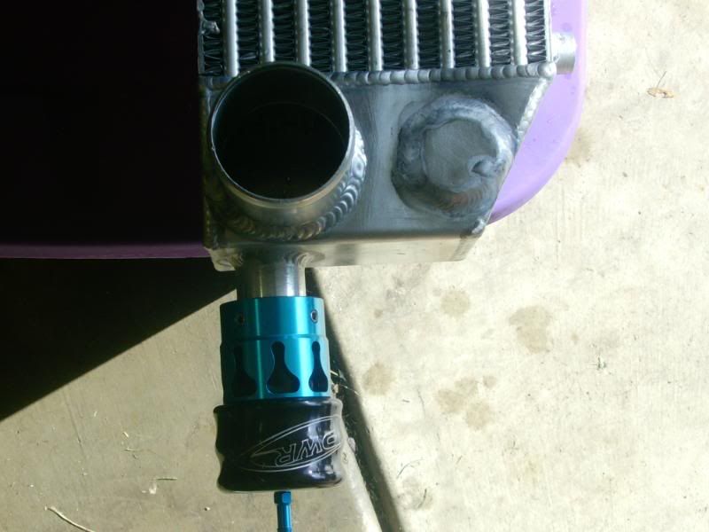

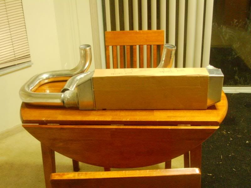

Score1!! just picked this up off honda-tech for a GREAT price
18x6x3 core pwr backdoor intercooler with pwr bov

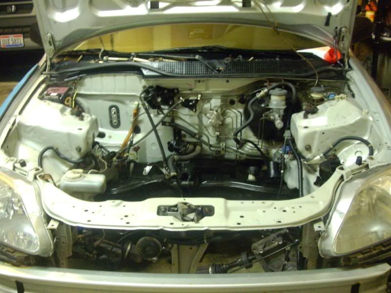

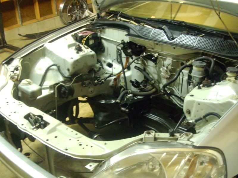

pulled the old motor and cleaned the bay up
another angle
Doing a little prep to the new built motor

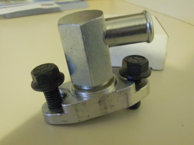

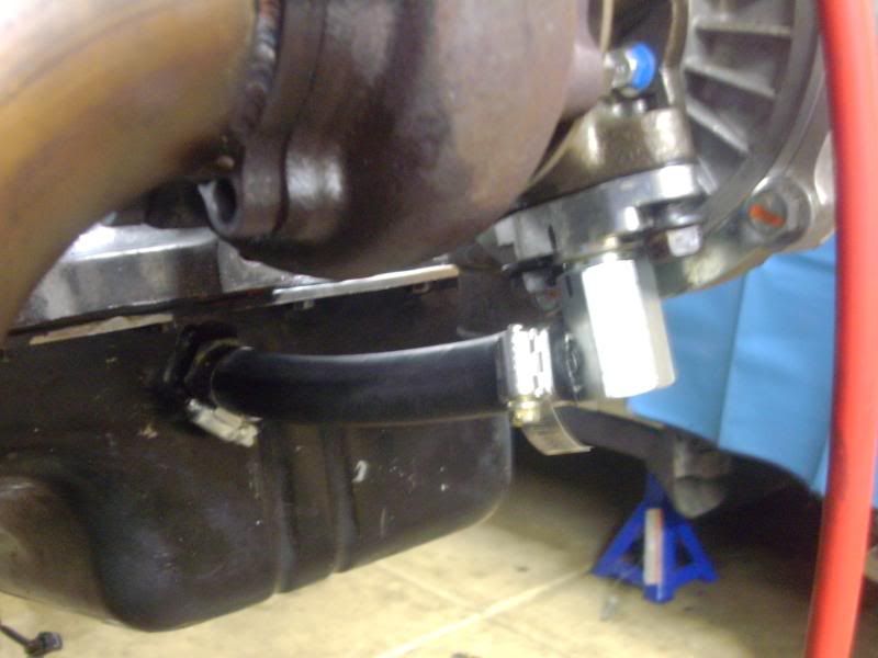

Re did the oil line. I could not get a good angle using push lock AN fittings for the life of me and the old line was crappy so i switched to silicone hose and clamps. This napa heater hose fitting is perfect for this and only like 8 dollars vs an AN 45 or 90 degree fitting that cost 19.99

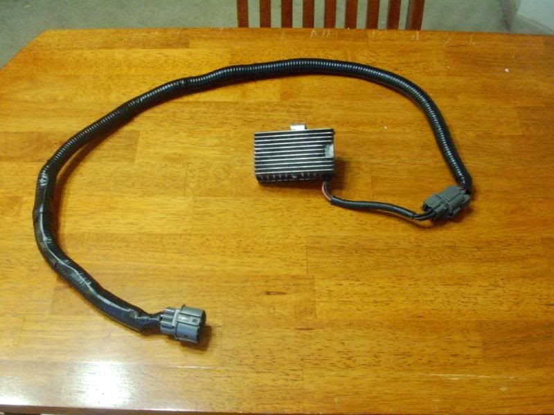

My own diy obd2b plug and play resistor box setup. Plugs right into the deap plug and when I get my fjo driver box all I have to do is unplug it. No hacked wires to fix. Only bad thing is to make this you have to rape and destroy a entire obd1 harness.My friend had one that was cut in half so this wasn't a problem

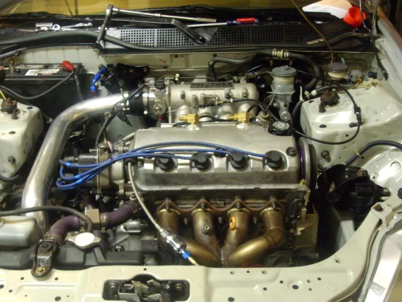

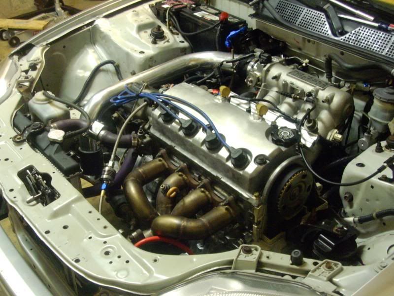

where i'm at now....Should fire up tomorrow or thursday
Some other things I got done but don't have pictures off.
Got the intercooler and piping installed
Got my old walbro 225 pump from the old civic installed
Bought an installed a full obd2b vtec harness so i didn't have to add or do anything to the stock harness
added some more alarm goodies
Things I still need to do/parts im waiting on
Need to move around the bov to the piping
need to get the old bov hole sealed up
need a 2.25 to 2.0 coupler
thats it!!
