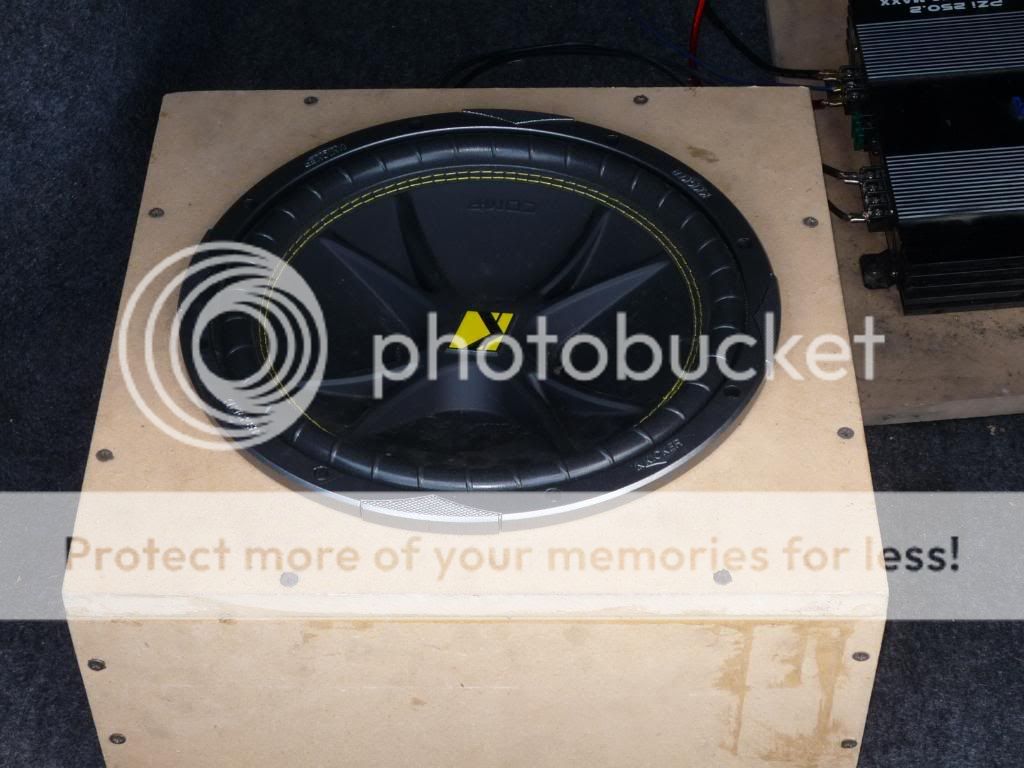

I have a Kicker Comp 12'' sub and didn't want to buy a box so i made one.. check it out, shit slumps too.. made it to the correct dimensions.
Next maybe i'll make a dual 12, w/ port and carpet it. Someday I want to try to make a built-in trunk box and carbon fiber it, that would be sick.

I'm just going to do a 10" sub in a sealed box for my coupe, but I'm definitely going to make the box. civicridin is right, carpets cheap. I have also been looking at some custom fiberglass how-tos. Depending on what you're looking for, that's a pretty cool way to go for a couple of subs on the back.

moAR Screws! or else it will rattle apart....i usually put like 2" apart max
I used wood glue also but, ill keep that in mind for the next box. although I haven't had any problem with this one and i've had it since my last honda.
so its been holding strong for probably about 2 years now lol, although now that you say that I'm going to inspect it to see if its coming apart.

wood screw definetly help, i also find that the enclosure calculator from the 12volt.com helps in making sure you get the right enclosure size for your sub.

Thats actually the calculator I used when making my box.
i prefer a brad nailer, its faster and easier not to split the wood.
That would be quicker. I pre-drilled the holes undersize to avoid splitting, and used wood screws. Probably extra work I didn't need to do.

I think it was about $20 bucks for the Medium-Dense Fiberboard. Was able to have them cut it in the sizes I want. which was sweet because I didn't want to have to cut it. I still have some left over too.. I had the screws and the glue. I didn't take a picture of my terminal post block but I bought it at radio shack for about $7.
Probably wont carpet it, but I'll make a new box that is attached to my accord's trunk, that way it wont move anymore and looks more clean.
