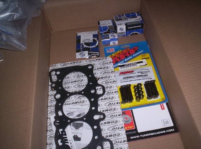

Got some stuff today. Happy Presidents day for me!!!
ACL main, and rod bearings and thrust washer
arp rod bolts
cometic head gasket 76mm .030 thickness
Should be getting my p29 pistons .040 over soon ordered them on friday then its out to the machine shop. Checked what my compression would be on the zeal came out to be 12.28:1
