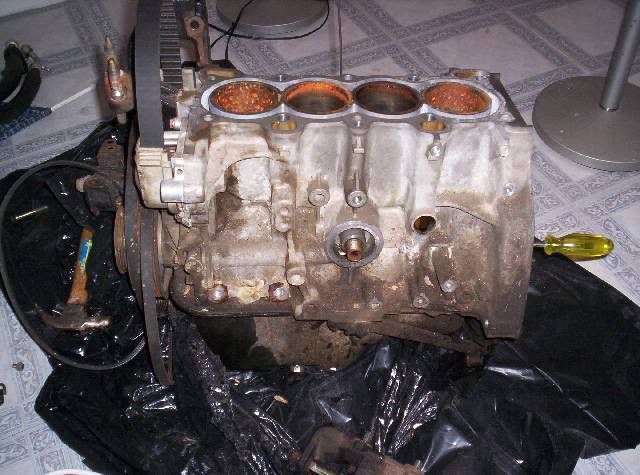

Block
Has been sitting for a while
wont be using this anymore

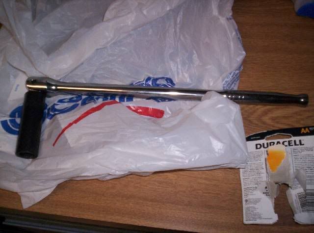

I cant get these off I have broke 3 craftsman 17mm sockets

does anyone have any suggestions on how to get the flywheel bolts off?
try a impact gun or breaker bar. i had the same problem getting mine off and i had to use a breaker bar.
good luck
Impact gun rules! :TU:
tomorrow I will go and get a 1/2 breaker bar and a 12point 17mm impact socket if this does not work im gonna have to go with the impact gun. I decided on going ahead and getting the innovative crossmember http://www.passwordjdm.com/product....History=cat&strKeywords=&SearchFor=&PT_ID=468 so that way I can fit any header I want insted of settling for a 4-2-1 for a ef. Just need that tax money so I can get all this started. I also changed my setup a little insted of going with the 310 injectors I will send my stock ones to rc for cleaning and balancing, I am gonna still get the fuel pump but I will just get the 190lp insted of the 255, and I will save my money on the block guard and get the obx lsd. :)
Breaker-bar with a 6' long cheater bar. Leverage almost always beats out impact tools. And, they break things faster.
