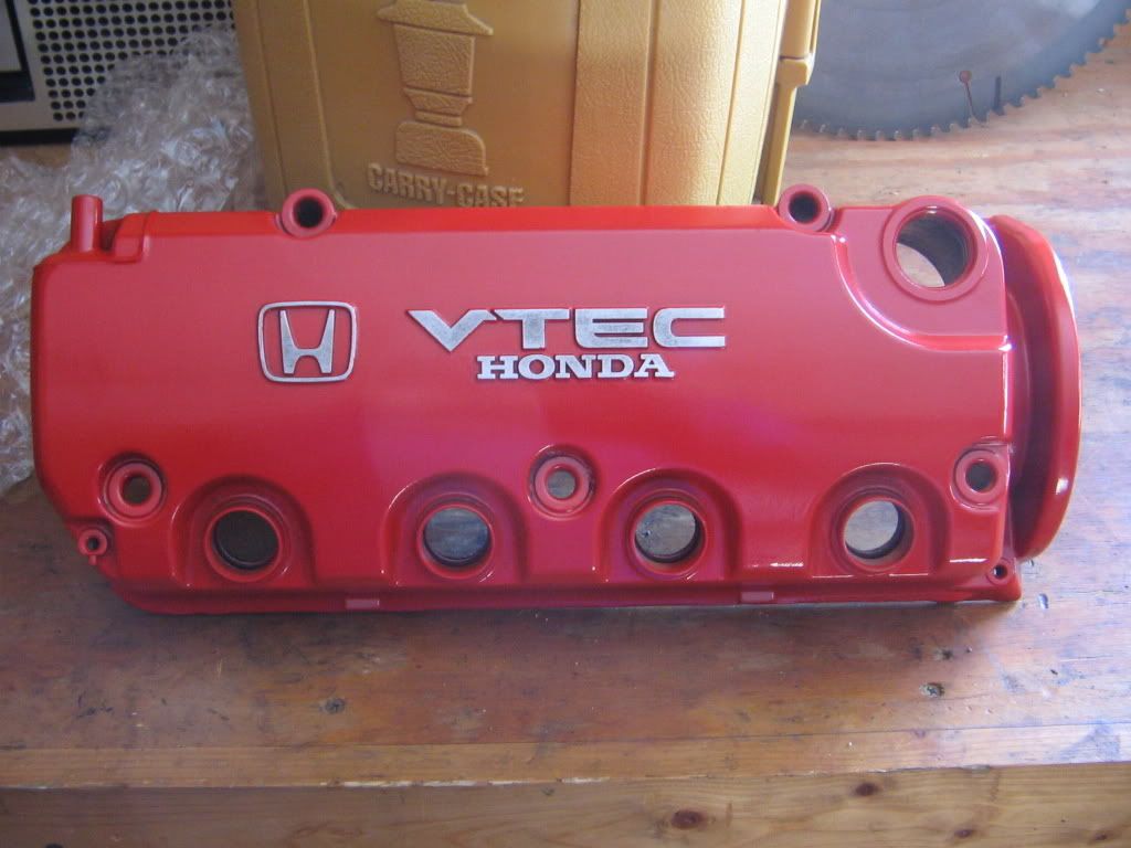

Painted my valve cover.
i dont have a before pic, but just picture a very nasty looking valve cover with chipped paint spots all over and crap looking.
now this..

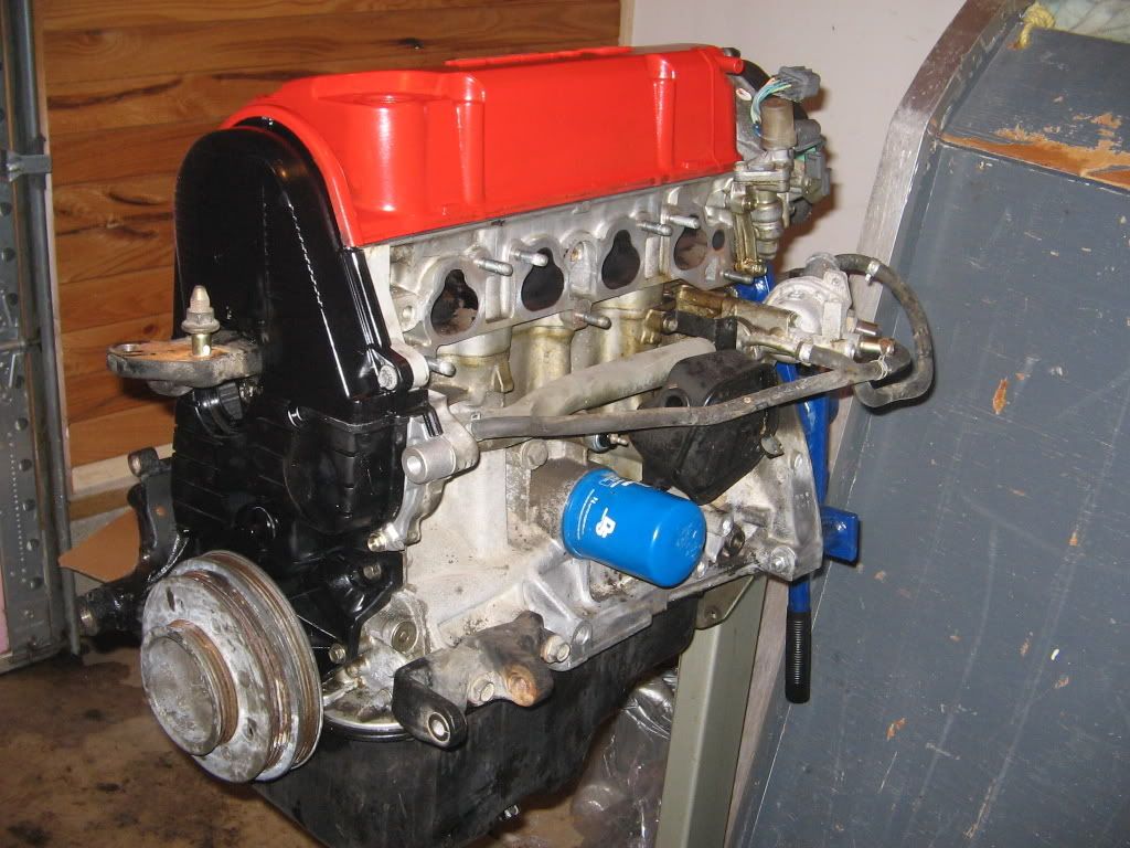

Engine sittin on engine stand.

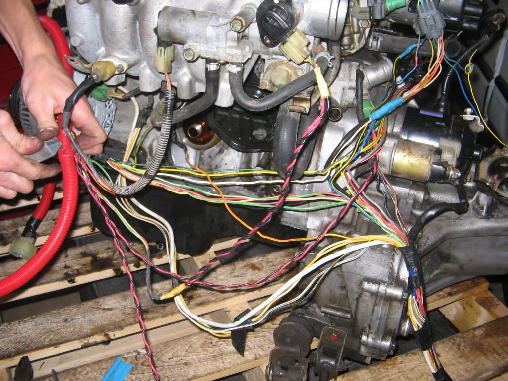

Wiring before...
Wiring after...
chillin, waiting for mounts, and header, then put into my car :)
