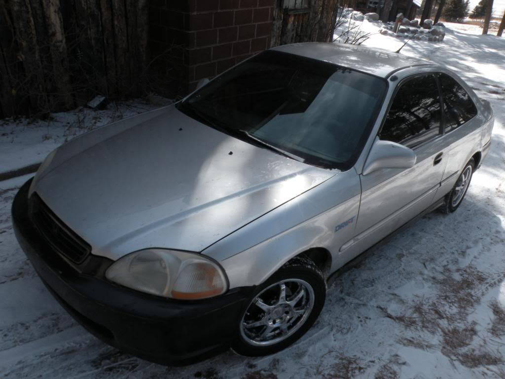

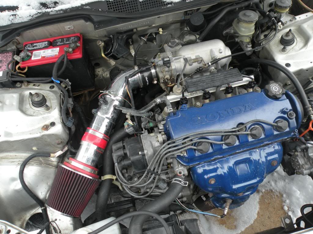

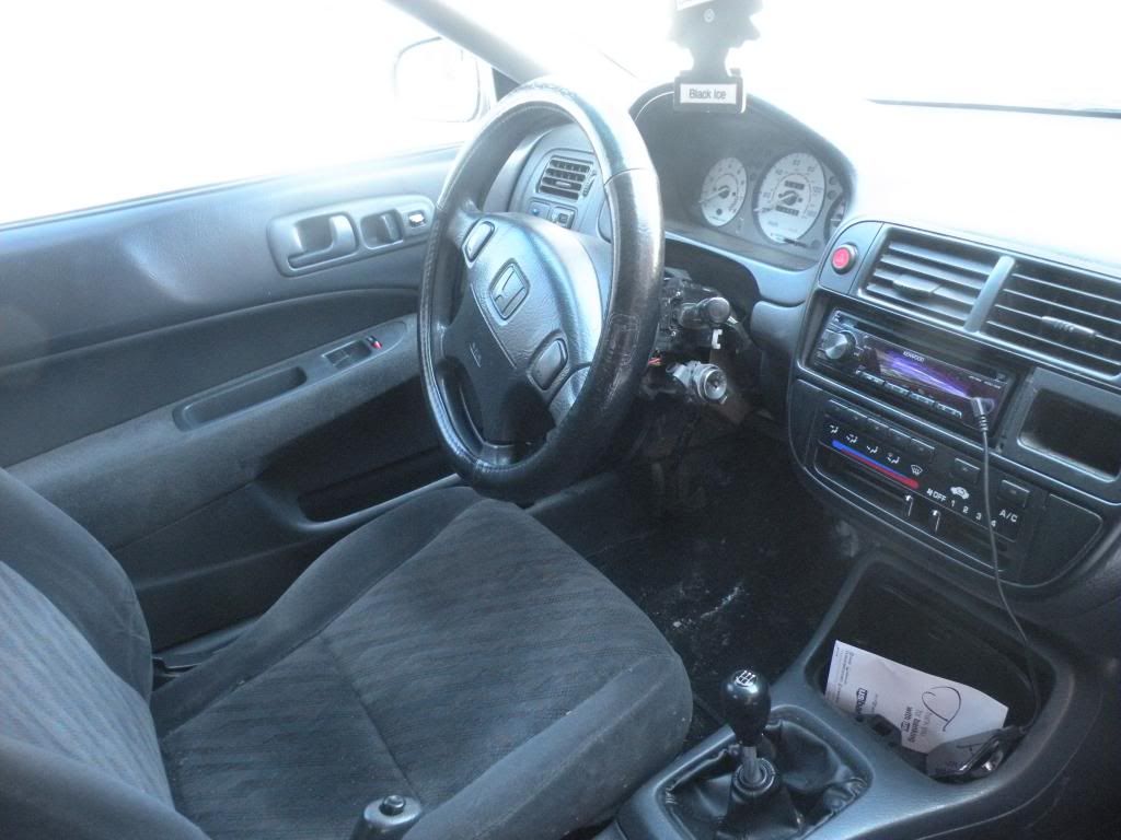

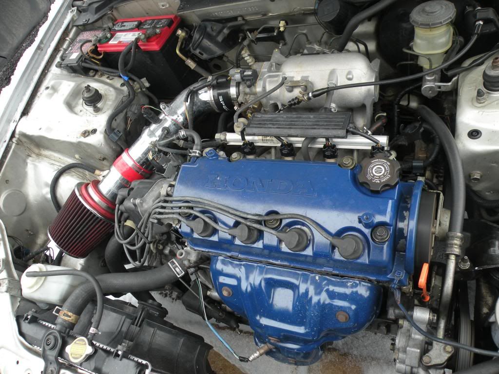

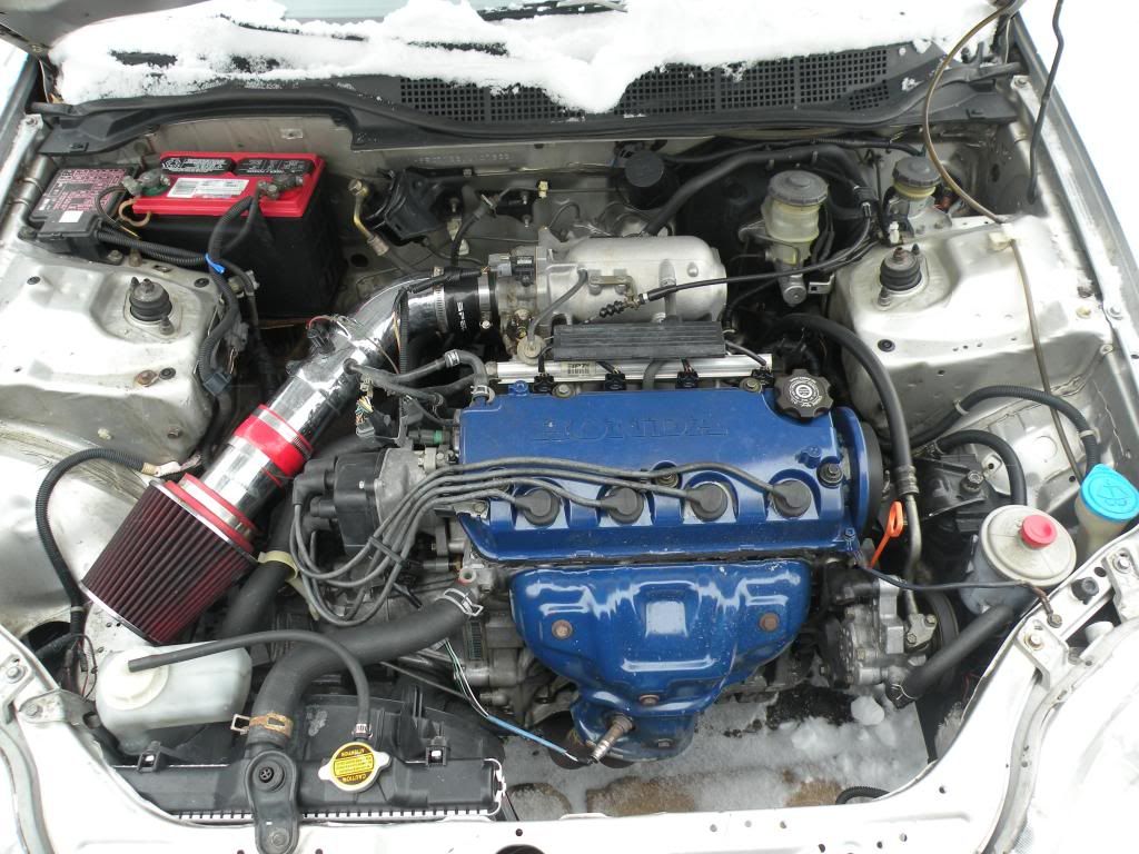

Hi guys :) my first post woohoo!. I have been wanting to get into these forums for a bit now but been a bit busy. My plans for this ride is certainly going to be turbo. I was told to send the block out to get cast iron sleeves if I really wanted to boost the shit out of it ha ha. Few pics I will post right now. Interior, Exterior, and motor. That way I am not being a tease..no one likes a tease. Don't mind the body or the gay ass drift sticker on the sides from the owner that obviously didn't realize that it's not a fucking FR. If you can look past that you will realize the new owner knows better. Even though the other owner knew how to swap a motor like a champ cause it runs great. So any advice is most appreciated guys. What would you do with it if it were your own car?

if your going to boost it there is no need for sleeves unless going for more than 400hp, i would just get forged rods and pistons and call it good. i boosted my hx and i am making 166hp and 149 tq on the d16y5 block

Sounds like you already know the best solution to the headlight issue. But to answer your original question: I would start piecing together the turbo kit affordably. and don't give in and waste money on headers since you will be getting rid of them anyways when you boost also don't waste money on exhaust your best bet is have exhaust shop make it custom for your car and downpipe when you turbo. A/c is already out so the turbo options are endless just remember you don't want one too big for your application. Boost lag blows. Read up on some forced induction tutorials and grasp the concept fully before buying anything at all because your plans could change. and to answer question two. contact Greg at Go-Autoworks they have some pretty affordable rod and piston kits. And no need for the sleeves till way down the road unless you got the extra cash when your building it the first time. GL
