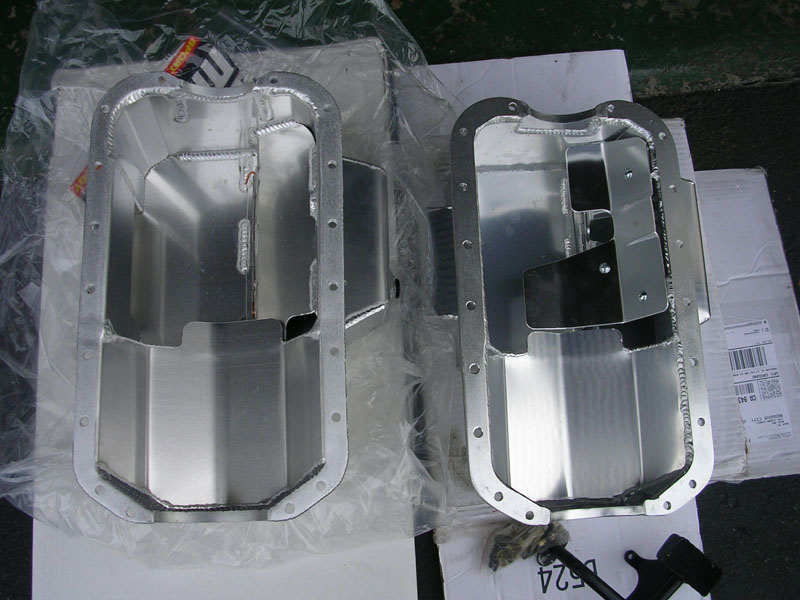

Wondering if anyone knows about these Moroso or OBX oil pans having problems for road racing or auto-x with oil starvation? Someone mentioned it to me but haven't been able to confirm or deny this issue. It was mentioned that the baffling system for the Moroso or OBX pans are only for front to back and from these pics it looks like that is the case. Has anyone welded another baffle into their pan to correct this? I'm working on my turbo project for road racing and Auto-x.
Here's both of the pans.
Thanks!

OEM pans dont have oil baffling, and I have never seen a case of track duty grenading a motor, short of being a Outlaw or Sporint car. The issue that's presented was some guy thinking outloud... thats all. Larger pan = good!

Stock d-series pans are baffled. In fact, the Mugen B-Series pans have very similar baffling to that of a stock D...
