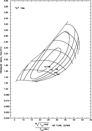

break out a calculator and start running some numbers. just from ^^ I would say you don't have enough engine to keep it happy
How To Read A Compressor Map - Turbo Magazine

Ok. Don’t know how to read compressor maps but thanks for the reply.
follow the link and do some math.
you can write it out here and someone who isn't dyslexic can proof read it for you and help you out.

I struggle top read turbo maps. Seems like a learning curve Im never drunk enough to understand lol
Hoever, since it says 2.5L engines+ , its going to be very laggy until near redline.
Compression and reduced cam overlap can onyl accomadate so much.
Have you looked into some of the oem saab/audi/subaruy turbo's? Some of the aftermarket repalcements are fairly cheap, and with some extra compression and dial;ing in your camshaft profile, you can get to spinning pretty damn good.
