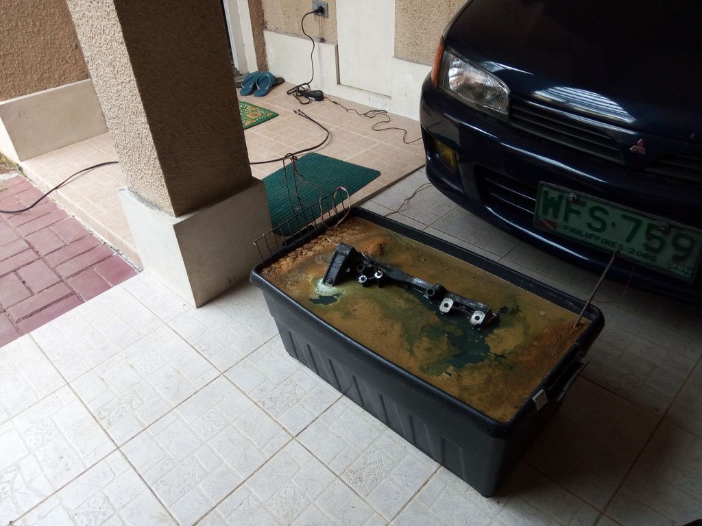

I have a spare block with rusts in its cylinder, decided to perform electrolysis
(the block is fully submerged)

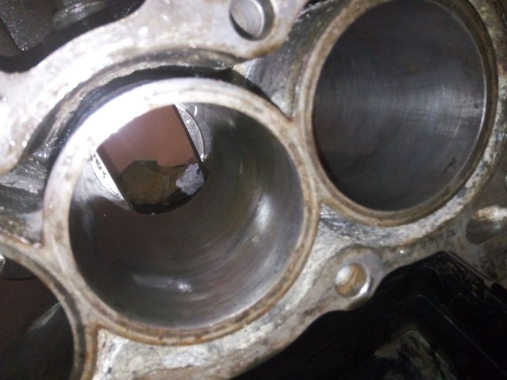

The result in cylinders is good, removing all of the rusts

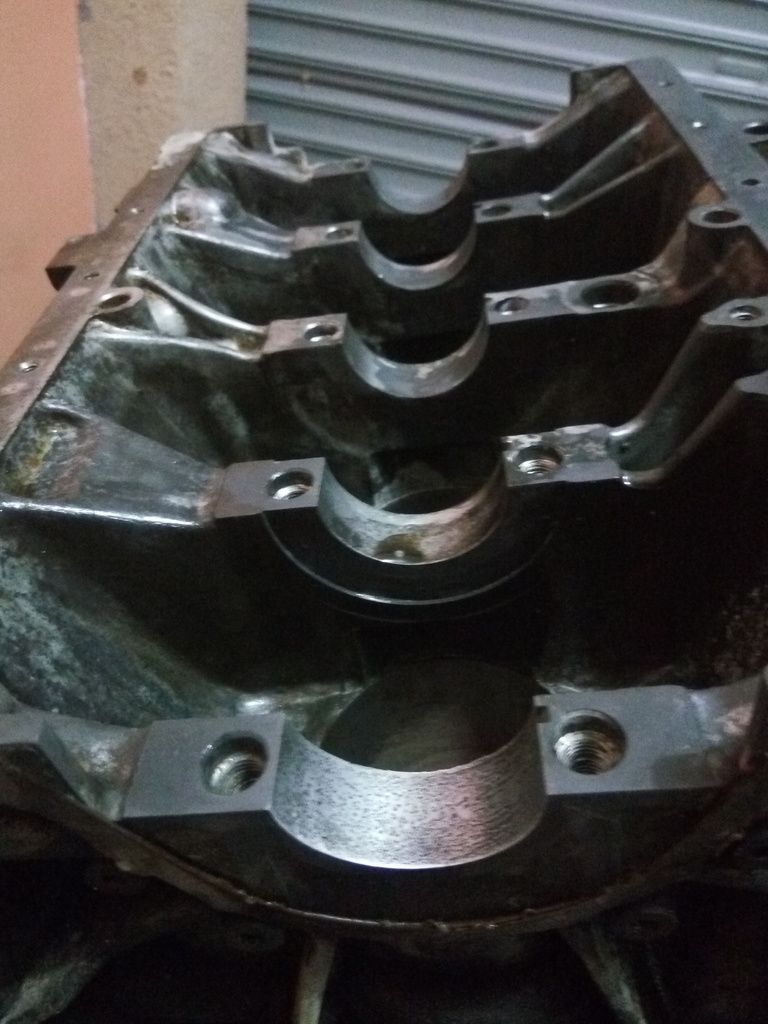

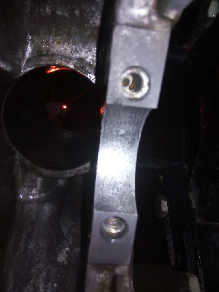

The problem is the main bearing caps, i dunno what happened to this
Left some dings, and discoloration, the surface is definitely not as smooth as before
The question is, can i use this block with that kind of main bearing cap? Is the surface that important? Ill be using fresh new bearings on it.

well that supports your "new fresh bearings"
You need to torque the main caps down and check the line bore
