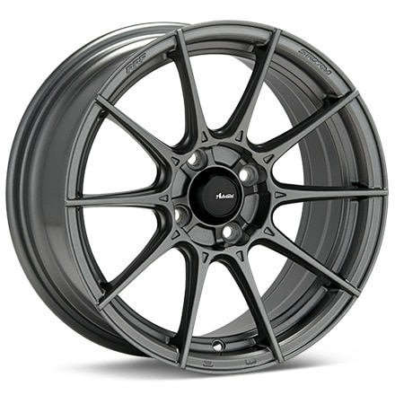

So I kept digging around and came across the Advanti DST Storm S1. (I want a 15x8 and Tire Rack will not suggest the 15x8 Advanti for a CRX because of it's offset so you'll have to look at NA Miata wheels for this.) The casting method isn't as good as the RPF1s but it is still a flow formed wheel and what makes it very tempting is the fact that you can get them for $138 a piece, and they're lighter than the Enkies by .3 pounds. Cool!
Advanti DST Storm S1 Matte Grey

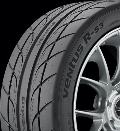

The reason I want 15x8 is 15s offer a wide range of tires and I think 8 inches is going to allow for plenty of meat while still keeping costs down. Good luck finding street tires for a 15 inch wheel that are wider than 225. Beyond that its all slicks. I'm trying to find a tire with a 200 UTQG rating for maximum grip and decent-ish longevity. So what I was able to come up with is the Hankook Ventus R-S3 at $118 per tire. Unfortunately the Bridgestone Potenza RE-71R is not available in the size I want but that's okay because we all know their "200 UTQG" rating is really more like 140. Who you foolin, Bridgestone? Of course that is the dominant "street" tire right now in autocross but those tires sure do seem to wear faster than the other 200 UTQG tires around.
Hankook*Ventus R-S3 (Version 2)

All very good points everybody, but I think there's one thing that's being overlooked; weight. I challenge you all to find a wheel that is a 15x8, is under $200 per wheel, is flow formed, and weighs less than 11.1 lbs. Yes there are a lot of "lightweight" options but I can't find a wheel that fits those numbers that is lighter. Hell, I can't even find a wheel that is 15x8 that is lighter. I wouldn't be worried about that wheel cracking as much as I would be worried about a Konsei wheel cracking. Most Konsei wheels I've seen advertise only a gravity cast and nothing else. Googling "Konsei K1 Review" yields some suspect result on that company too. Go ahead and visit their website and try to reach their "Technology" section...
Yes performance is at the top of my priority list for tire options and the 15x8 category does offer a lot of wiggle room for tire choices which makes that size desirable. Good point about MAXXIS, Fodo. I totally forgot they just came out with a new tire. It's suppose to be a solid contender for the 200 UTQG category from what somebody was telling me. I'll check them out.
