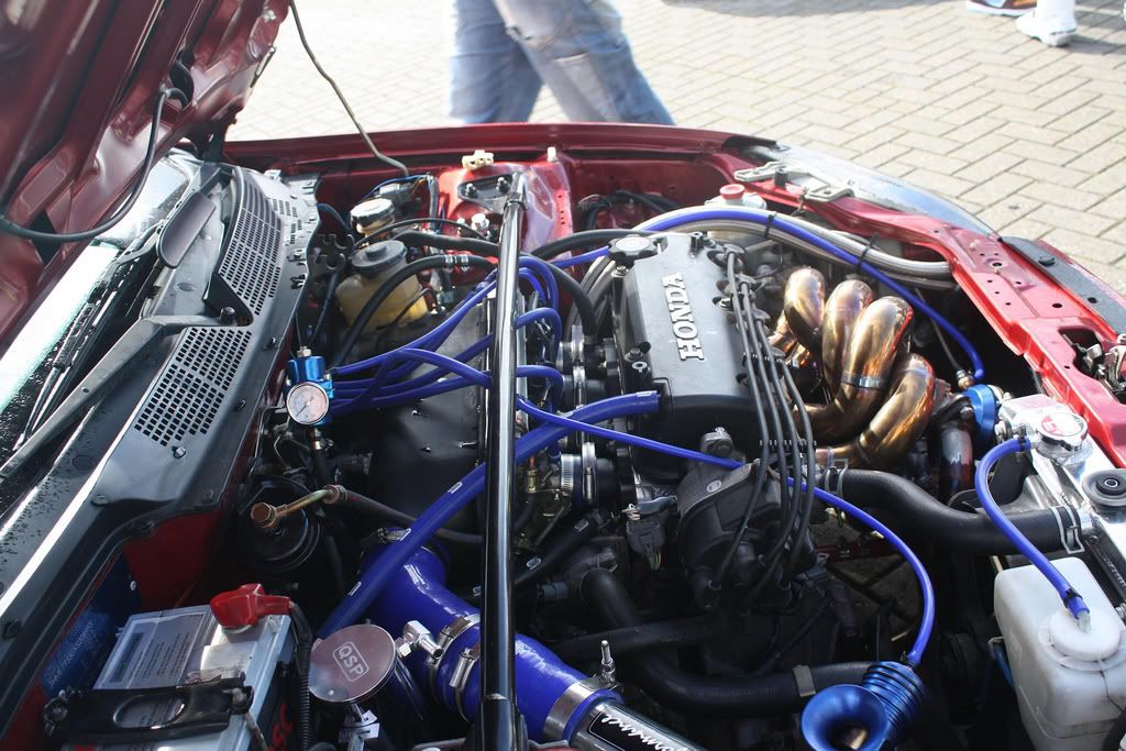

Found this on ek9.org
this was just a random one on google.
