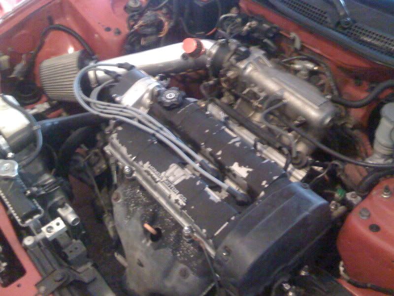

CAR IS DONE!!! I HAD TO GET IT STREET TUNED THOUGH :( WILL PROLLY UPDATE THIS THING W/ DYNO NUMBERS WHEN AVAIL
now on with some pics:

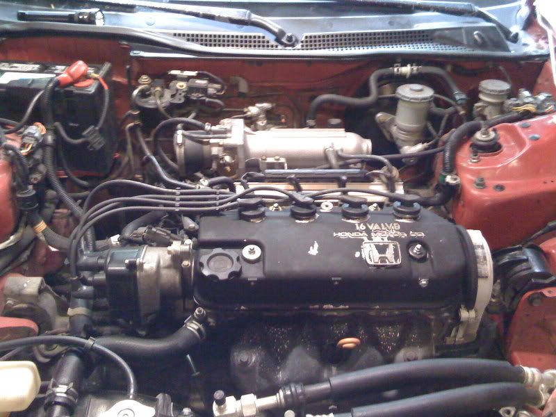

Before the ZC:
After the ZC:

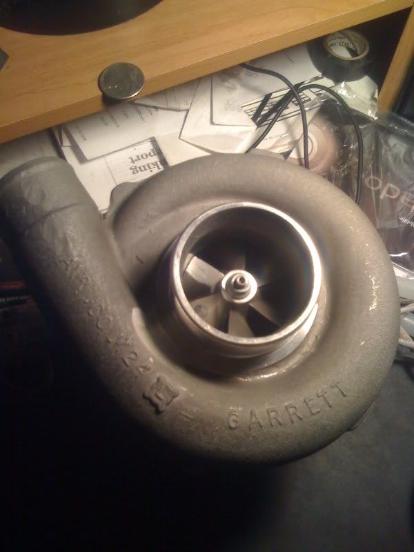

The Turbo:

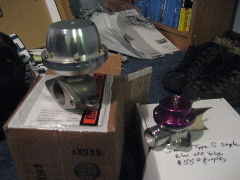

quick update, i picked up a wastegate with a 10psi spring and a bov and a greddy tt.

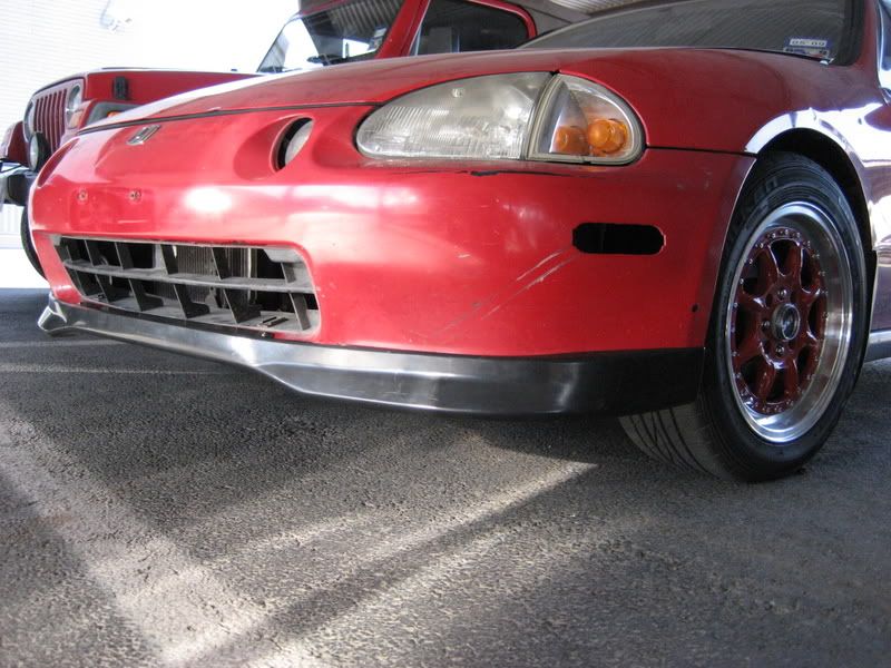

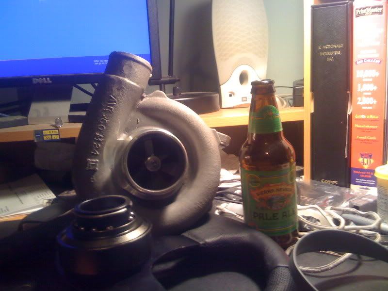

oh also i got a battery for my digi camera, so i can take better pics now (was using iphone.) here is an outside of the car with the turbo parts.
^^ ha that is after springs (eibach) the damn thing still looks like a monster truck :(
Mud Flaps and GT3s FTW
That turbo also looks like a Garrett 57 or 60-1. My T4 60-1 Compressor housing looks EXACTLY the same. Not anymore though ;)
yea it is a t4 intake side... I havent seen a 60-1 in person though, so im not sure how they compare...

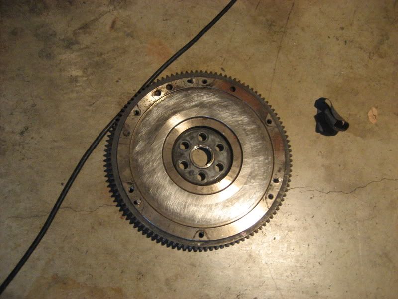

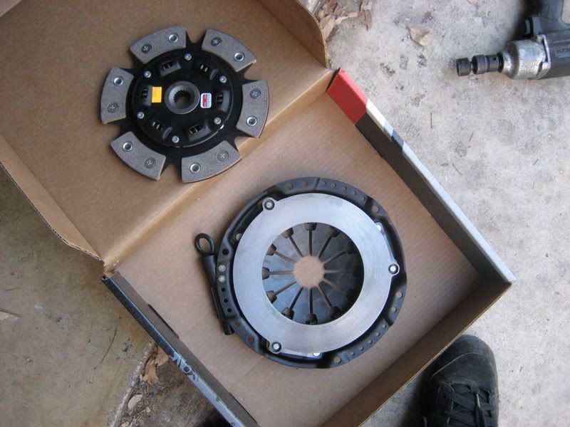

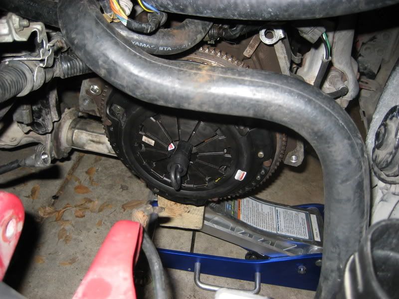

i attempted to put in my clutch yesterday... I got the tranny dropped:

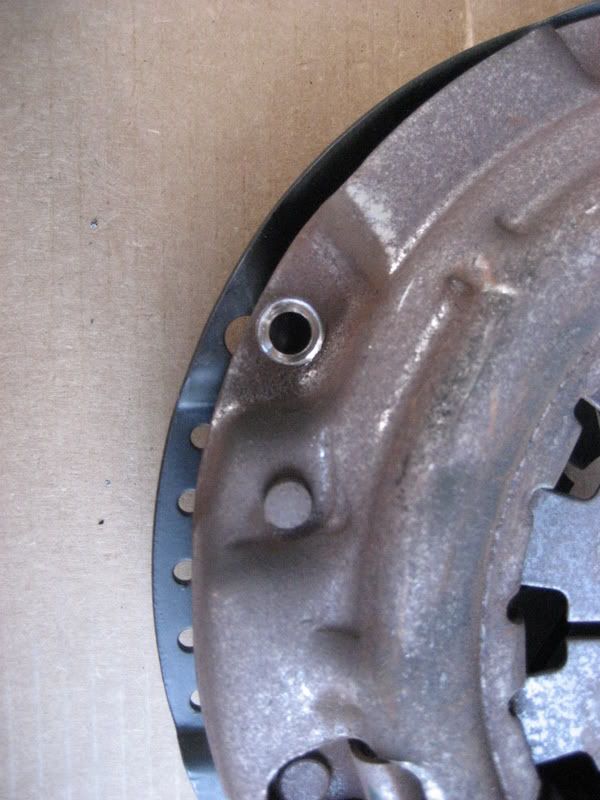

Then i got the old clutch off, attempted to put on the new one and realized that it didnt fit. the pressure plate was too big, as you can see here when i laid my old one on top of it:
So, i suppose i shall have to send off for a new one b4 i can finish up this part of the install....
BTW, anyone know if the b series clutch is a bit bigger? I am trying to figure out what clutch i actually received.
