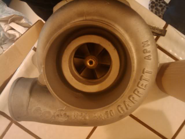

Here is a pic of one of the turbos I was going to use:
I decided not to use it. So I sold it.

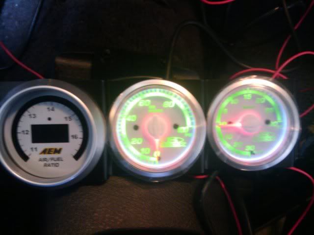

So yesterday I got the dashboard and stuff back in the car. I also hooked up the Go-Autoworks vacuum manifold, and installed the sending unit for my oil pressure gauge. Lots of other work done in the middle.
I snapped a pic of the gauges. This was during the test phase.
I'll snap more pics today.
nice gagues color :TU: me likey lol
Thanks :)
